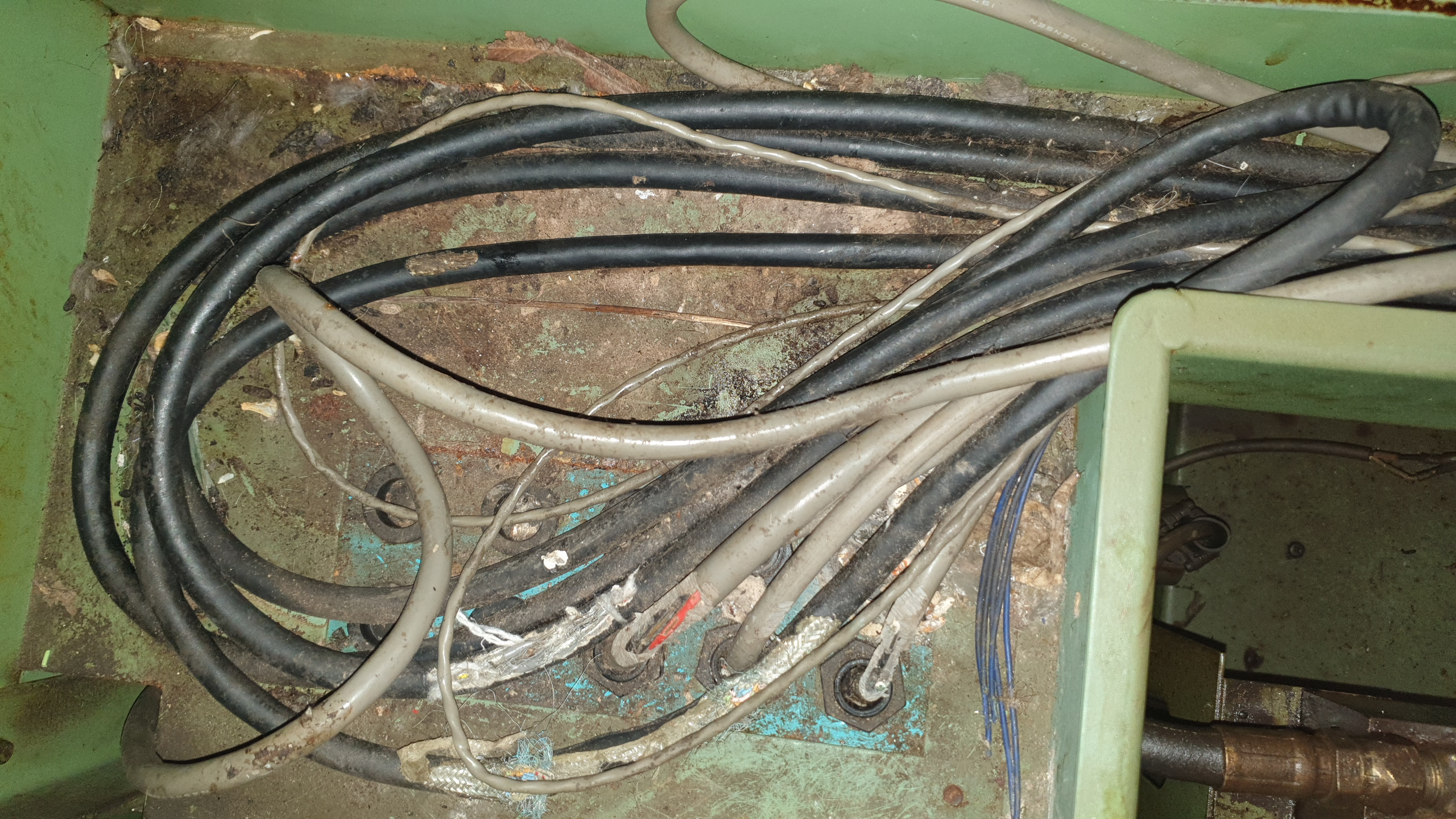

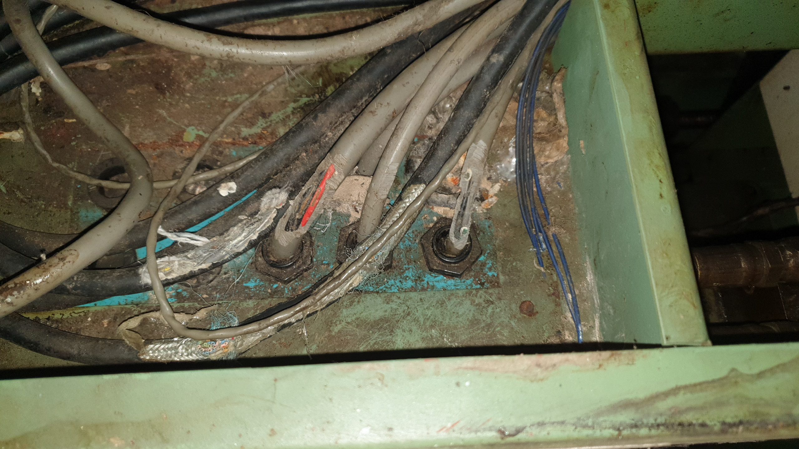

- Posts: 21997
- Thank you received: 7488
07 Apr 2022 22:32 #239606
Replied by tommylight on topic Mazak Micro Slant 15 Retrofit
- RotarySMP
- Posts: 1635
- Thank you received: 595
08 Apr 2022 11:10 #239649
by RotarySMP
Replied by RotarySMP on topic Mazak Micro Slant 15 Retrofit
Good that you could localise the damage. At least now you know what you need to fix.
