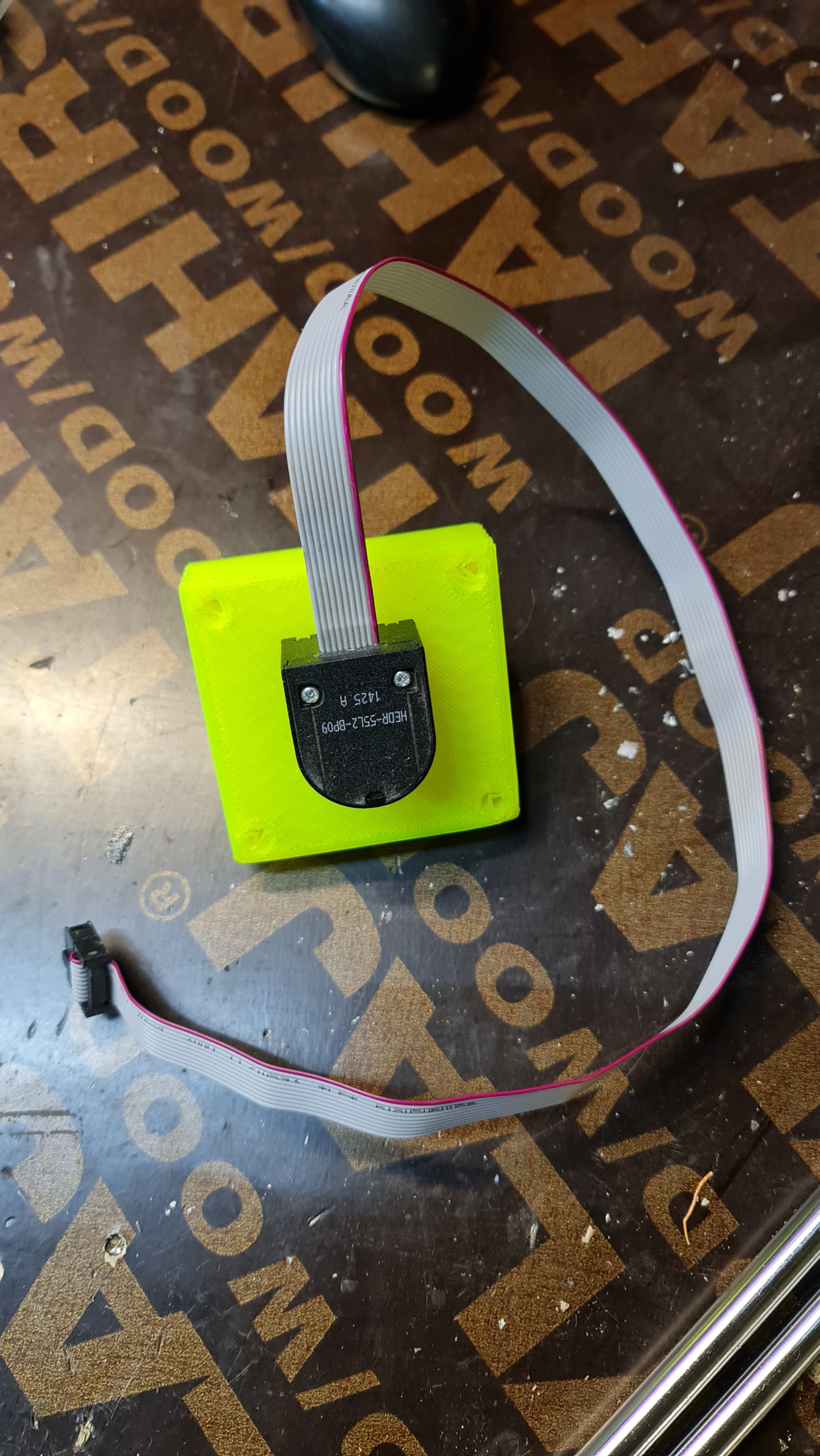

31 Oct 2022 02:35 #255536
by arvidb
Replied by arvidb on topic Mazak Micro Slant 15 Retrofit
If you want to keep the connector, maybe solder the shielded cable's leads to a piece of PCB, make room on the PCB for a clamp to hold the cable and its shield securely to the PCB, as well as for mounting holes. And of course a pin header to connect to the sensor.

31 Oct 2022 08:39 - 31 Oct 2022 08:40 #255551
by smc.collins
Replied by smc.collins on topic Mazak Micro Slant 15 Retrofit
remove the ribbon cable, go directly to the board,i hate those things, especially in a vibration heavy environment.
amp connectors are available in crazy types it's probably a standard pcd connection or hole spacing

31 Oct 2022 13:00 #255566
Replied by andypugh on topic Mazak Micro Slant 15 Retrofit
I would design a little PCB to adapt to a convenient connector that suits the cable. (and also move that IDC connector much closer to the encoder)
Small PCBs are almost free from China.
Here is an example, this one converts bare wires to a particular connector, and also incorporates a line-driver IC to convert to differential signals to suit an STMBL:
photos.app.goo.gl/qGWNgqj7DhRCNGCf7
Or RJ45 to Phoenix, for Mesa smart-serial connnections:
photos.app.goo.gl/yN9BftrALH1WQkHR6

31 Oct 2022 13:06 #255569
Replied by tommylight on topic Mazak Micro Slant 15 Retrofit
Keeping the connector means keeping half a metter of unshielded cable, roled above a big brushed motor, acting like an inductor and collecting interference.
I do have some RS232 connectors i can use, nothing better.
I also have some new industrial connectors but all are 3 pin ones.
Some diving through the shop today, apparently!

14 Nov 2022 10:36 #256676
I have the connectors wired and soldered, need to mount them on the machine and wire to Mesa 7i77, but i am busy retrofitting 2 of old Messer plasma cutters, just removing old wiring is a one week job!
