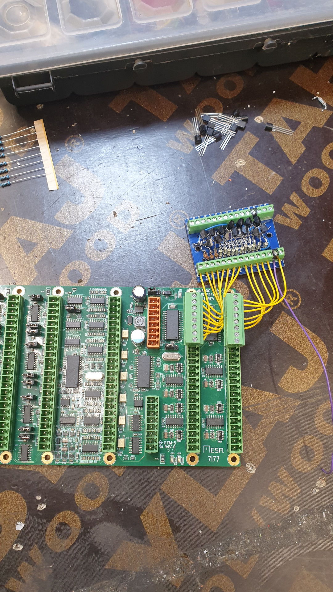

This is my latest "masterpiece", 14 of 2N2222 transistors with 14 of 2.7KOhm resistors stuck on an arduino nano break out board to invert the outputs from Mesa 7i77 and 7i84. Took 2 afternoons, mostly scavenging resistors, luckily i had over 40 transistors and 4 of those arduino boards.
Now to make another one and hope and pray i do not need any more of those.
Getting old, glasses are mandatory, but still not as before, damn it i had perfect eyesight!
Just in case, check what manufacturer made those 2N2222 as i had to desolder everything once, OnSemi manual has the wrong pinouts for my version!

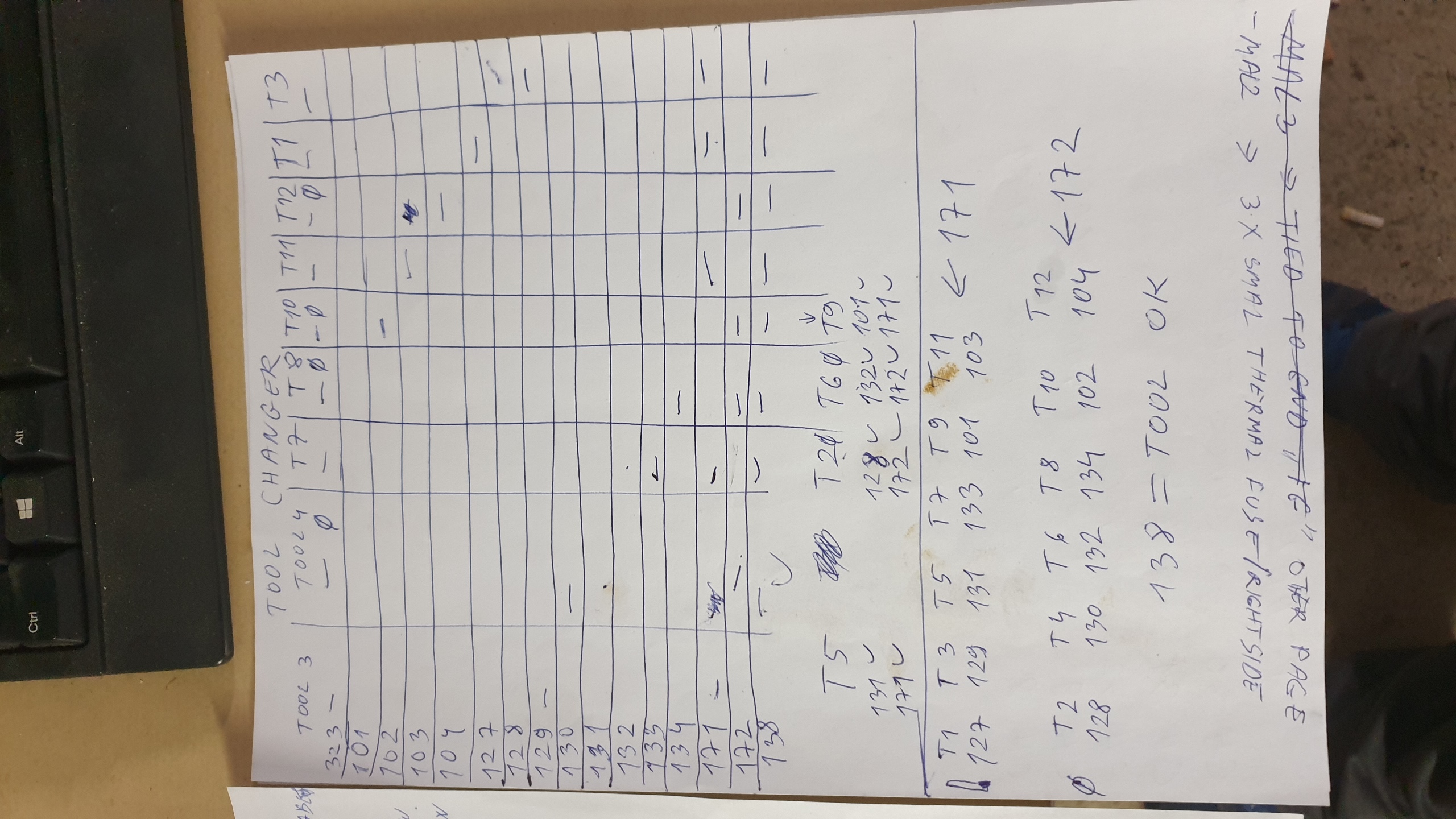

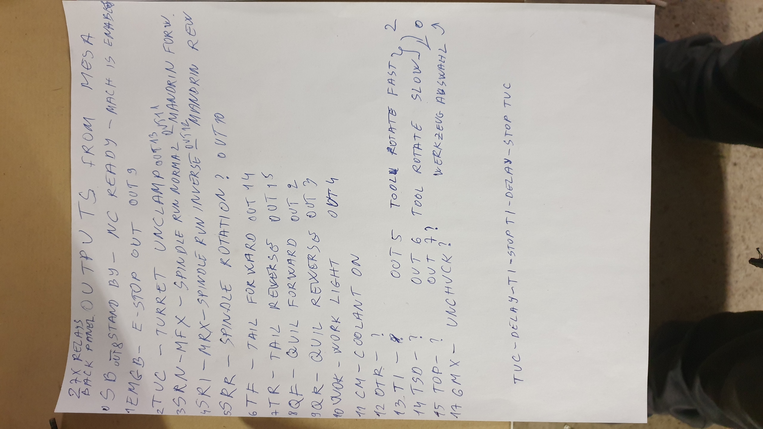

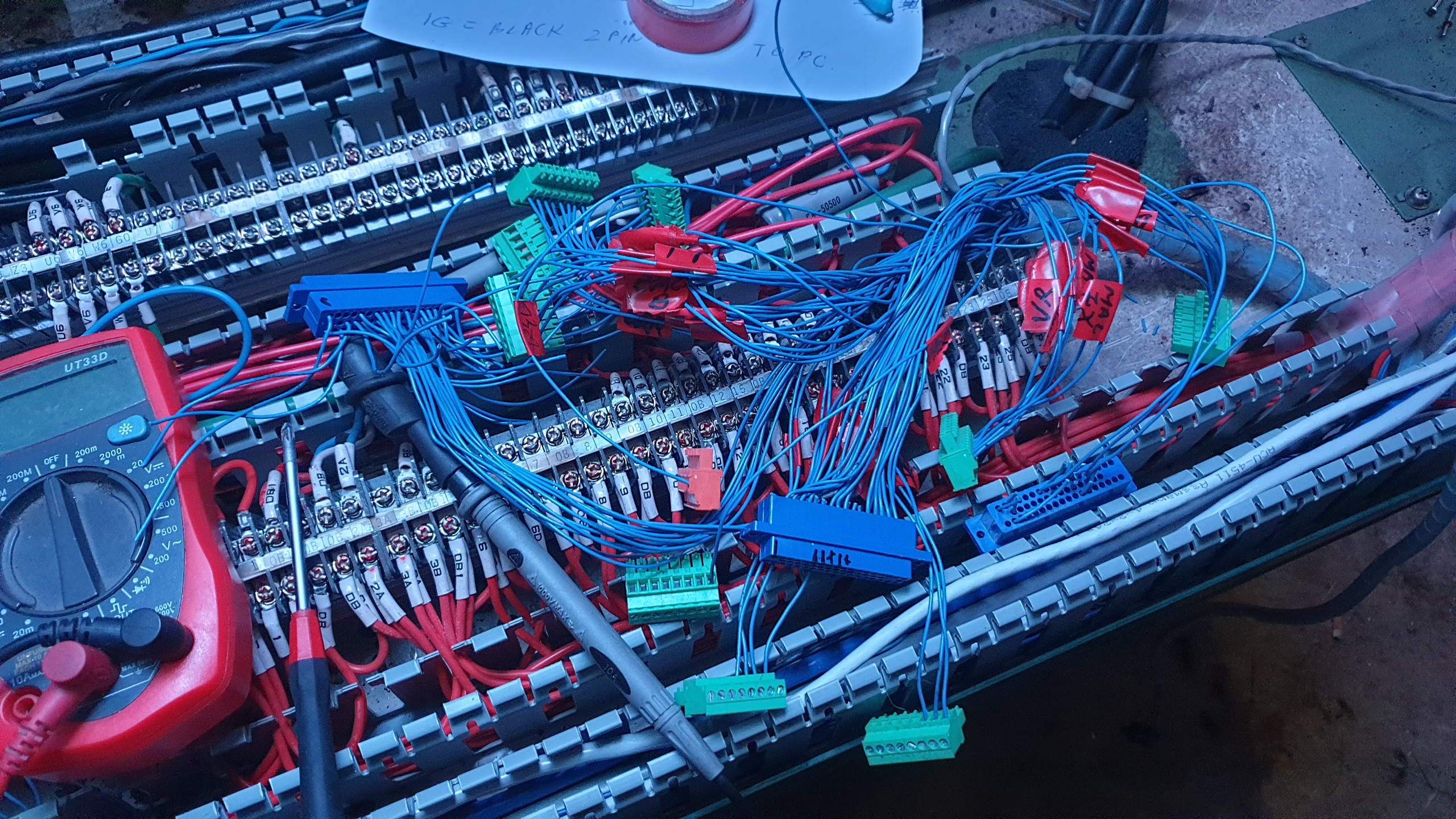

Does anyone know what cables labeled 53, 364, 55,.... do???
I did figure out the first two, there are at least 60 more with just numbers going all over the machine, almost all of those in enclosed spaces without easy access:)
Got the limits, Z index, spindle everything, the back panel relays ~40 (still have 3 or 4 not accounted for), safety relays, circuit breakers, hydraulic pump and pressure, lube pump pressure, pedals, work lights, tail and its pinion, material forward, chuck close and release, operator panel is fully wired and set in hal and VCP just need two more wires for the hard e-stop, but i have plenty of cables already, etc.
Most of those are still not tested as i have no clue how the hydraulic toolchanger works, what sensors does it use, where are those sensor pins, etc etc

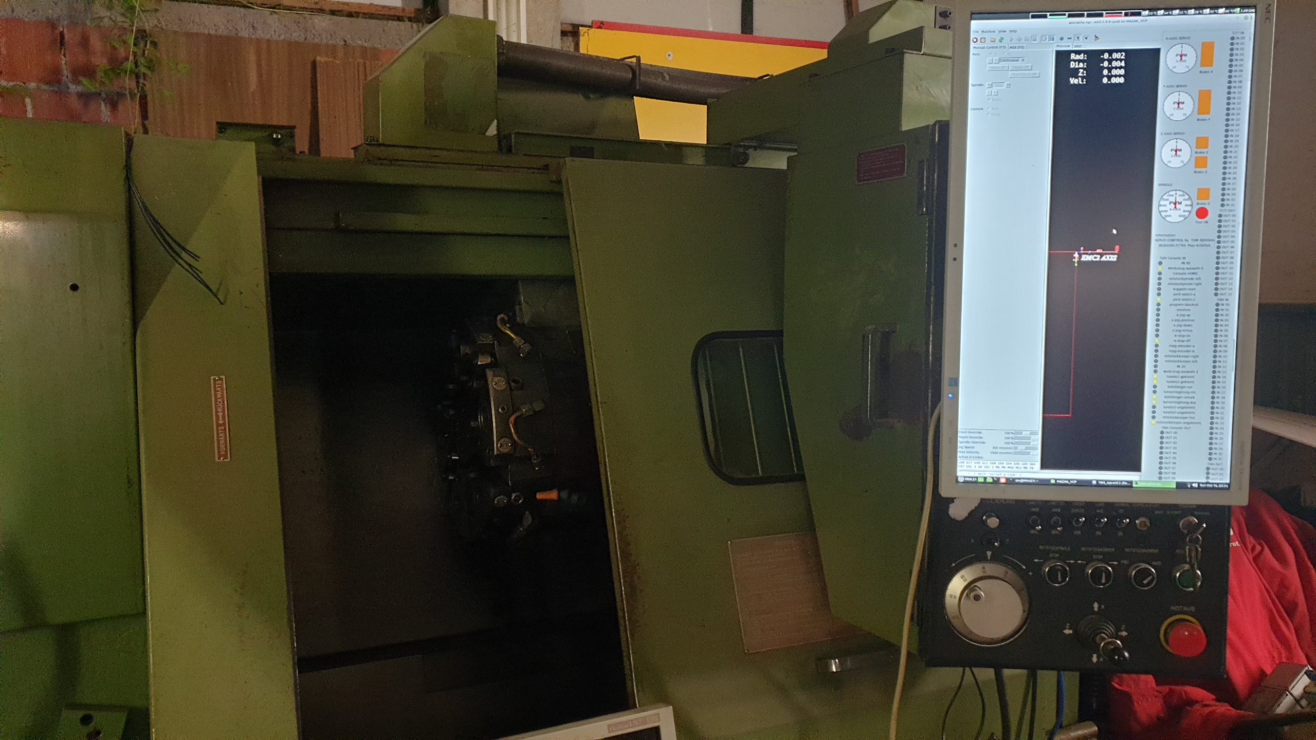

17 Oct 2022 21:23 #254368
Replied by tommylight on topic Mazak Micro Slant 15 Retrofit
Lets see....
Spindle fully working under LinuxCNC control, check.
Tool changer figured out from turret unclamping and two different speeds of spinning the tools, to all the pinouts for all 12 tools and when the turret is clamped properly! YAYYYYYYY
Also has two separate pins, 171 normal tools and 172 for round tools, besides 12 pins for each tool, so that makes 15 inputs on the mesa just for the tool changer, thinking of it i did not check for index pin! Damn it, more spaghetti chase!
Then again, i am pretty sure it works without it...
So now i have to do some hal stuff, like on the console there is a switch to change the turret rotation speed and based on that energize one of the two relays, and a push button named "revolver" (how neat) so when that button is pressed, something like this has to happen:
-Unclamp turret>wait a bit>spin turret depending on speed selector>wait for button to be released>wait for turret to get to a known position>stop spinning>wait>clamp
That is as simple as i can get it for the manual change, pretty much the same procedure has to be done for automatic changes.
And for good measure, see if you can figure anything from my scramblings:
