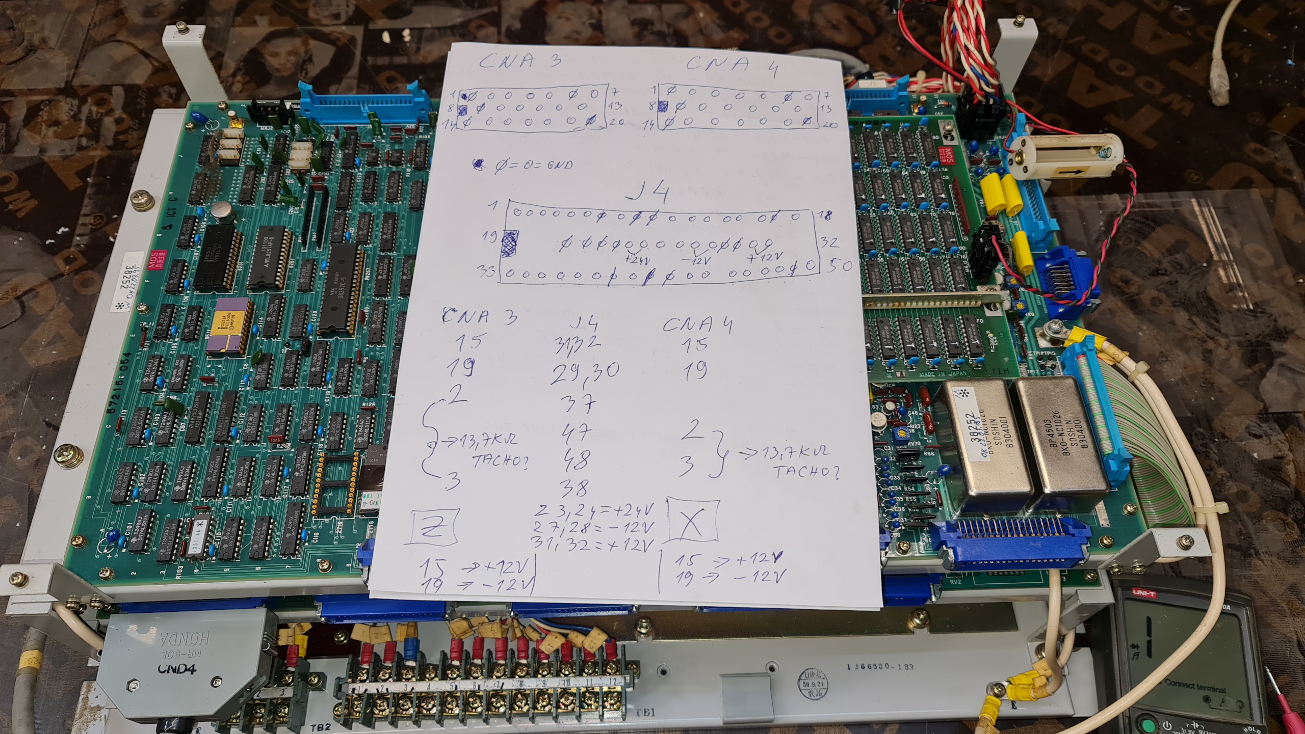

I think the motors are 1.5KW DC servos, the spindle is 11KW for 100% duty cycle and 17KW for short periods, 3450 RPM, also DC.
Not using resolvers, nothing i can find works with those, they are some type of reversed resolvers, so i am replacing them with 2500PPR encoders i had new. Had to make some 3D printed mounts with bearings for the encoders, and now i have to mount those and wire them, not easy as the existing cables go through very thick shielding with soldered connector on one side....
Much easier to add new cables and leave the old ones dangling in the breeze !
Those are nice machines, to bad you had to let those go.
Then again, i may have to let this one go, very soon. Or i can drag the retrofit ...

Did some more reverse engineering yesterday, so not much left to figure for the axis drives, although one might be dead as i wrote here last time i turned it on about a year ago (first mice attack that i was not aware off) it did show that on screen, but when i programed in the parameters (not fun at all) at one point in time it did not show any errors, hence i would like to have a go at burning them...hmm .. testing them!
Some more hieroglyphs attached ...
