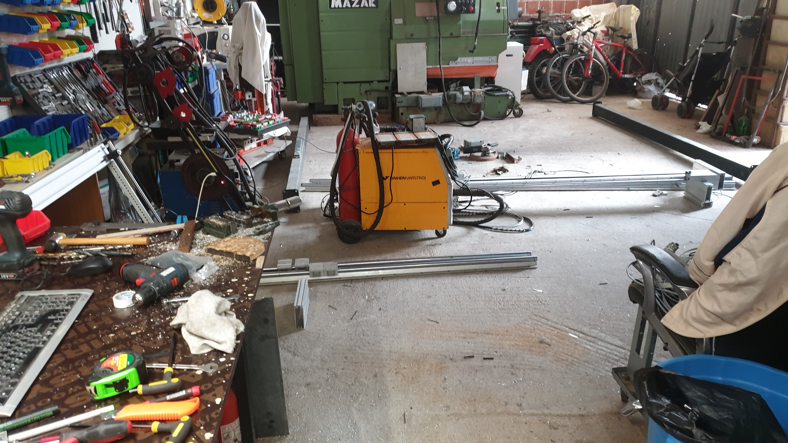

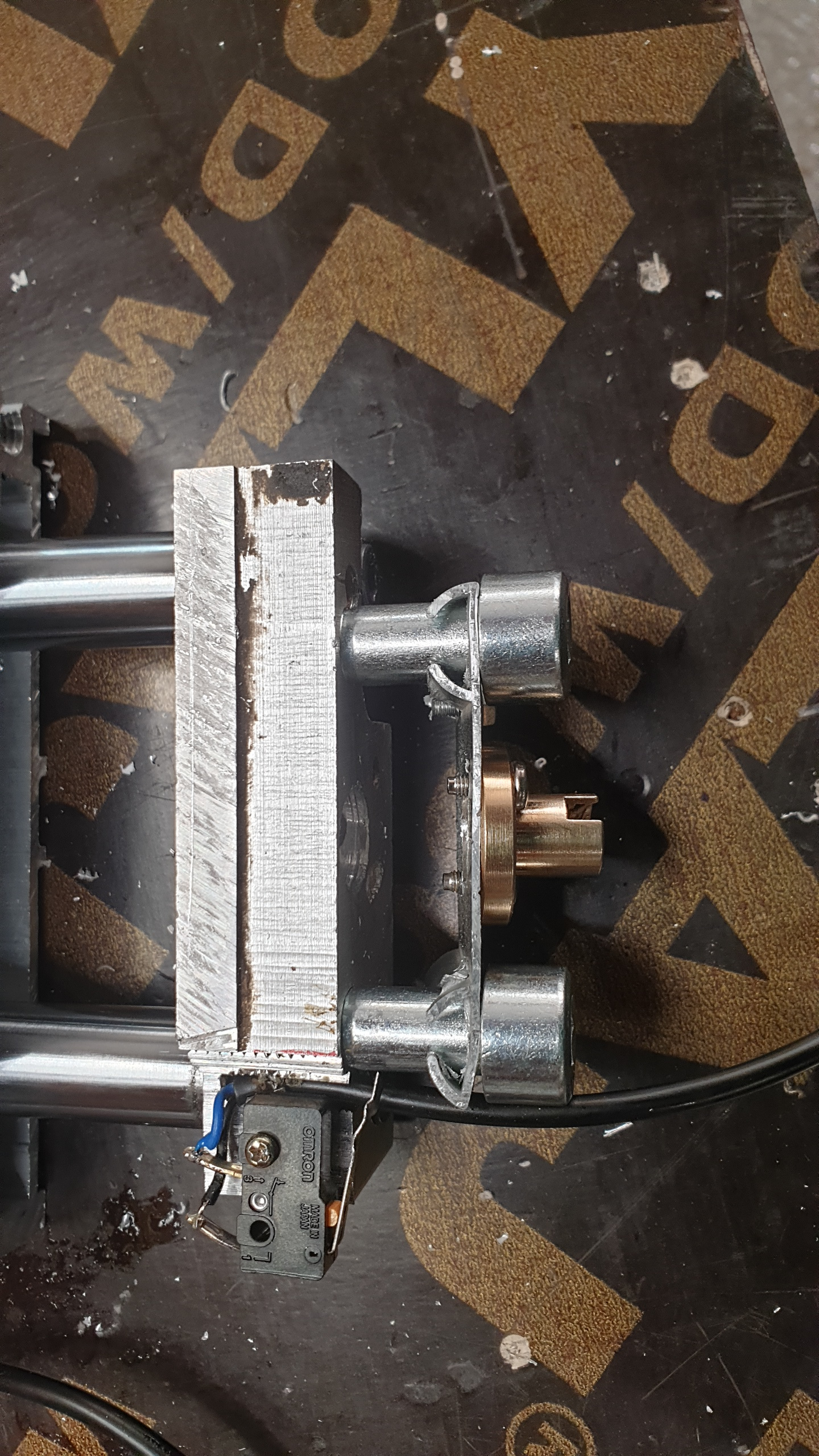

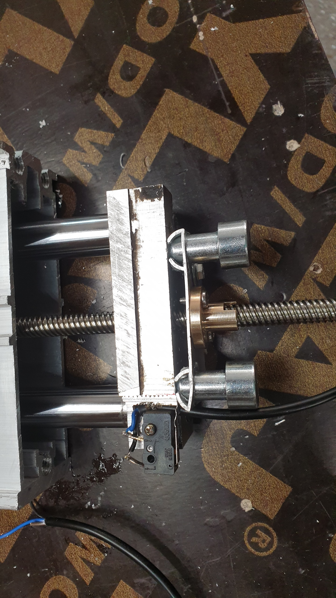

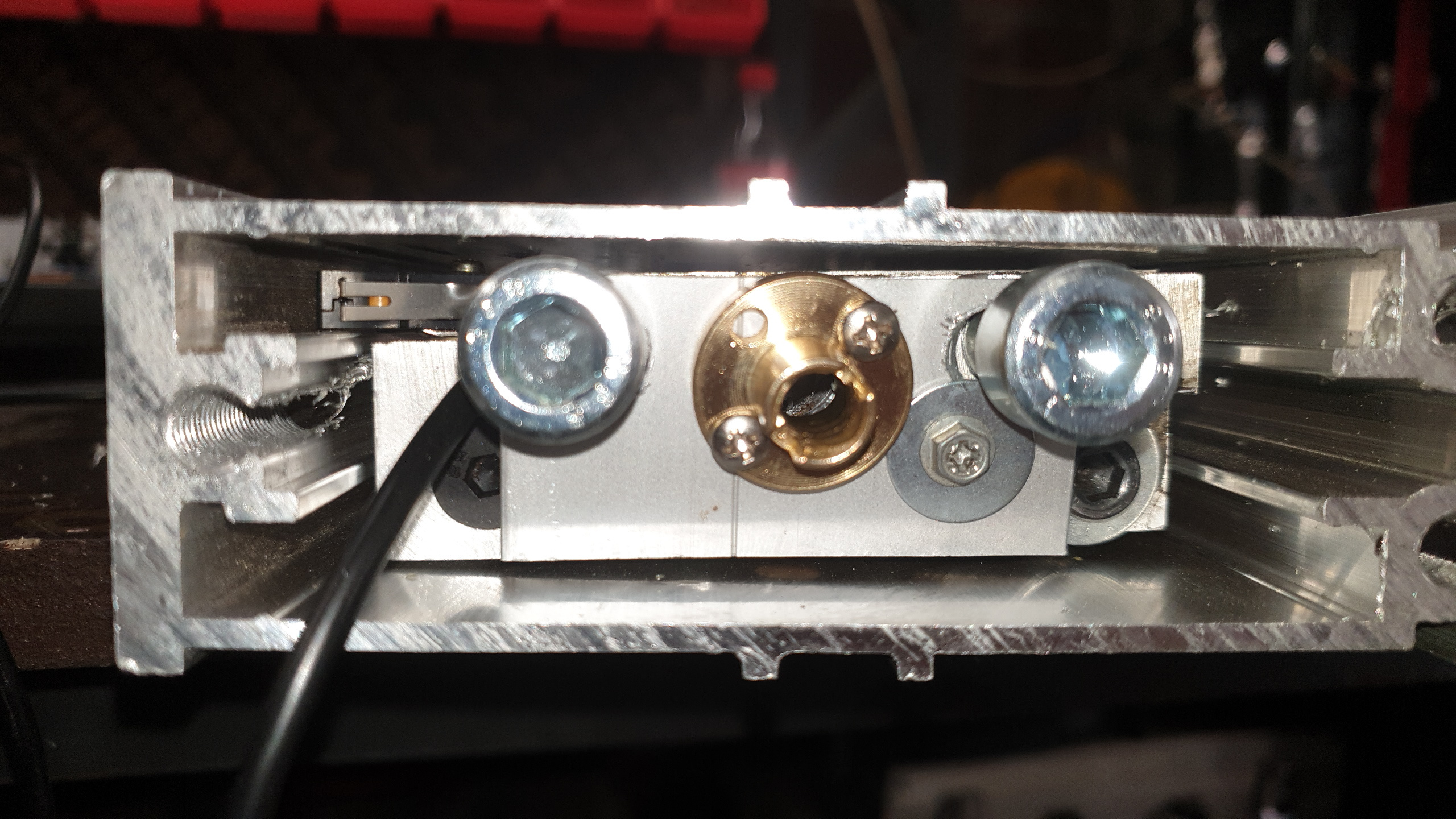

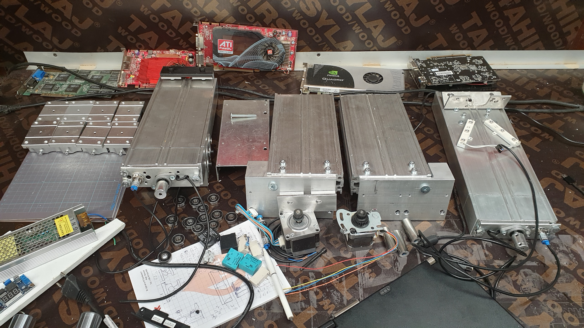

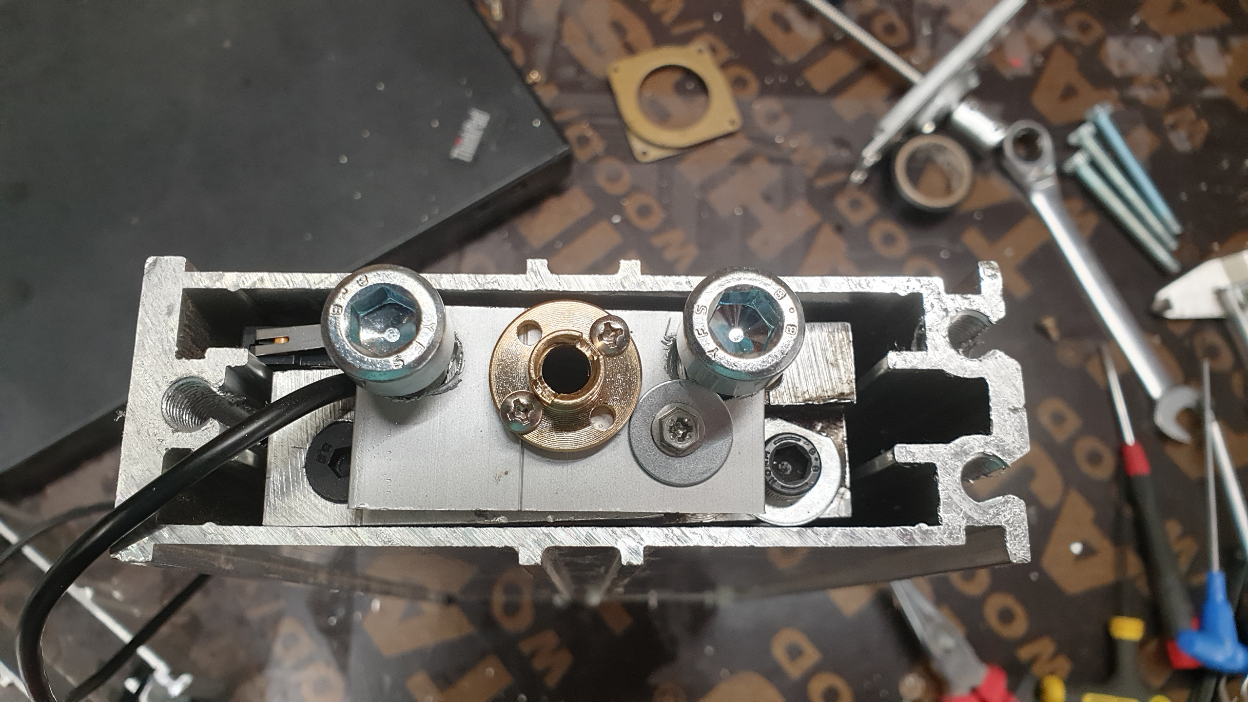

Here are some close ups of the Z axis inner workings to get a better idea of how things work together as there are two sets of moving parts on a floating head. Do not mind the dirty alu part, this one is for me personally so i just need to build another smaller machine to attach this to !
From above, the space is very narrow so takes a lot of time to adjust everything in place:
Same thing but inside where it belongs, notice the tight space:
Side view of that assembly, floating part moved out, or up when it is in place on the machine:
Same view with the floating part pressing on the micro switch, or material found when in use:
Same pictures as the last two but this time with the screw inserted:, bottom position, switch triggered:
Up position, switch released:
And here are two finished Z axis and two uprights for the smaller machine:
Here is how my work shop looks today:
Both machine metal parts are gone to get a new paint job, so i have 2 days to mess around with smaller stuff, or start another machine.....
