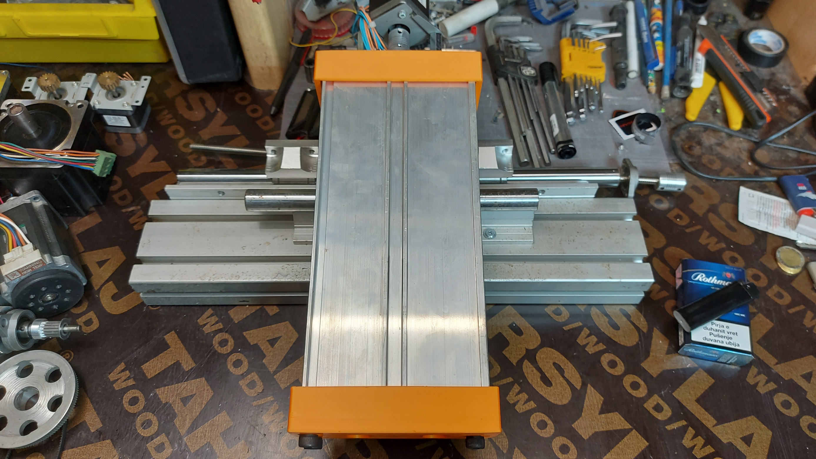

Question, how much would you pay for one of those Z axis, fully assembled and how much for a kit without motor ?
Or how much would you sell one if you build it ?

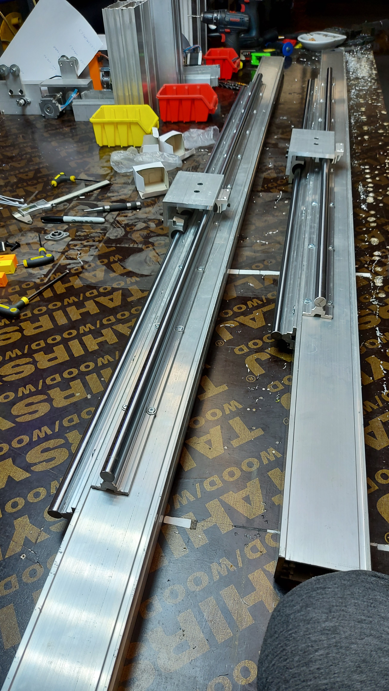

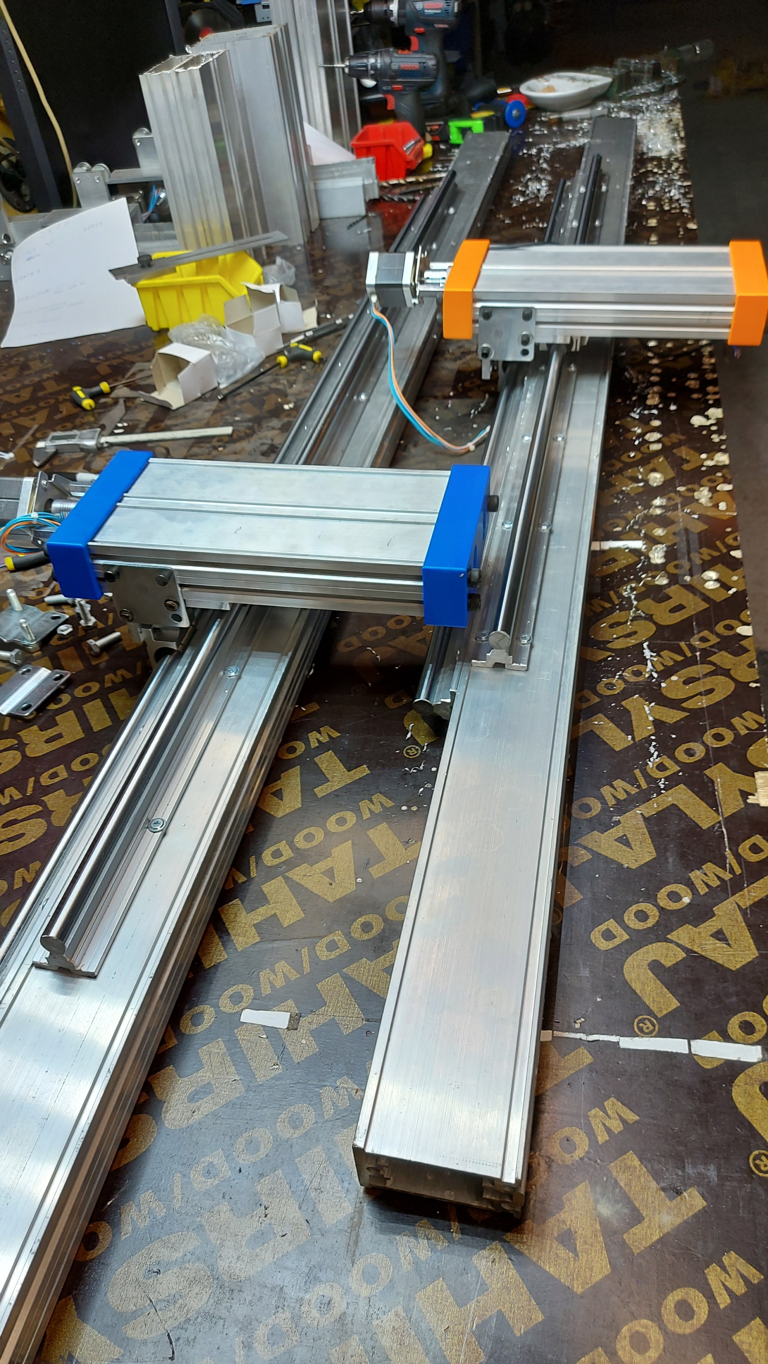

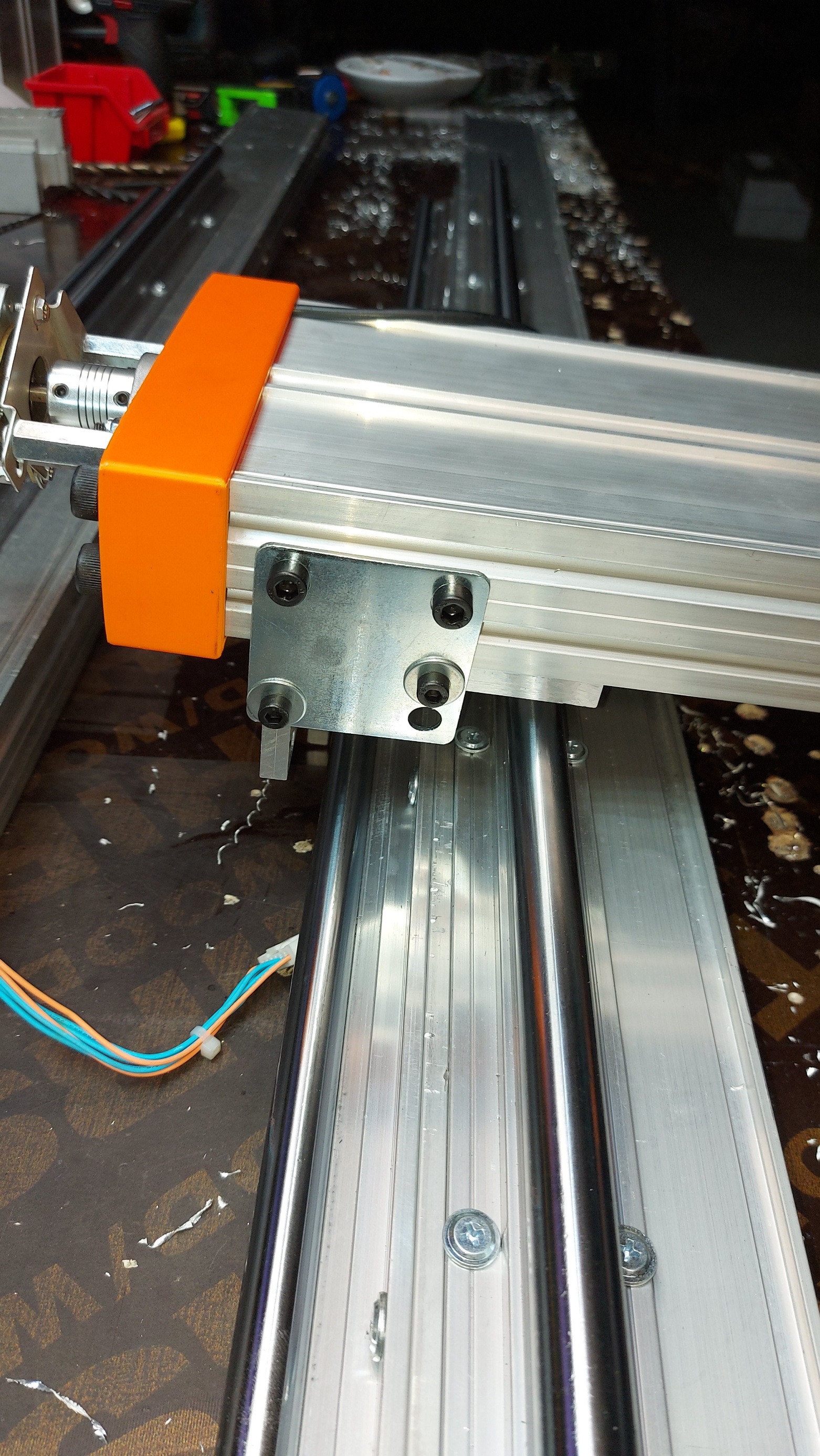

Doing some test fittings and "research" !
This is supposed to be the axis the moves perpendicular to square tube, so have to think how to also make/attach the swivel and tilting parts to it as i am aiming for full 5 axis. Gona be interesting how this ends up.
This is 3.15M long aluminium gantry with a single HiWin HGR25 since i had one rusting away and seing as i do not have any more of SBR16, only enough for 2 machines. Planing to mount this on the 1.4M long 150x150x4 used for Y axis ending up in 1.2X2.4M cut area, and the best thing is next time i get 6M SBR25 = make 2 of Y axis at full 6M and bolt this gantry to it making it 5.8X2.4M. Strange dimensions, i know, but when life gives you lemons ....
Tom i would add up a total cost per unit for materials first then figure out exactly how much time you have in labor and decide what labor costs are per unit then add some extra in for the business as profit so the business can grow.
so if it cost $100 in material and takes 4 hours to produce and you pay yourself or someone else $25 per hour for a total labor cost of $100 the business should make $100 at least on top of this in a perfect world but China Pricing does not allow this if the market is saturated with like products.
you need the business to get a cut so you can grow and you have to be able to pay yourself or someone else to process the units. so this is a basic guide line i use to evaluate things. it's tough since China can sell a lot of stuff cheaper than i can even buy material for? but it does seem like the prices are going up on their goods lately. it makes you wonder how they can buy material and process it and ship it so far and make anything on it? the government probably has something to do with it all but who knows?

@MachineDude,
Dang you were close, it came out to exactly 110 Euro for parts only, and that high since i have to pay 5 E/piece for the KFL08 bearing, 5.5 E/P for LM12UU (4 of them), 29 E/P for china Nema 17 motor, 19 E/P for the lead screw with nut and coupling, etc ....
All this might change soon as yesterday found out some internal information's about the customs here, when ordering stuff from abroad as a private person they have total power to do whatever they see fit to get as much money as possible, but when ordering as a company they must stick to the legal 19% tax + 10% customs + some bureaucracy cr@p that can not go over 10%. I will have to test this promptly !

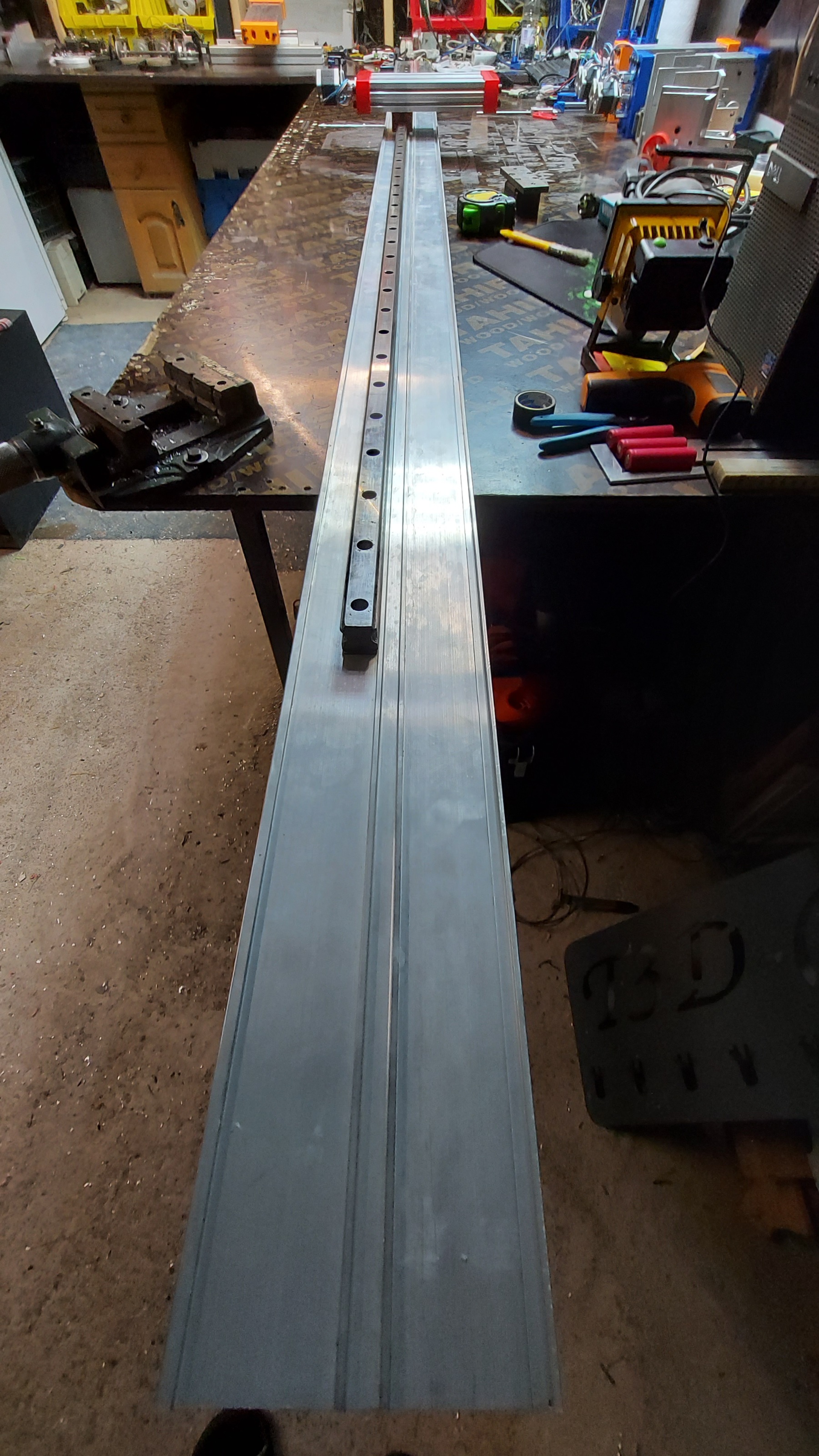

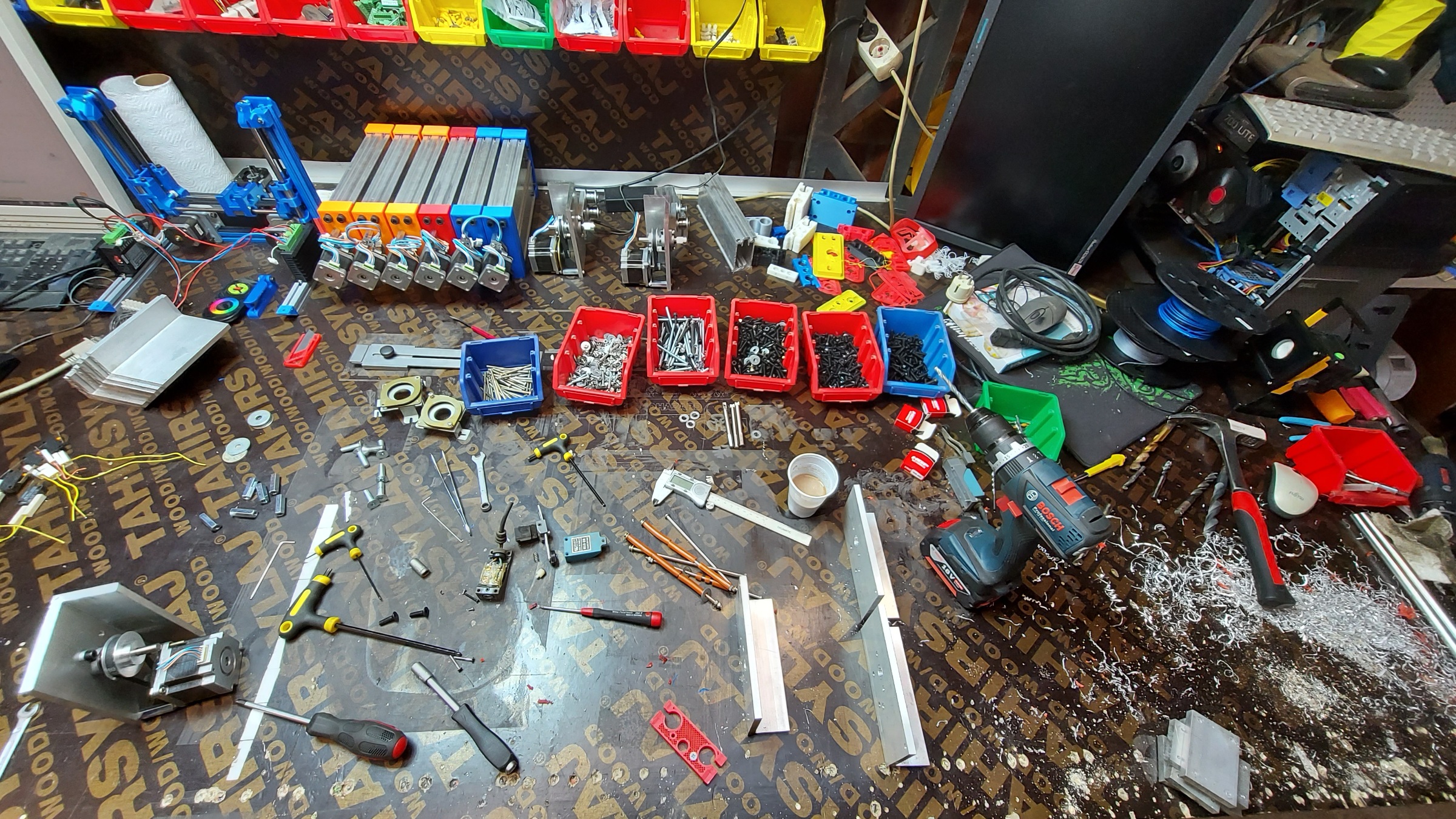

Replied by tommylight on topic 2+2+3 More Plasma builds, double the joy ! 3X2M and 2.5X1.5M cnc plasma build.
Gantries for 2 of the machines are nearly done, reductions, belts and Z axis monuts next.
Got news that legs for all 3 plate cutting ones are bent and painted black, waiting for the blue powder coat for the 150X150X4 Y axis. Not looking forward to all the holes and tapping that has to be done, but it has to be done.
Oh joy !
Need to start work on another two machines, mills, one for me for Alu and one for engraving text on Granite and marble.
More holes ....
