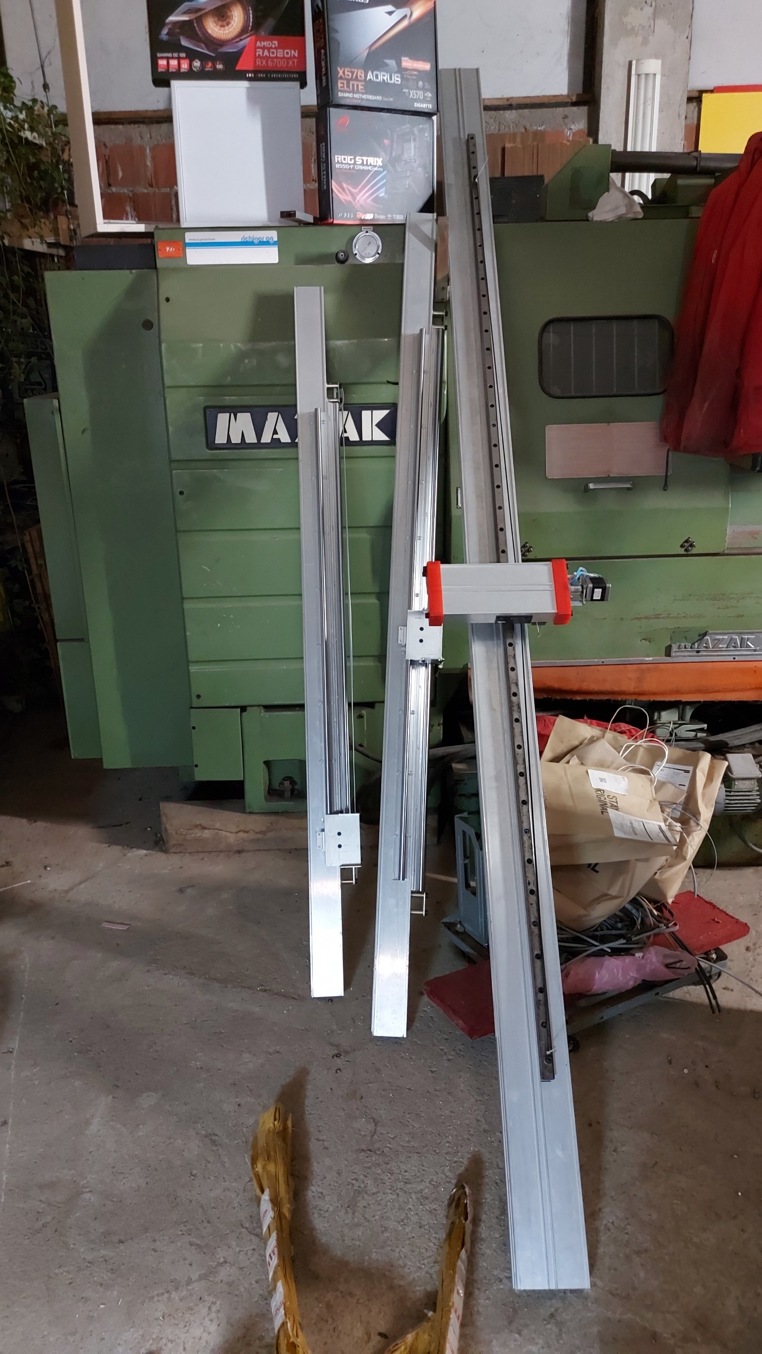

All 3 gantries are done with belts and reductions and Z axis mounts and hard stops. No limits yet.
Also all 6 uprights for 3 machines are done, now bolting them to gantries.
All this can also be taken as the procedure to build a cnc machine, start from the Z axis, always. Any other way will lead to issues during the way.

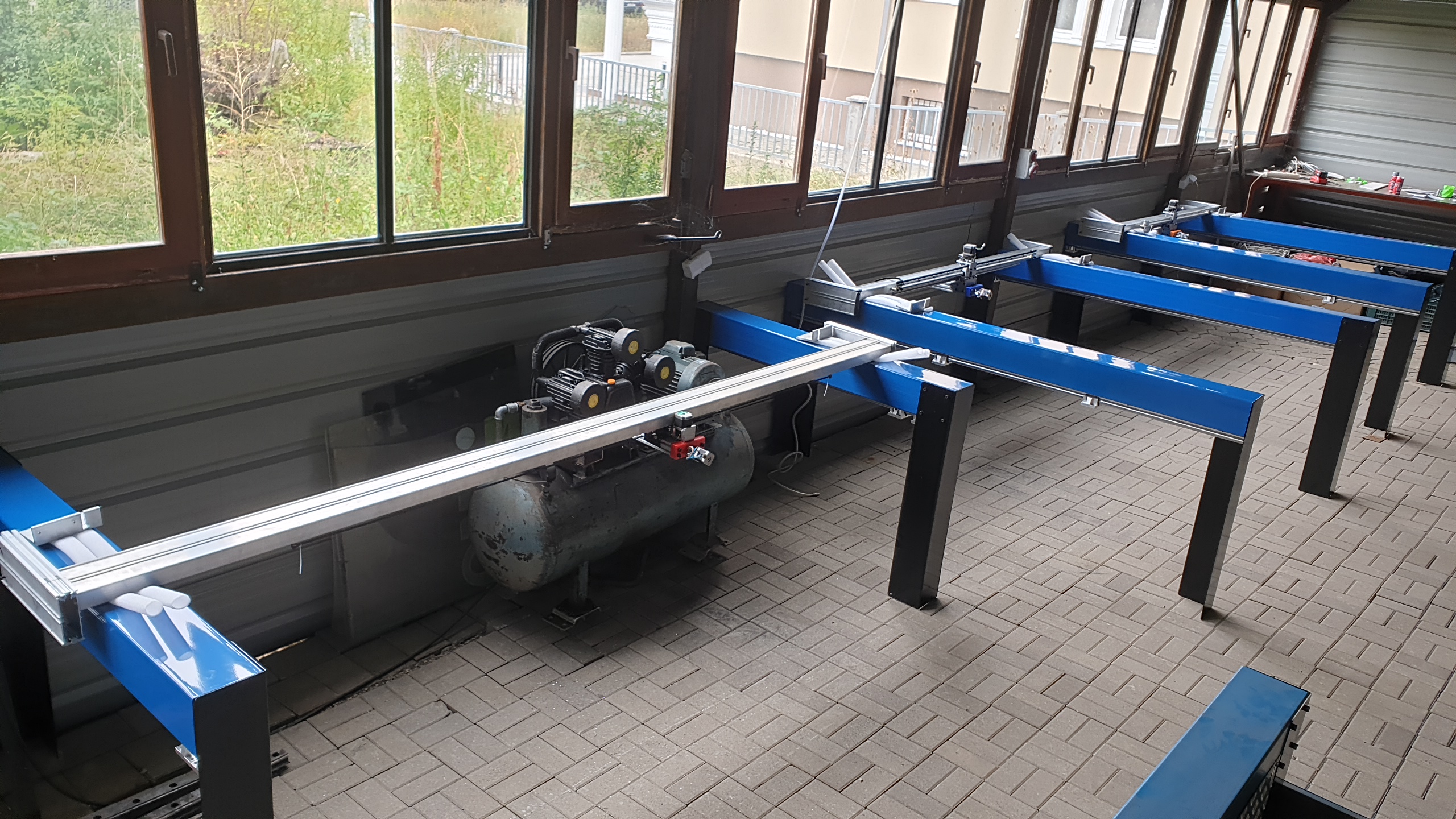

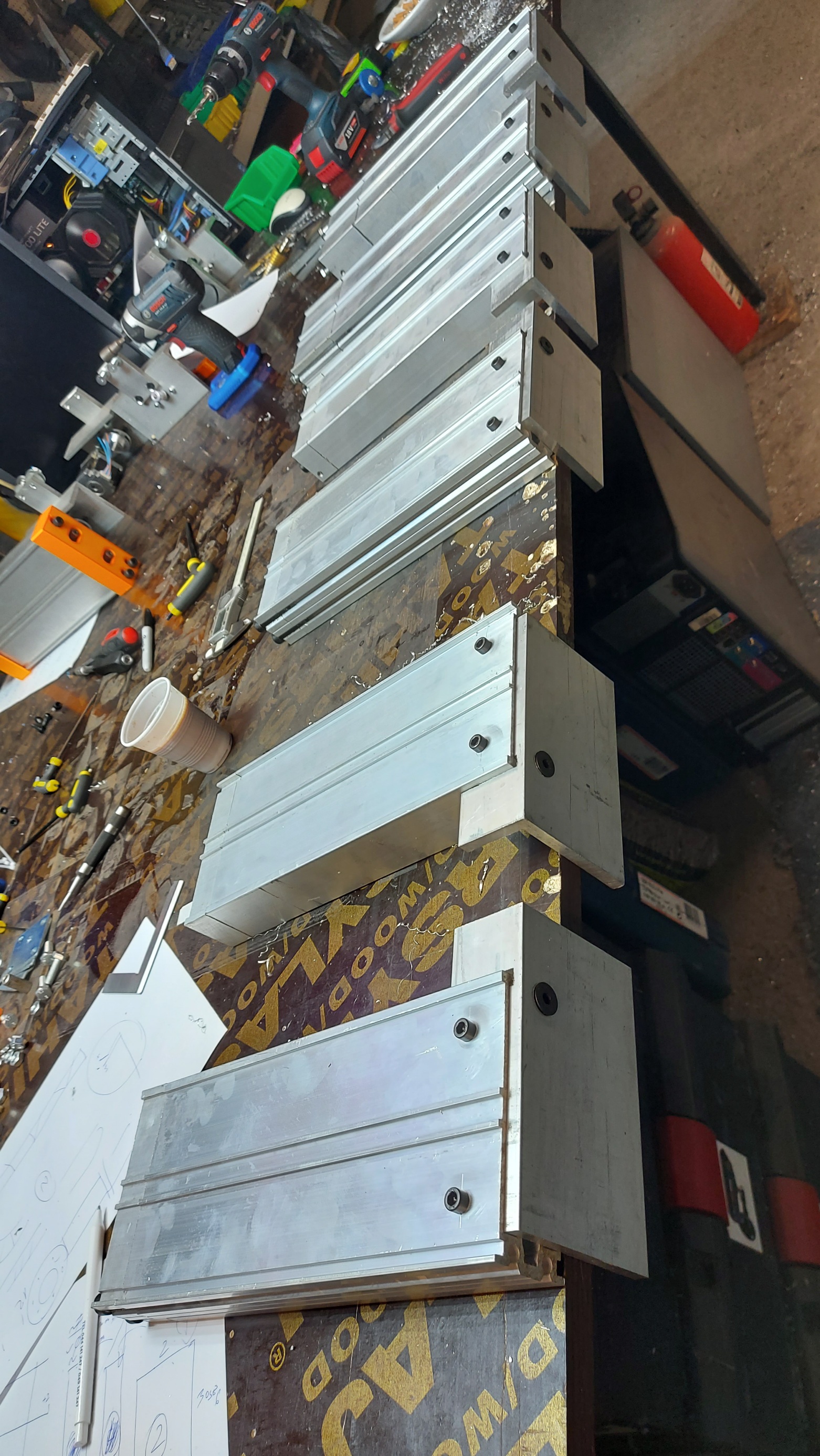

Finished all 6 of the Y axis (150×150×4), mounted legs (L profile 150x150x3), rails (SBR25) and 2 carriages each.
Pretty sure one of the Bosch drills had enough as it started stinking!
Now some more holes to bolt the gantries and belts, and later to mount the "skirt" = side plates.
Missing 8 of KFL08 bearings for the reductions, waiting...

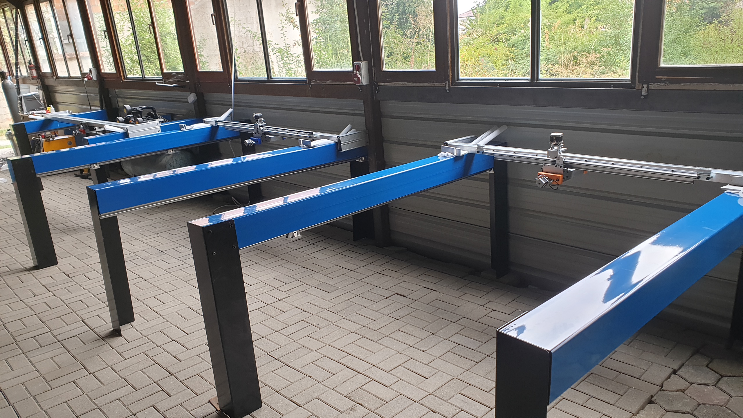

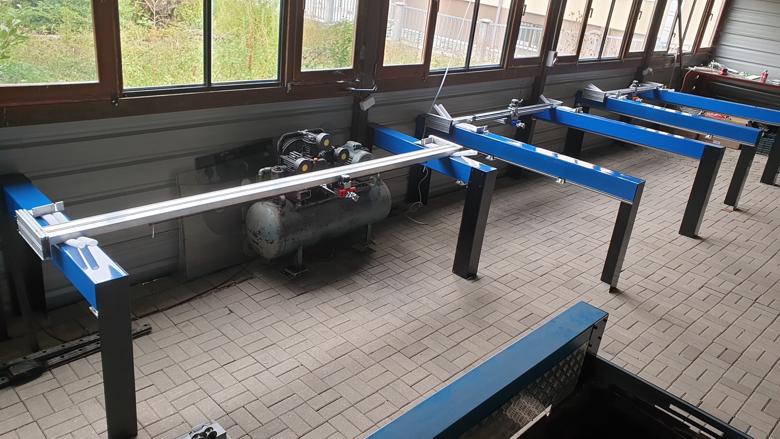

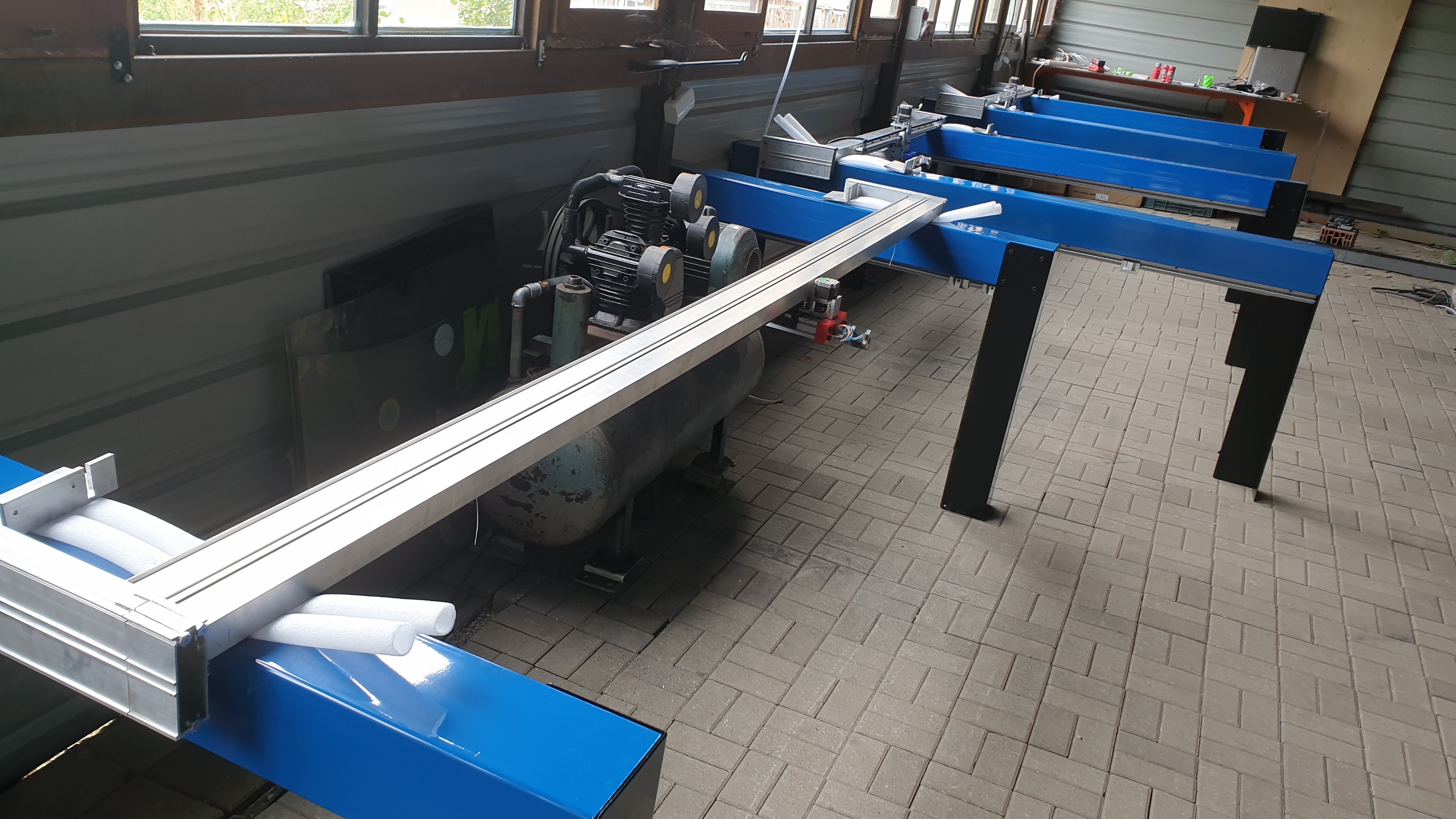

This is the current state of the 3 ongoing builds, gantries are not bolted to the Y axis yet, same for the reductions (might mount them today, who knows
), the design>cut>paint>mount the side skirts/panels, and that should be it ... for the mechanics since electronics are still waiting on the table or somewhere around the world!
Powder coating came out really nice this time and got done in 5 days so me is a happy camper.

Wasted nearly two days with it but could not shoehorn reduction into 70X80mm area, not even with a Nema 21 motor, also had to use 6mm wide belt as the space between the Z assembly and the gantry is 42mm minus 8mm alu plate minus some tolerance ....
It did not go well, at all, so it is directly driven with said Nema 21 Sanyo-Denki 1.8A motor. It will work but not a good solution by any means, HGH25 carriages have wipers on both sides so they do require some force just to move them, do not want to have to clean the rails before every probe just to be sure a spec of dust does not cause it to skip steps!
The rest has reductions, so pictures tomorrow, might want to remind me as i might be spaced out a bit, my youngest brother is also moving to USA and he is off tomorrow evening....
