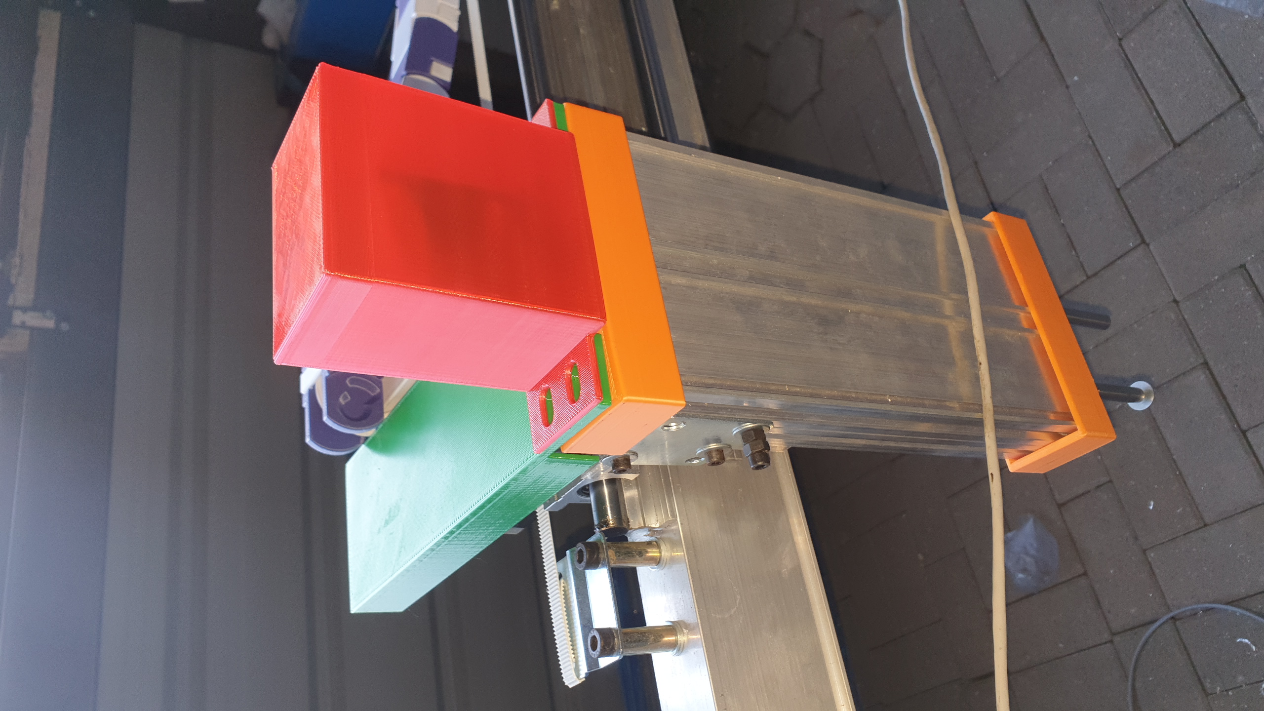

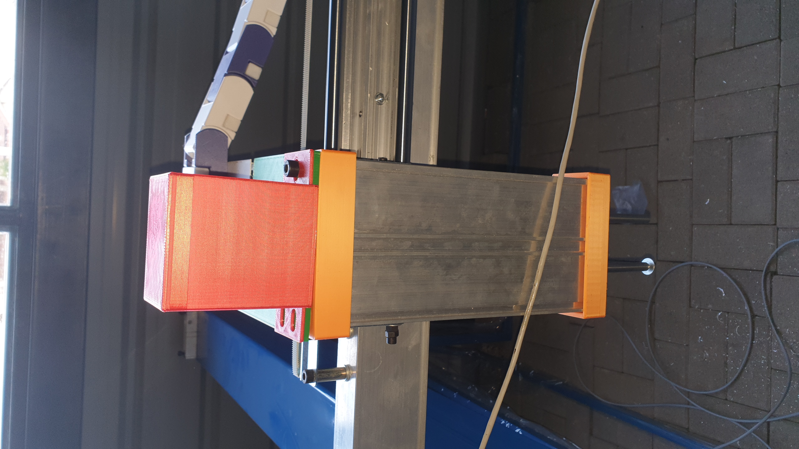

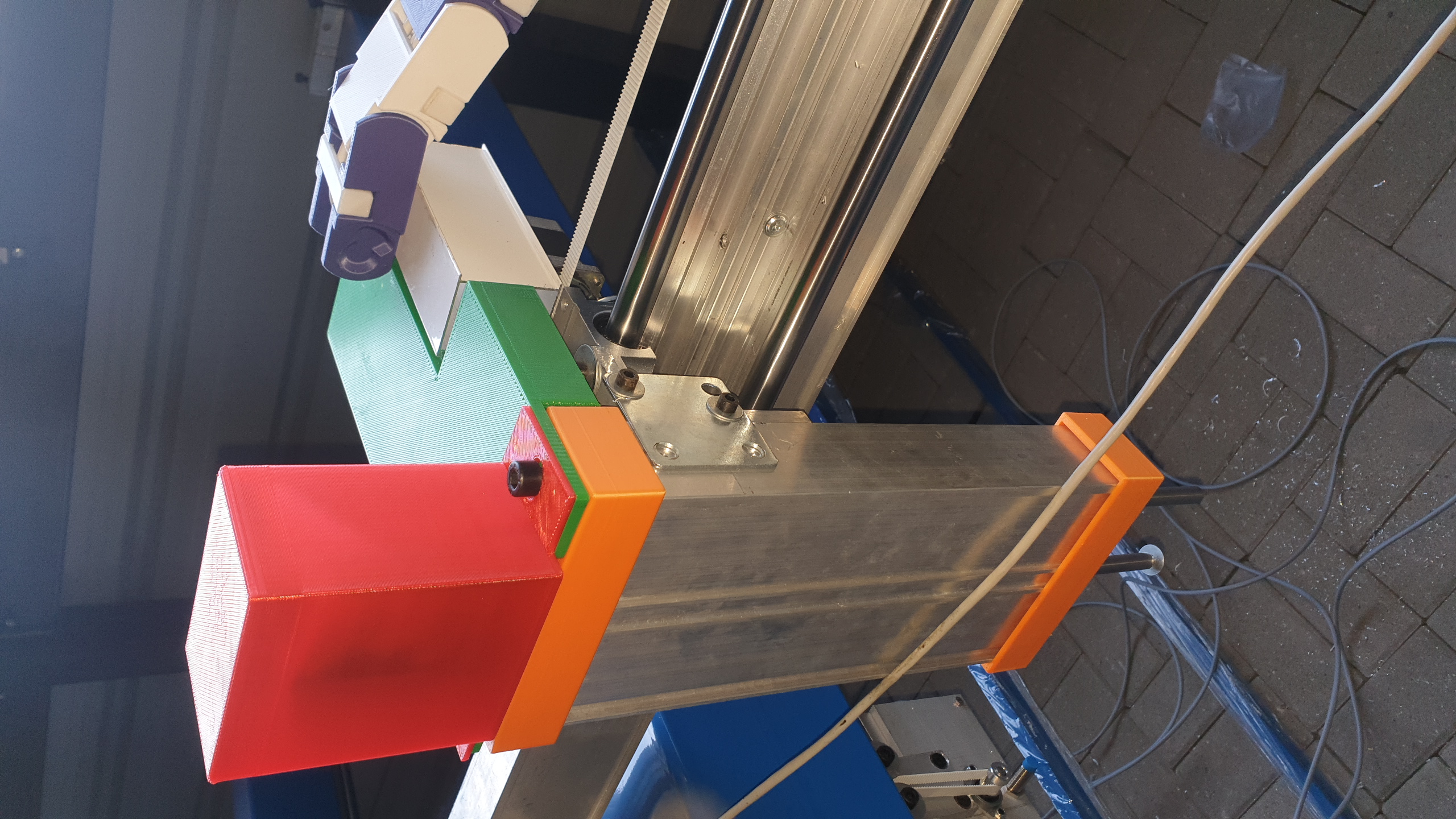

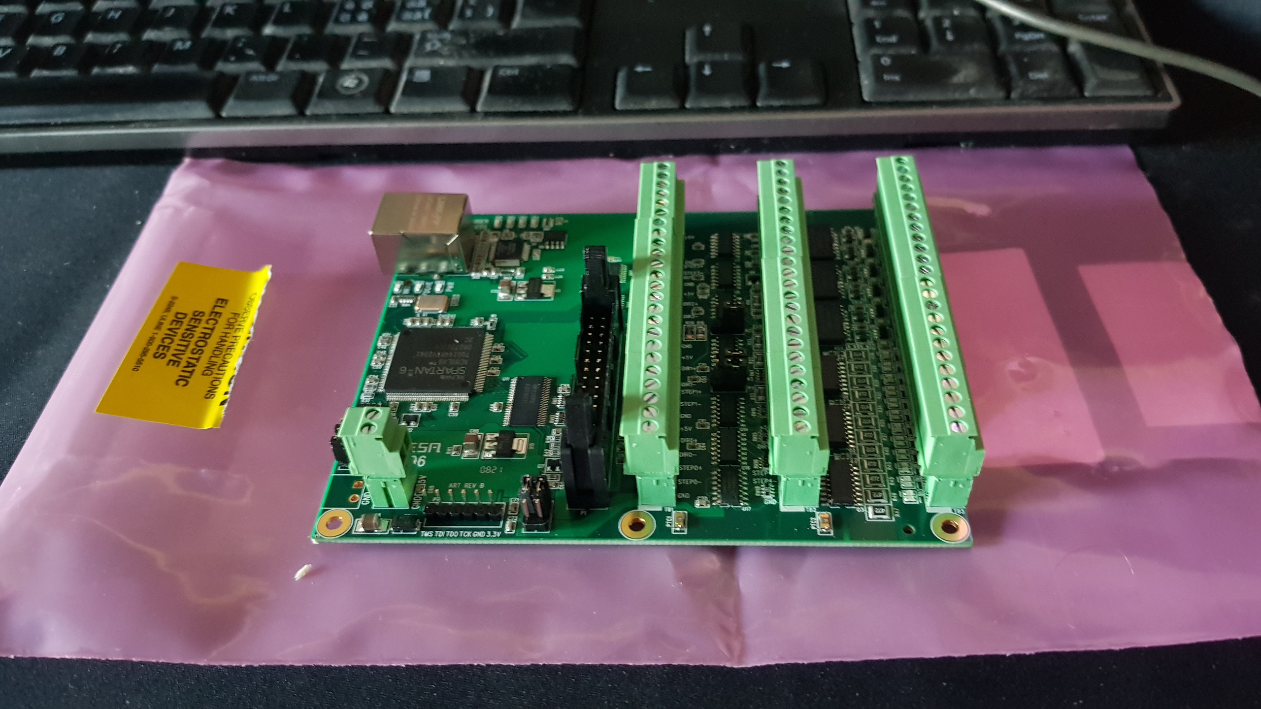

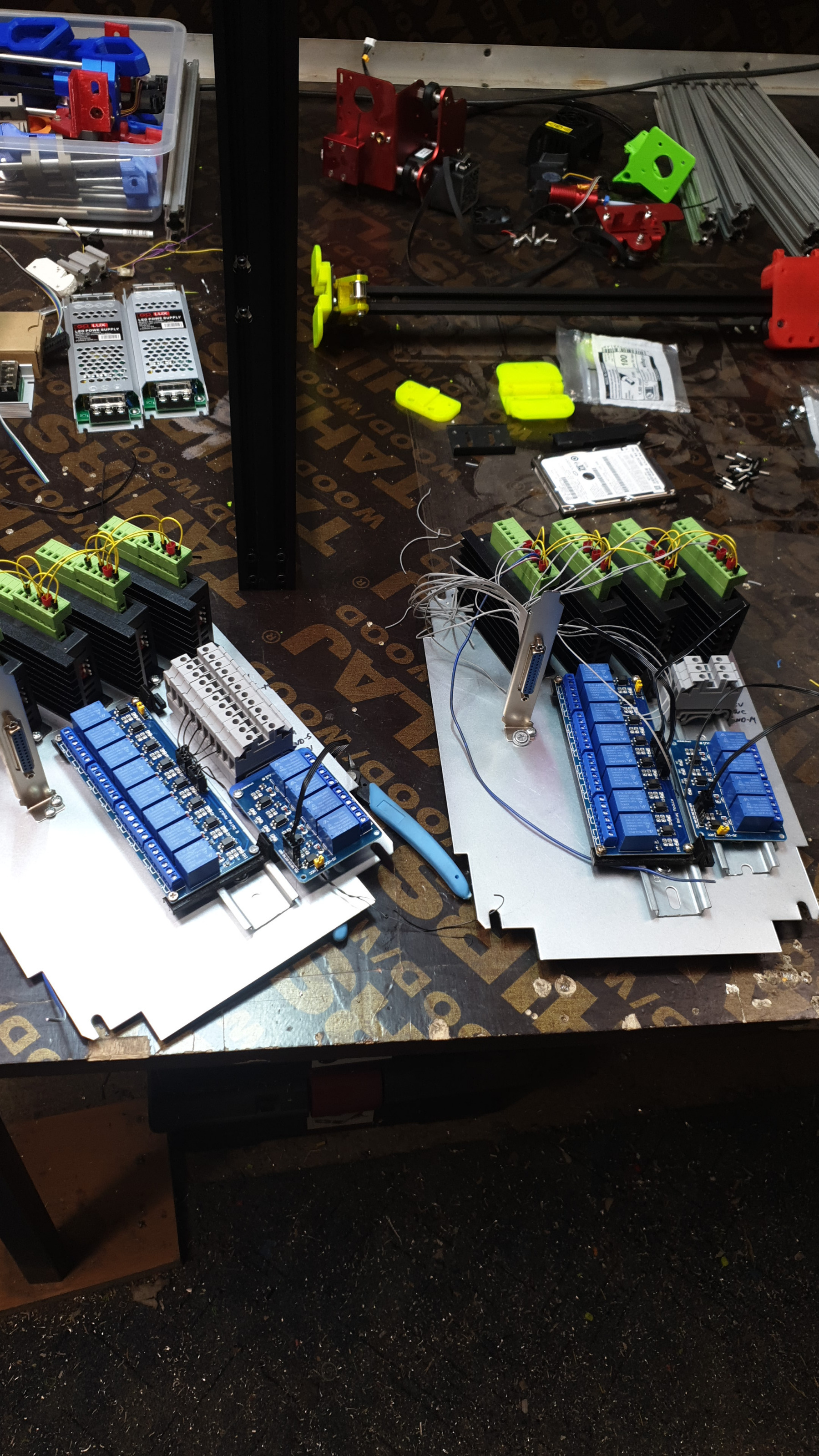

Got some more electronics parts delivered today and about 10 days ago, so now full steam ahead mounting and wiring the control boxes for the remaining two machines. As my $hitty luck would have it, went to get the boxes and there were none, so did some quick mock-ups in FreeCAD that came to about 2KG of plastic filament for one box and 3 days of printing, did not like that mainly as the cost would come to over 80 Euro a box, so went to get some other stuff and was told that some boxes just came in ! Oh boy, what a joy, that did not last, as the only usable boxes were 25x35CM and the lids do not have that nice pattern on them, just plain boring ... nothing. Still better than 3D printed option.
Now cramming 4 drives, 12 relays, 3 power supplies, 2 voltage regulators, and a Mesa 7i92 inside is fun, wiring all that stuff is not so fun.
And these are some parts i printed a while back for the Z axis covers, many colors, as even finding the same color filament has become impossible.
Still, fun !
