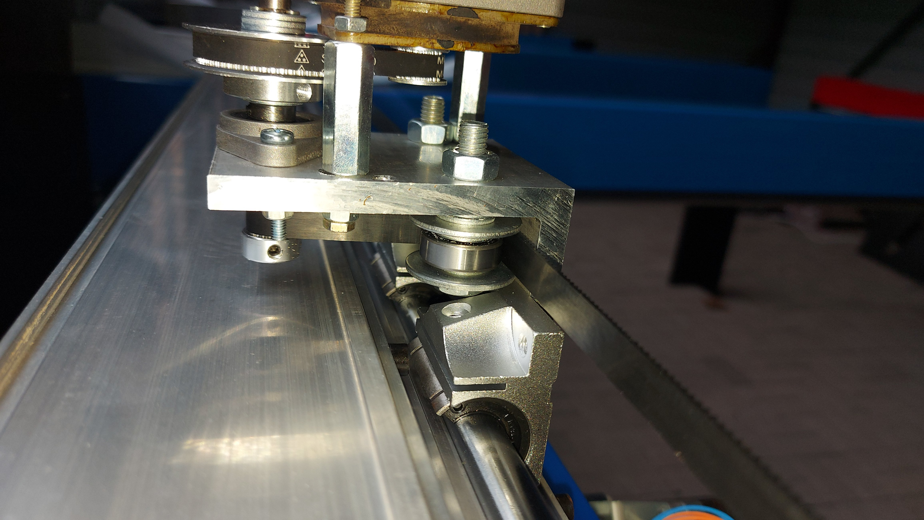

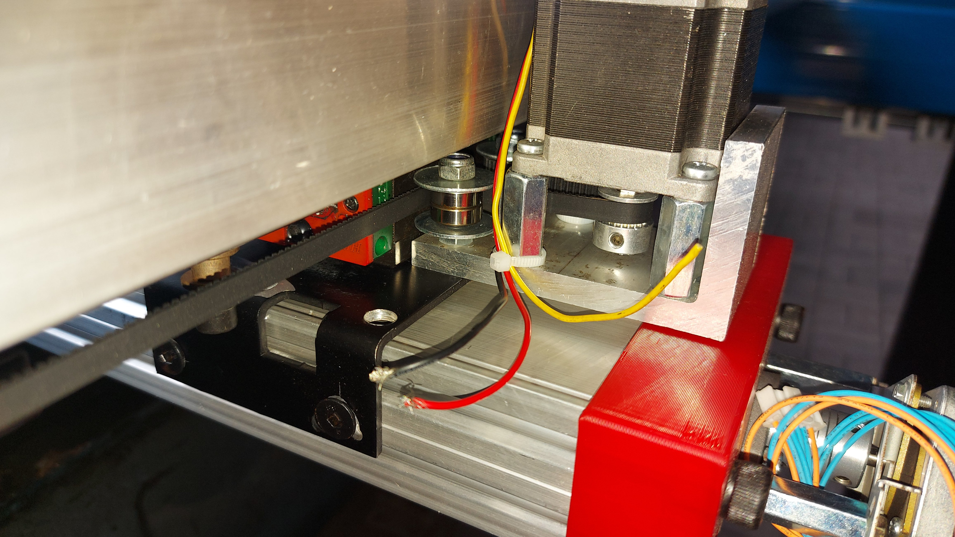

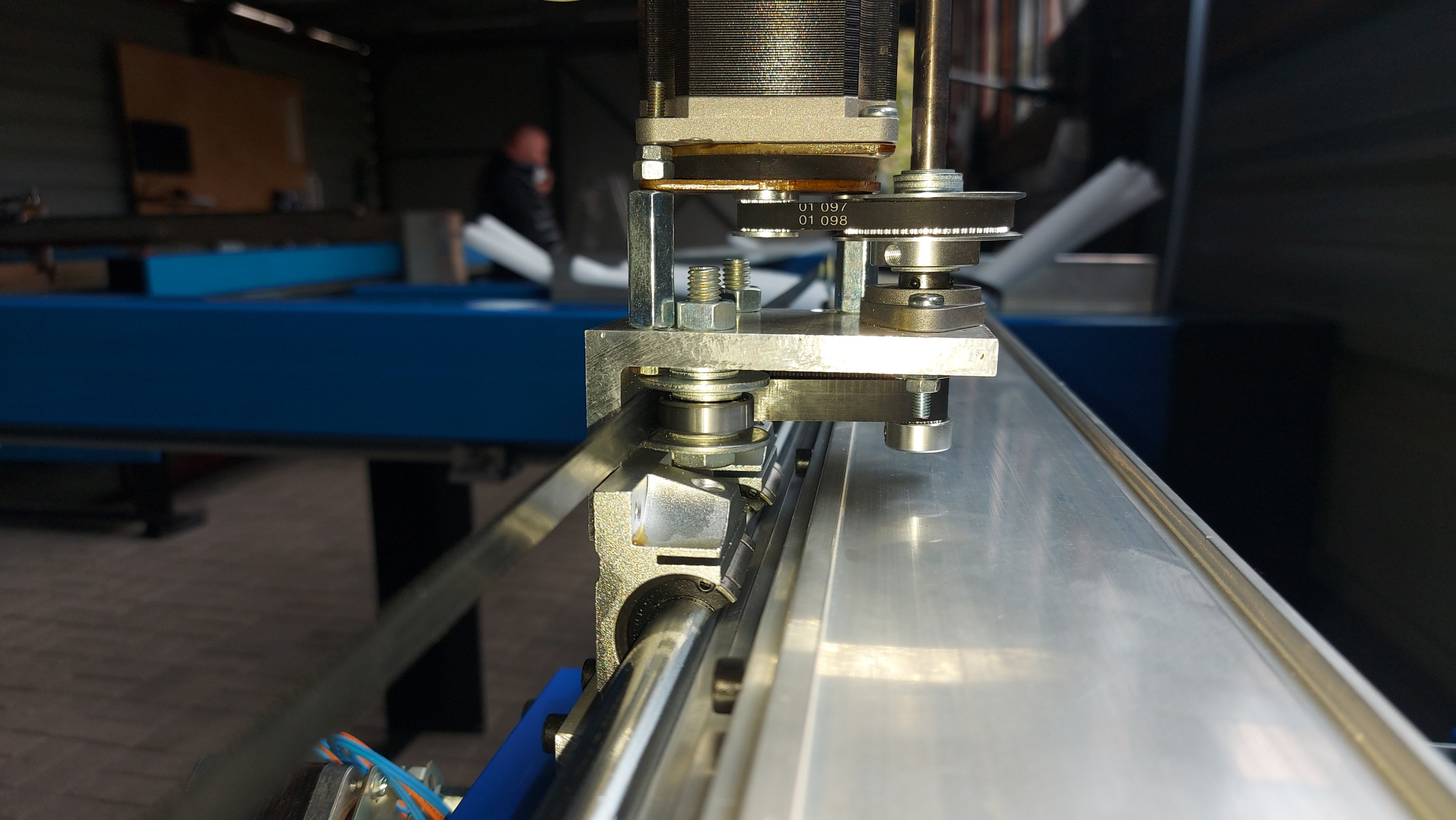

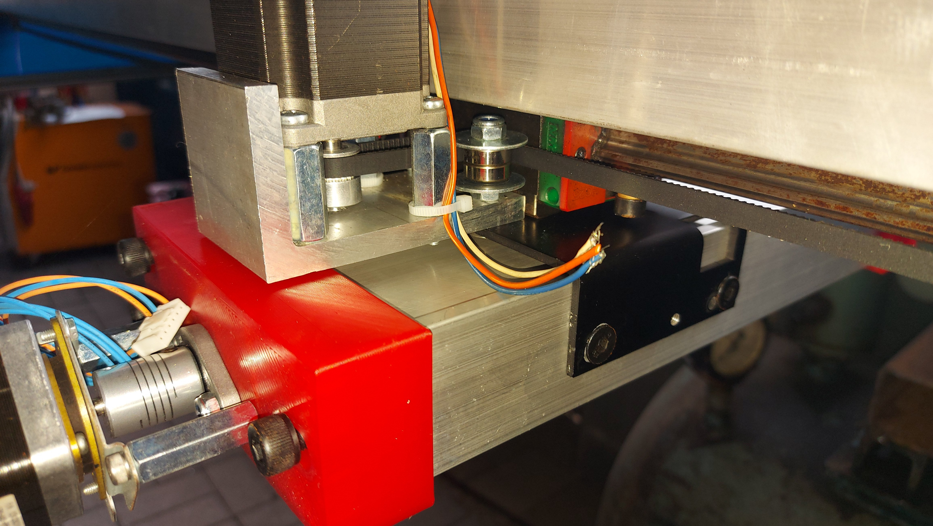

30 Sep 2021 19:49 #221909 by tommylight
As per request, here are the close ups of the reduction and the "invisible" reduction! :)
Most of the troubles with reductions are caused by the lack of that aluminium L profile, i have another 30CM of it left so i am saving as much as i can. Had found nearly 4 meters of it last year together with both of the profiles in pictures by accident and found out they were ordered by accident also, so i can not find it anymore, literally the guy had no idea he has that stuff in his shop till i sent him a picture of a small part that a friend of mine found in his yard, probably have to make an offer he cant refuse to push him to get me more! :)
The following user(s) said Thank You: Joco
30 Sep 2021 20:36 #221912 by Joco
Awesome - that confirms some thinking and looks very similar to some of my hack up sketches. Is that 6mm or 10mm angle aluminium? I don't have any so had been planning to use the 6mm thick flat bar I have to weld up my own angle shapes. Buying is not very attractive as I don't need much and there are minmum lengths I would need to get. Heck if that is 10mm from flexibility point of view I would be better off get some 10mm or 12mm flat bar and either welding or bolting it into place. :-)

30 Sep 2021 21:33 #221914 by tommylight
It is a 48X88X8mm L shaped alu, a bit of an overkill but i do like overkill.
I also use 50X10 flat alu bar for the idlers on the Y axis, and this i can order again from Austria through a company i worked for, roughly 16 Euro/M, so i am happy with it.
