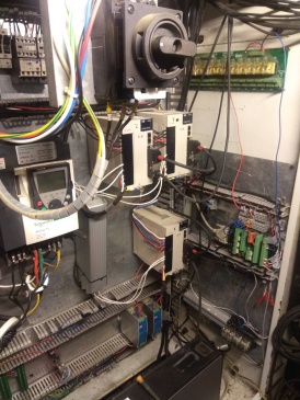

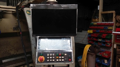

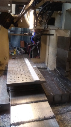

here are some more photos.

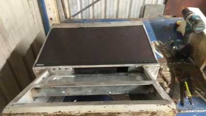

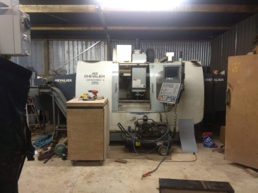

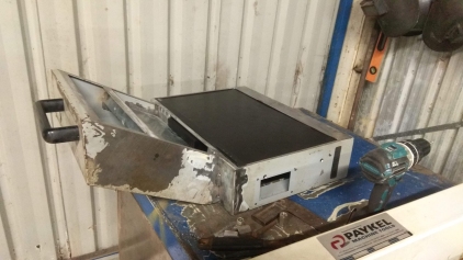

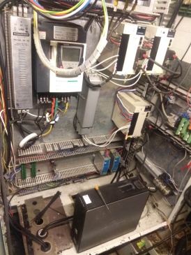

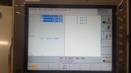

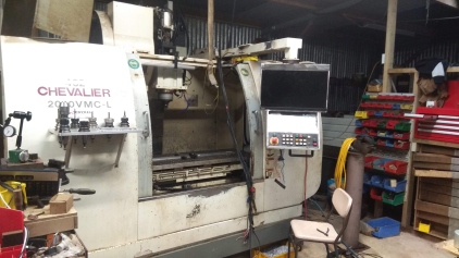

my machine started off as a heidenhain control.
here is what the original machine looked like once I craned it into the shed
it must of had a lightening strike or something and blew a lot of stuff bad.
So I gutted the whole thing and have started from scratch with chinese servos and linuxcnc running mesa cards currently using a 5i25 and 7i76 combo which is great.
looking below in the photos you can see a bunch of stuff and it is all out of order as this has all been done over the last while. the mpg in one of the photos runs on 12 v which is no good for me. I have 5 v from 7i76 and 24v from 7i76 io pins but I don't have 12 v on the machine. but I asked some questions on the user list and found out that I could use a $1 chip that would drop the voltage down for me. so for all intents and purposes the mpg is now a 24 v mpg as I just feed 24v. that works well.

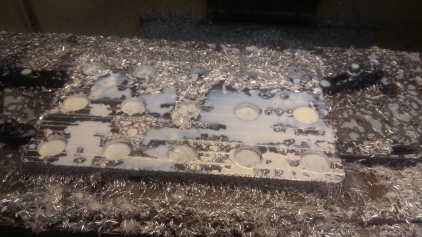

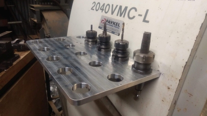

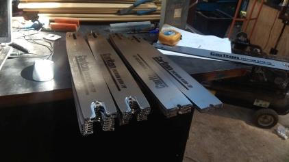

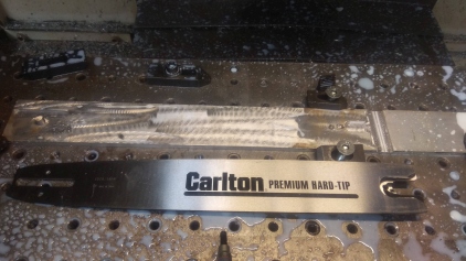

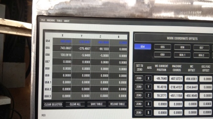

Recently this week I have installed the Probe basic gui.
there is a bit of a learning curve and I was helped heaps by a really nice guy in germany but it is installed and I have run my first part on it.
see my youtube channel for more videos as I add them
I will upload some videos of it cutting soon. I have been running parts all week on the old axis gui before I upgraded. axis was rock solid never missed a beat for months.
the new probe basic gui is also good but significantly more complicated. I definitely recommend starting with axis. get your machine working well and then change once everything works good. probe basic is harder to trouble shoot as there is a extra python layer in the mix.
I have been using industrial controllers for years (fagor and siemens) and probe basic would rank there, right up with the best in my opinion once it is set up properly. just little things make it good like the workoffsets table. axis doesn't have a nice table to reference all your g54 g55 g56 etc workoffsets. having a live real time g code plotter is great lol. If you have ever tried drip feeding into old controllers from another computer you will know what I mean. it is scary not knowing where the machine is going to go next just hoping it is right.

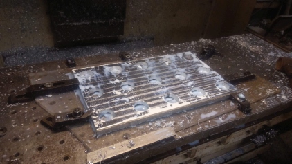

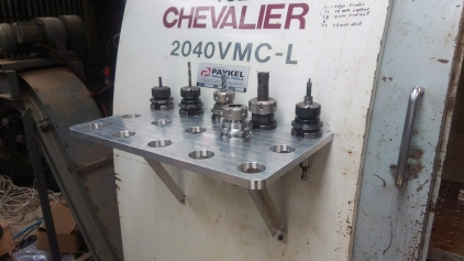

I made the toolholder rack with my younger brother (15years old) as a quick project using fusion 360. I had a bit of scrap and we had a play. the whole job took 37 mins cutting time.
and I have machined 100 of these chainsaw bars this week. the steel is like hardened steel or something. really ate up carbide endmills I eventually changed to a special blue coating endmill for hardened steel. this one did the whole job but even then was pretty bad around the corners by the end of it. The carbide for these comes from sandvic and has some special high temperature coating on it. I sell them as part of my sideline tooling company which is nice for cheap tooling for me lol. You can machine bearings with these bad boys)
Ps I am missing out lots of details here so if anyone is interested in something just let me know and I will add extra photos etc.
and then I will post the current issues lol and hope that people can solve them for me.

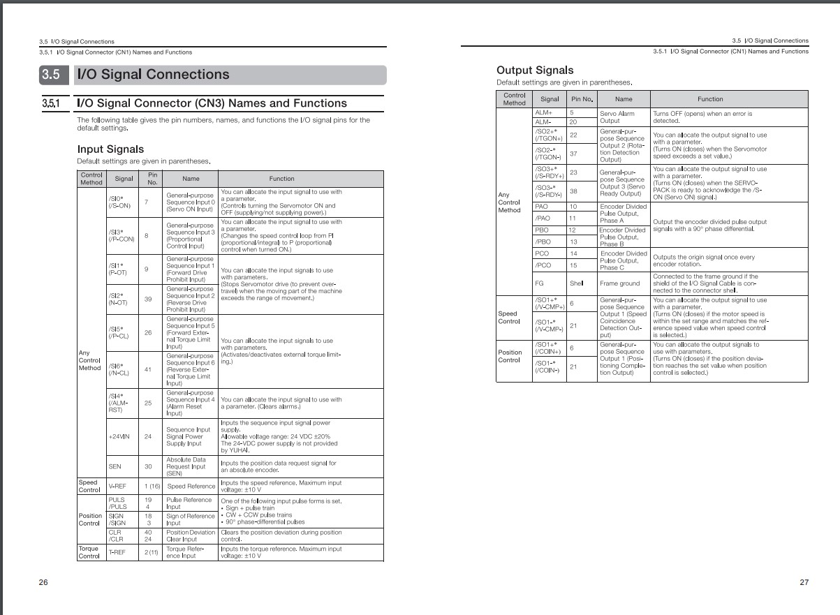

hey tom

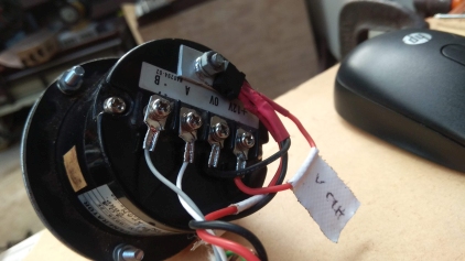

since you answered my other question so fast and since you have been doing this before I have another quick question here.
I am using step dir chinese servo drives and the drives are "smart" eg they close the loop with the servo motor/ servo drive loop.
these drives like most of yaskawa copies can output the encoder pulses to a external controller in my case mesa 7i76 spindle encoder input.
I have checked and the drive outputs standard 5 v differential signals suitable for the mesa to read.
my only question is how do i connect up at the mesa end. I have 3 pairs of differential signals from the servo drive. A B Z. Since this comes from the servo drive not a standard encoder I assume the signals get powered from the servo drive and I leave the 5v and ground unconnected on the mesa encoder inputs?
just a little bit stuck here. been trawling the forum for hrs trying to find a definitive answer
regards
Andrew

06 May 2020 21:34 #166928
by Becksvill
Replied by Becksvill on topic Vertical Machining Centre Retrofit with Chinese Servo Drives Build Thread (NZ)
this is a general call for help now.
I am need some positive confirmation here about what I need to connect.
just to refresh everyone. I have 5i25 and 7i76 mesa cards. 7i76 is powered from a 24v dc powersupply for the field IO.
currently the jumpers are setup to supply the 7i76 5v logic power from the 5i25.
I am trying to connect this encoder signal from my servo drive into the spindle encoder input in the 7i76
as you can see the servo powers the encoder so I think I don't need the 5v from the mesa card.
Now what gets me confused is the grounding of everything.
question 1: Do I even need to use a ground with differential signals
question 2 if I need to connect the ground what in my servo drive do I connect it to?
I want to avoid any grounding loops and am a little confused
I will make up a big diagram soon showing how everything is connected.
regards
Andrew

- Posts: 22030
- Thank you received: 7504
07 May 2020 04:00 #166935
Replied by tommylight on topic Vertical Machining Centre Retrofit with Chinese Servo Drives Build Thread (NZ)
1 No, just use the shield from the drive but do not connect the other side of it, meaning the shield is connected only to the drive, the Mesa side should not be connected to anything.
2 encoder shield.
And you will need another Mesa board, something like 7i85X , but not sure exactly, so someone else might chime in.
2 encoder shield.

07 May 2020 04:19 #166941
by Becksvill
hey tom
so just to clarify
I already have the cable shield grounded to the servo drive connector case to reduce interference.
does that mean that I can just connect the 3 differential pairs up (so 6 wires in total and I am good to go) So the encoder differiential pairs don't need a ground also?
and also what about the 7i76 logic 5v power from the 5i25? will that be ok for now as is. I know eventually I will need to get a separate 5v powersupply so I don't put too much load on the pci slot with 5 encoders running..
All I want to do for now is connect each axis up in turn, to the spindle encoder in the 7i76 and then use the encoder feedback in halscope to know what I need to set the Pid loop in the servo drive to. then I will remove the feedback and tune the next axis and so on...
I should have a 7i89 mesa card (this has 5 encoder inputs on it) coming asap once I can get it shipped from america. and I will get a 7i84 also for some more IO pins as I need about another 20 IO pins for buttons and such.
regards
Andrew
so just to clarify
