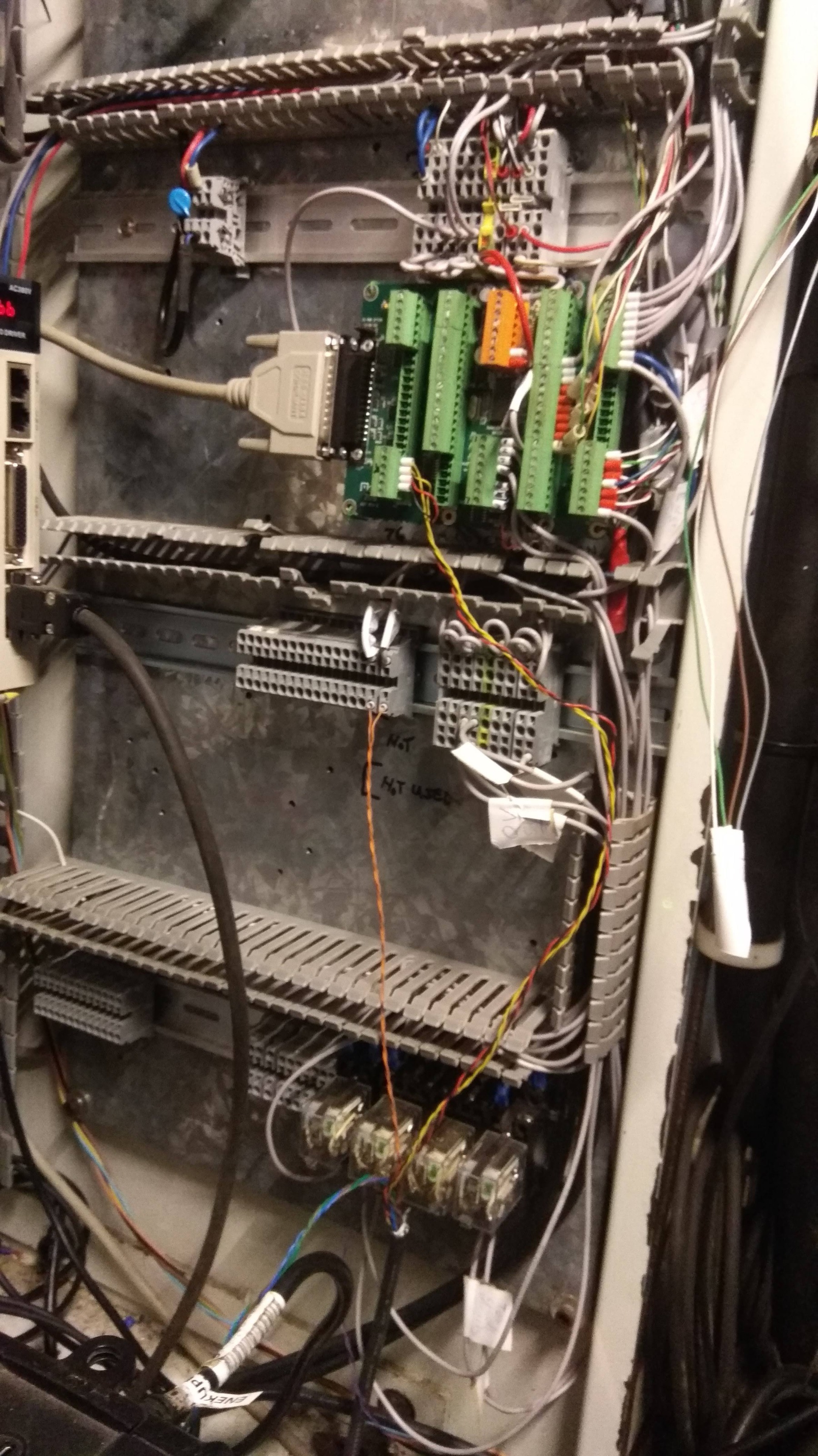

hi guys
I am just connecting up my encoders and and thought I would post a quick photo of my mesa card wiring system. It isn't particularly neat but if you had seen the first effort!
you can see my space I have here for the new 7i89 card once it comes. and the E stop circuit relays and spindle direction relays are down the bottom.
I had to use a relay to set up the direction as the 7i76 mesa card doesn't connect up nicely with my vfd without a direction relay in the system.
regards
Andrew

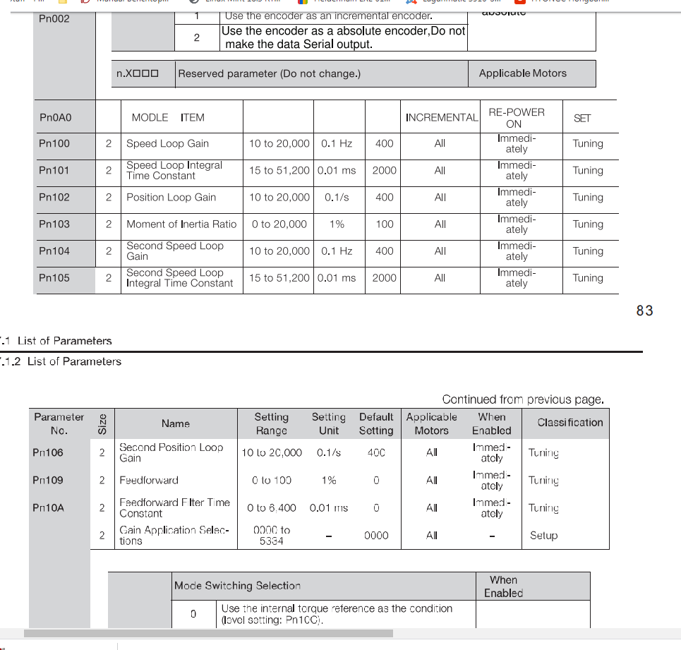

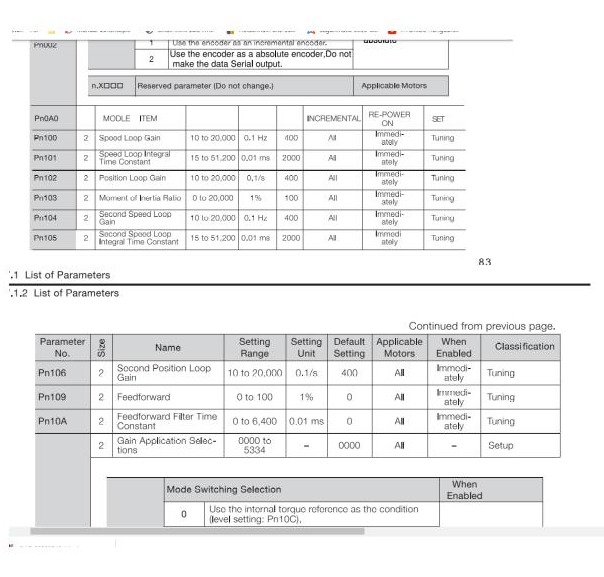

Hey guys some questions here if anyone has answers
here is the servo drive manual for anyone that has questions. and I will screenshot the interesting stuff so you don't have to search through the manual. as no one likes to do that for no reason haha
yuhau servo google drive link
I am not sure what all these terms mean. If someone could either link me to a good tutorial or reply here that would be appreciated.
Edit: I do have a fair idea what most of the tuning terms mean but have never actually tuned a servo drive yet so assume that I don't know anything lol.
Currently I have the encoder count working in the Axis Hal configuration window. But it is inverted and reading negative. I think I have two options here. once is swap the A and B channels and the other is put a negative sign on the encoder entry in the INI file that I haven't made yet.
regards
Andrew

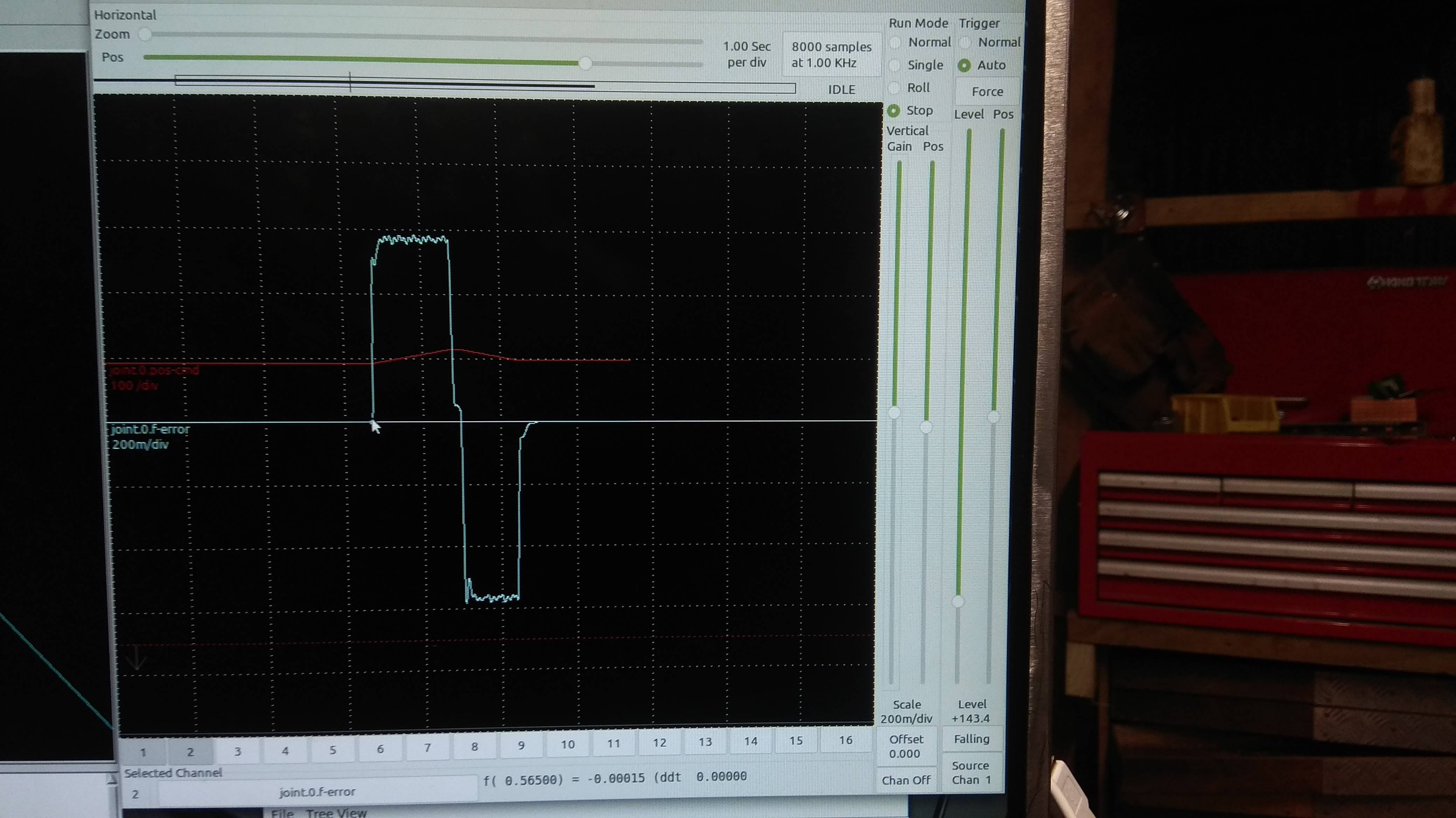

Hi everyone.
just a quick update here.
If you have been following along here you will see that I have been trying to tune my chinese servos with their software which I finally gave up on. my eventual plan is to have the encoders running back into a 7i89 mesa card and be permanently set up but currently I don't have the right cards and getting them is a bit of a pain with all the Covid 19 mess. the shutdowns are great for working on machines (here in New Zealand the government essentially pays me to do it. But getting parts is a bit of a pain. anyway I am running the feedback out from my chinese servo drive into the spindle encoder input on the 7i76 card I have. the idea is then I can plot the F error in Halscope the use that to tune the servos by changing the parameters inside the drive and checking the result in Halscope.
after spending most of the say painfully searching forum posts I think I have cracked it! Yeha. It is 11pm here but I finally have some success.
this Halscope plot shows the commanded position from linux cnc and then the F error which comes from my encoder feedback showing how the servos are actually following the commanded position.
there were a whole lot of Hal connections to set up but I think it is working and I will try to document this for the next person that spends half the day searching for help haha. hopefully when you see the next few posts they help you.
regards
Andrew

I am not sure which Pid terms I should be concentrating on. Tommy if you are watching this is where I need that servo tuning help. I will go over your tutorial also in a sec
So my system is a step and dir system with a 7i76 mesa card.
I am trying to tune the velocity/ position loop in my servo drives just using Halscope to graph the error so I can tune the drives.
So I am not using 0-10v control signals.
as that is the case I am not sure what to make FF1
and FF2
and a explanation of how the pid terms talked about in your tutorial relate to my tuning parameters would be helpful.
need a little help here.
and FF2

I am trying to use the encoder output from the drives to graph the following error and velocity error so I can tune the drives as the chinese servo tuning software to hard to get working.
I have halscope working fine now
currently I am measuring the joint.0.f-error
also I just connected up another input from the encoder velocity
net x-vel-feedback =>hm2_5i25.0.encoder.00.velocity-rpm
that way I can graph the difference between the commanded velocity and the velocity feedback
(just realised that my scale is not accurate though. the commanded velocity is in m/min and the encoder velocity is in rpm. (better fix that)
