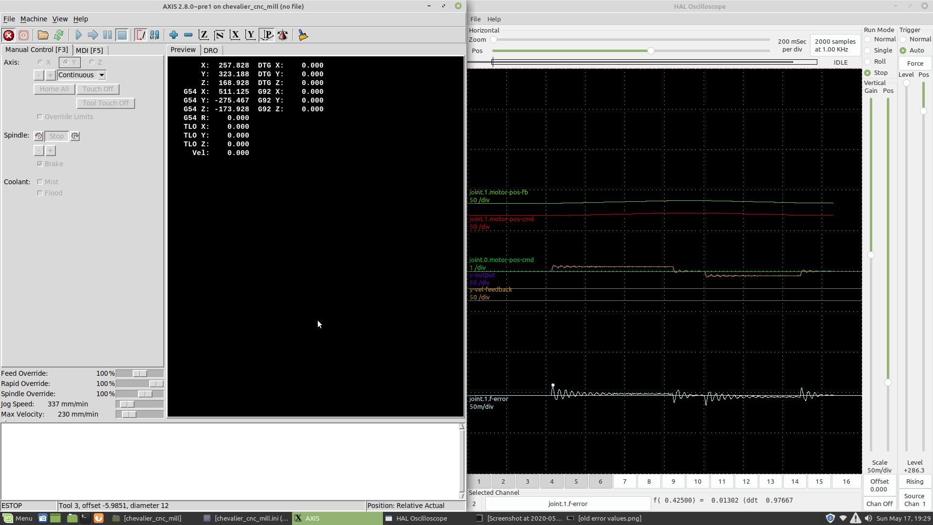

17 May 2020 23:40 - 17 May 2020 23:48 #168096 by Becksvill
got some updates here guys

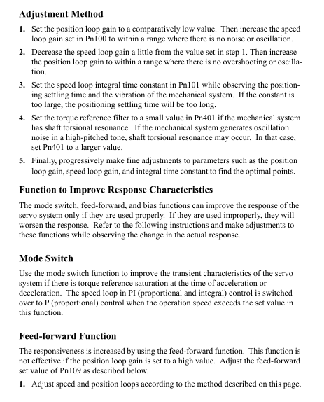

I finally got a hang of tuning. this post is showing tuning the Y axis. I had it tuned in 1.5 hrs.
the first axis I did took me 4 days haha.
I will try to update this thread with usefull info in the hope that the next person that gets stuck finds this and has a easier time of it than me haha.
connecting the encoder into linuxcnc and using halscope just to graph the following error and then change the tuning values in the servo drive worked awesome. took me 4 days full time to work it out lol.
Now as I said earlier my servo drives are a chinese copy of a yaskawa sigma 2 servo drive.
they have a PIV controller. I don't have a D tuning parameter. at all.
also the servo drives have 3 nested tuning loops inside the servo drive.
so they work like this position loop > velocity loop > torque loop.
the the adjustment procedure I followed was this. I had to set feedforward to 100 percent first while the gains were low.

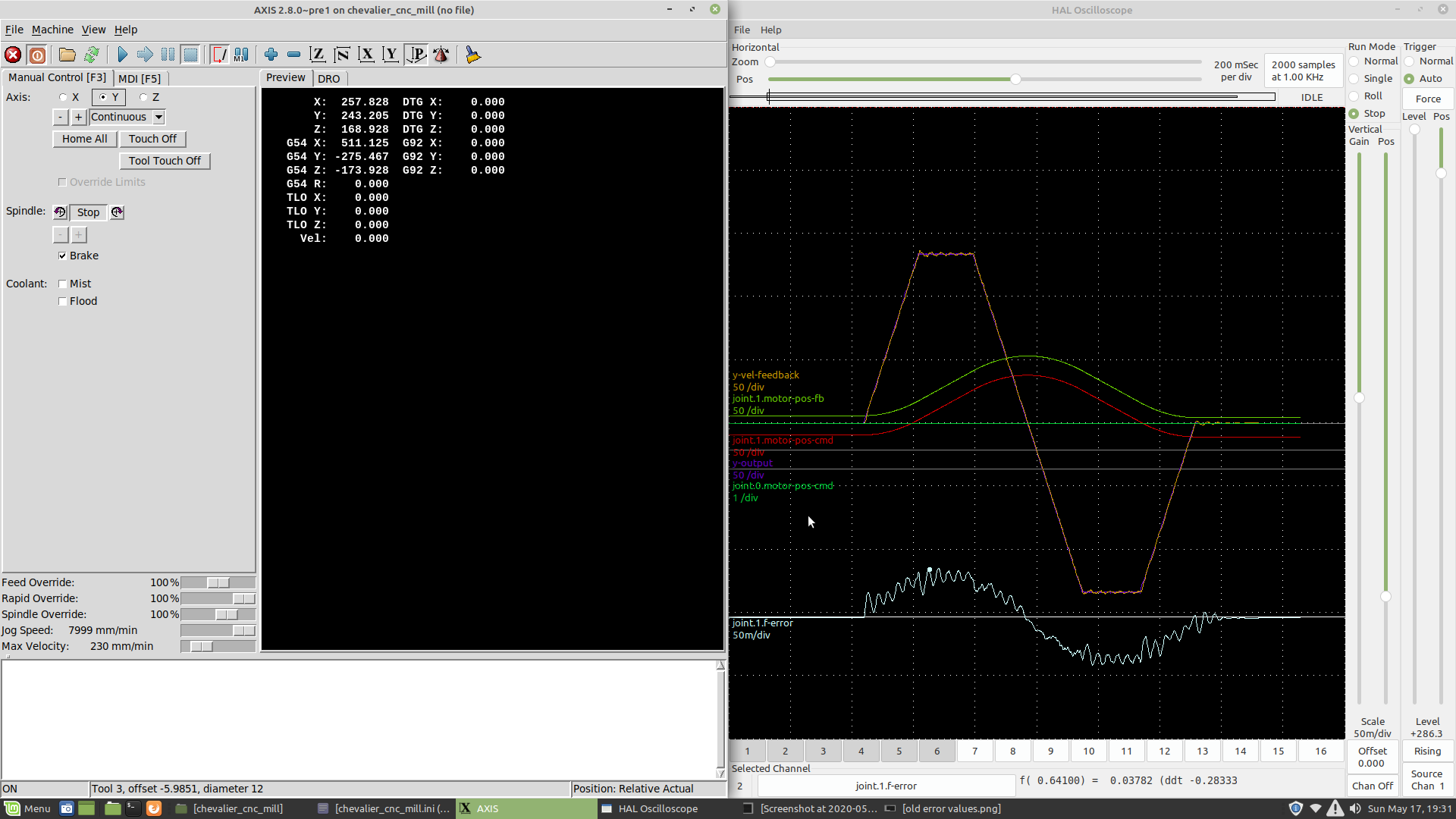

this is the original tuning I started with
the max following error at 8m/min rapid speed was 2mm!
and I was using the cnc all week on jobs... oops. good thing they were not that precise

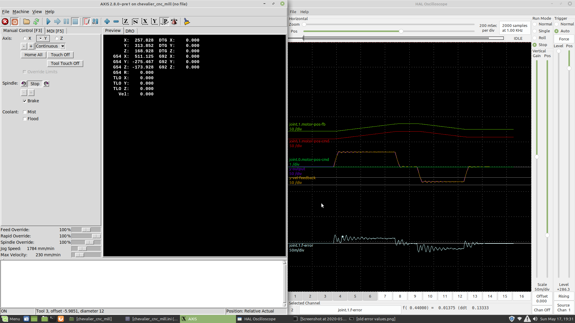

here is the final tuning after I played with the values a bit
first photo is at 8m/min rapid speed
and this is at 4m/min
this is a 337mm/min
I could have made the tuning much tighter but I was getting a ballscrew shaft resonance issue at lot travel speeds. at 17mm/min the noise was clearly audible and really annoying. But there was a setting for torque filter time constant which was supposed to remove it. this is at a expense of a little bit of accuracy. So I decided to reduce the noise and lose a bit of accuracy. the following error is still down around 0.01 at normal cutting speeds which is good enough. I had it down to .004 mm but the noise was annoying. increasing the torque filter time constant stopped the noise but increased the error as the movement was very slightly delayed.
anyway that is enough for now.
I am planning on making a in depth video showing how this all works for the next person as this would be a good solution for everyone that is running open loop step and direction servos that wants to actually know what the following error is. Not just hope. as you can see my open loop following error was appalling.
also this way You can do it with the standard 7i76 that so many people are using without any extra cards. though as soon as I can get the cards I will be using this type of setup permanently.
But next step once I get a 7i89 will be to run a PID loop in linuxcnc also and use a bit of Intergral to reduce the following error just that little bit more. this will also allow me to home to the encoder index pulse which will be nice.
and it will be so good to not loose position every time I disable the servo drives with the E stop for whatever reason.
Ps the thing that caught me out is the tuning process was substantially different to how people normally tune with linuxcnc PID loops
Tommy's awesome tuning tutorial was all completely different and had no relevance to this sort of PIV tuning in the servo drive.
I was stuck until I found the yaskawa sigma 2 servo drive manual which worked perfect.
also 90 percent of the tuning work in these sort of drives is down by the feed forward parameter.
Last edit: 17 May 2020 23:48 by Becksvill. Reason: missed something

18 May 2020 06:56 #168128 by Clive S
Thanks for a nice write up. My problem is that I don't understand what is wrong in the graphs and how to interpret them.
So a vid would be brill. :)
The following user(s) said Thank You: Becksvill

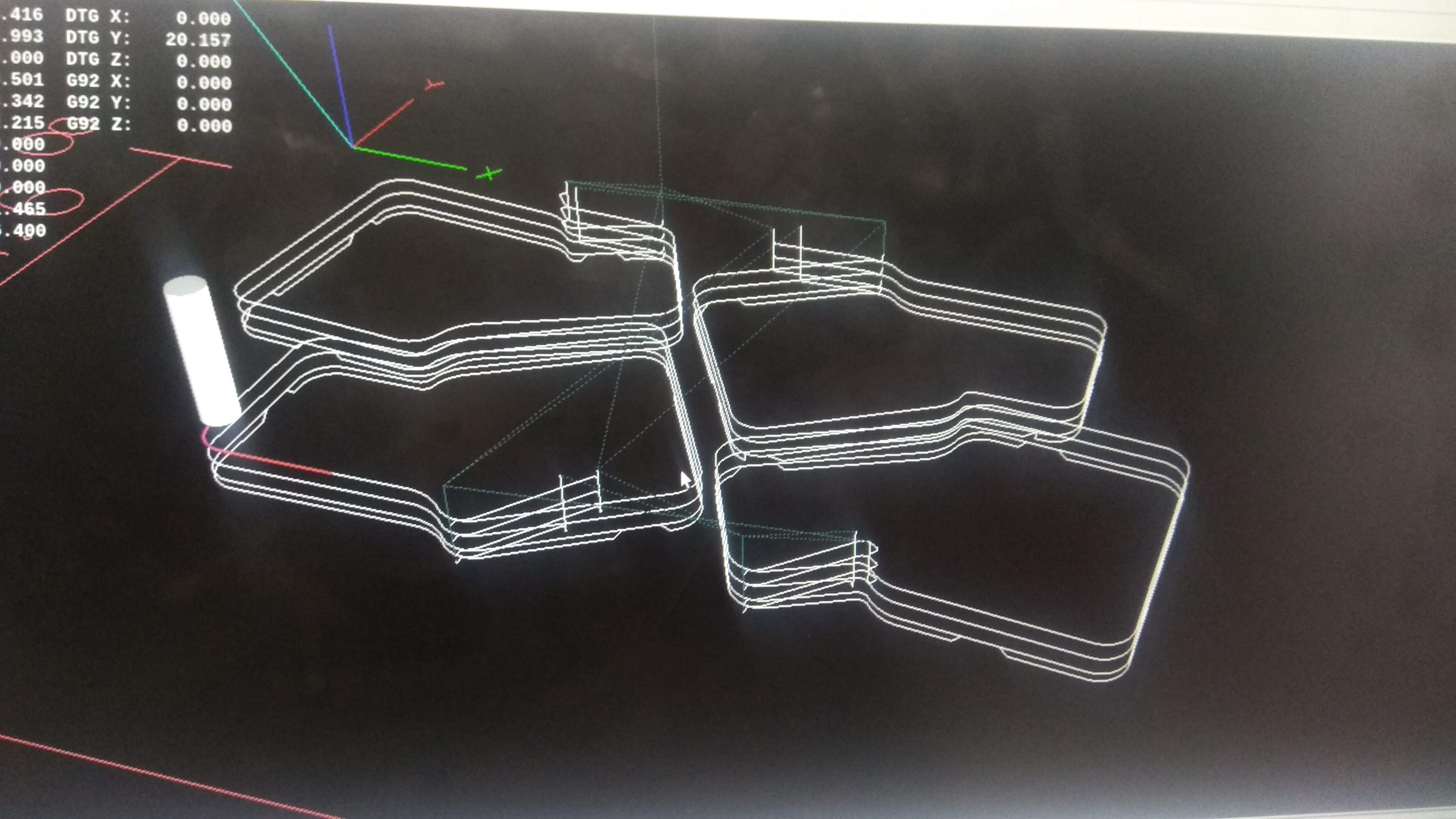

02 Jun 2020 23:46 #169888 by Becksvill
hey guys
I have made heaps of progress on the cnc lately.
and will make some decent updates showing how to setup several things later on
here is a partial list of what has been done recently
1 fixed my grounding issues I was having I think after lots of help on the email list
2 have connected up my new chinese MPG from aliexpress up to the mesa 7i76 card mpg counters.
3 increased the acceleration on spindle vfd
4 tuned servo drives I think pretty well now. still doing accuracy tests to check how good it actually is but initial tests are pretty good and Halscope is showing about .01mm following error at normal feed speeds
anyway as I know everyone loves videos and photos here are some from this morning.

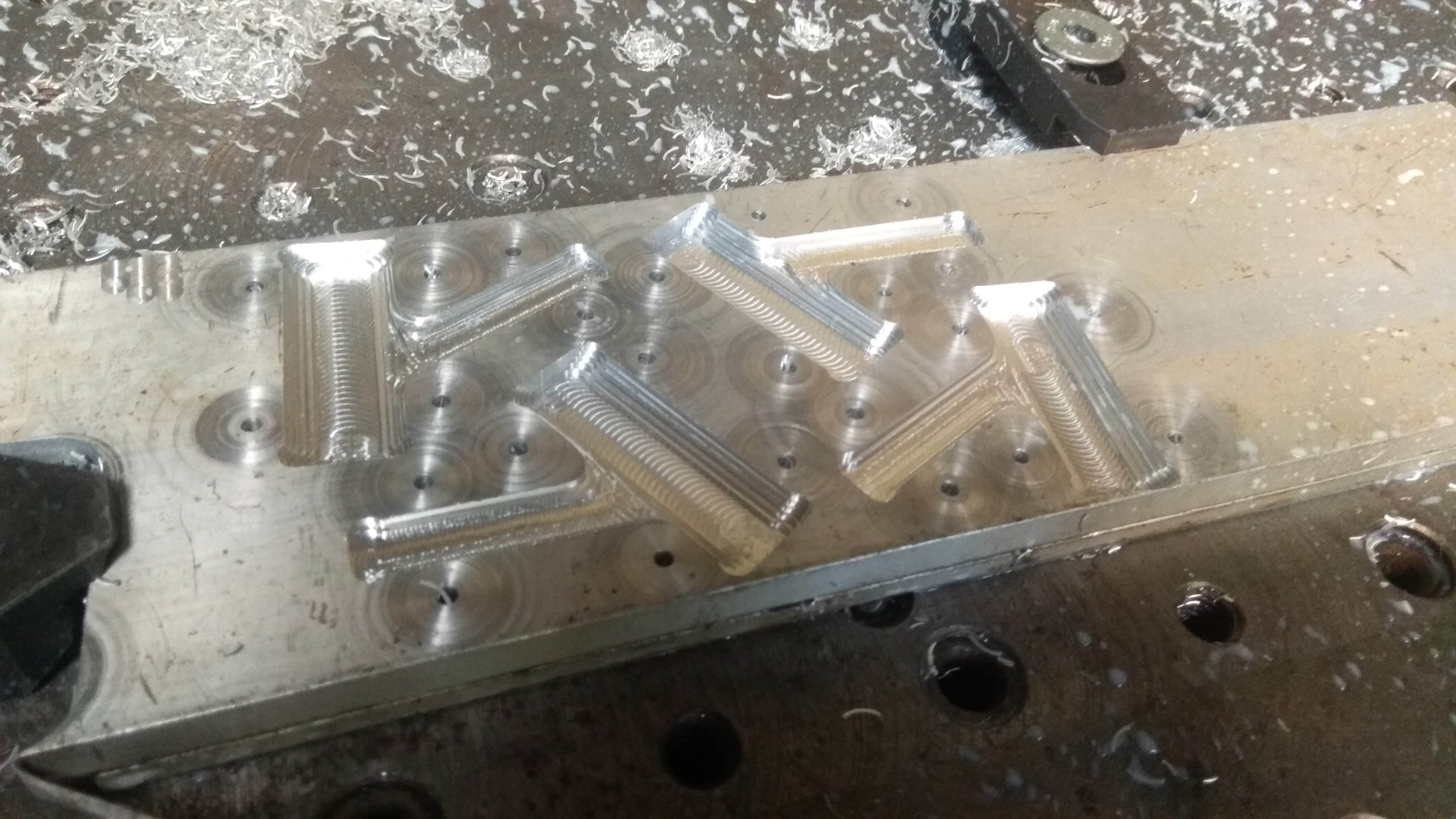

here is the toolpath on the controller

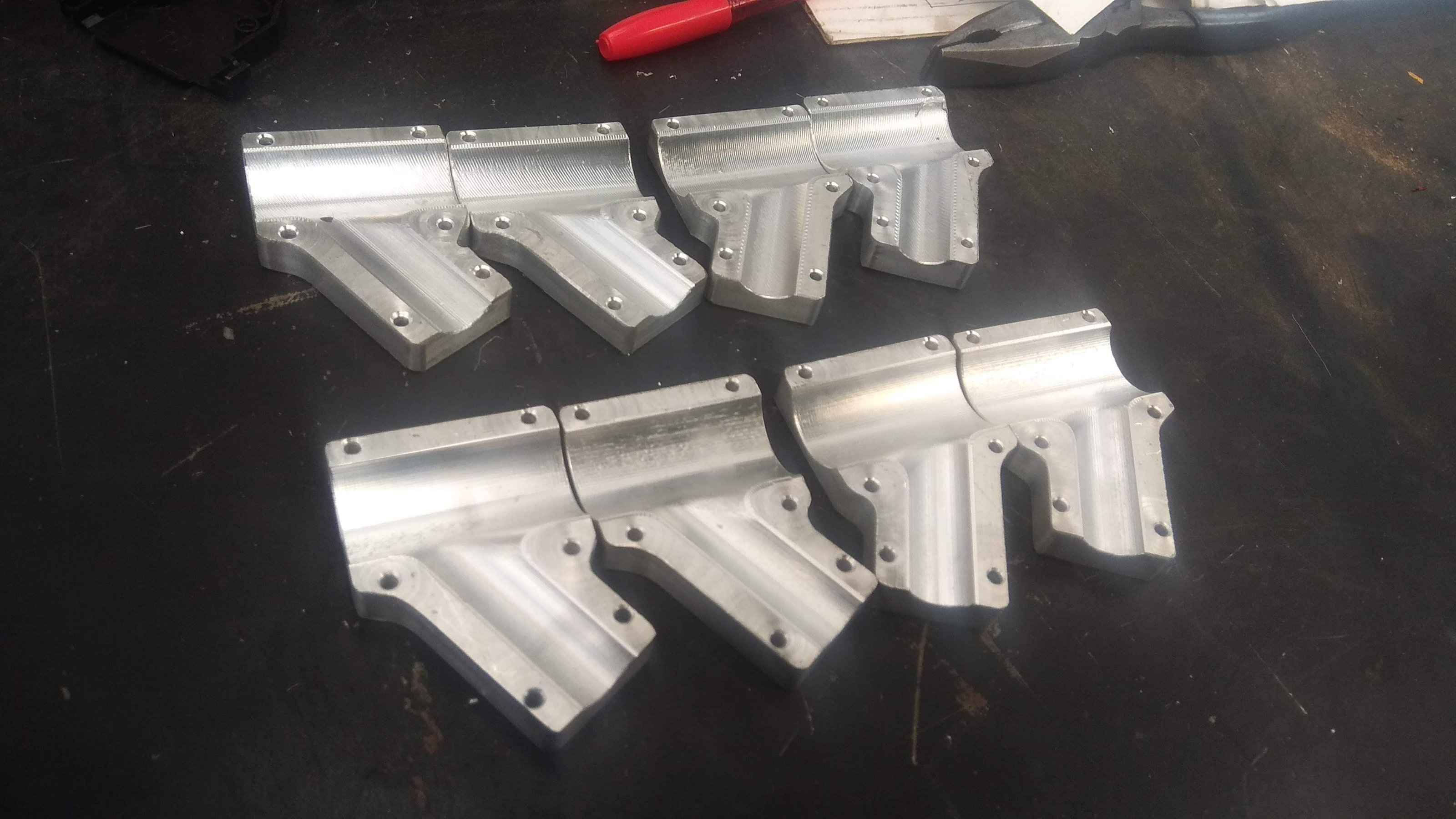

and here is the roughing part finished

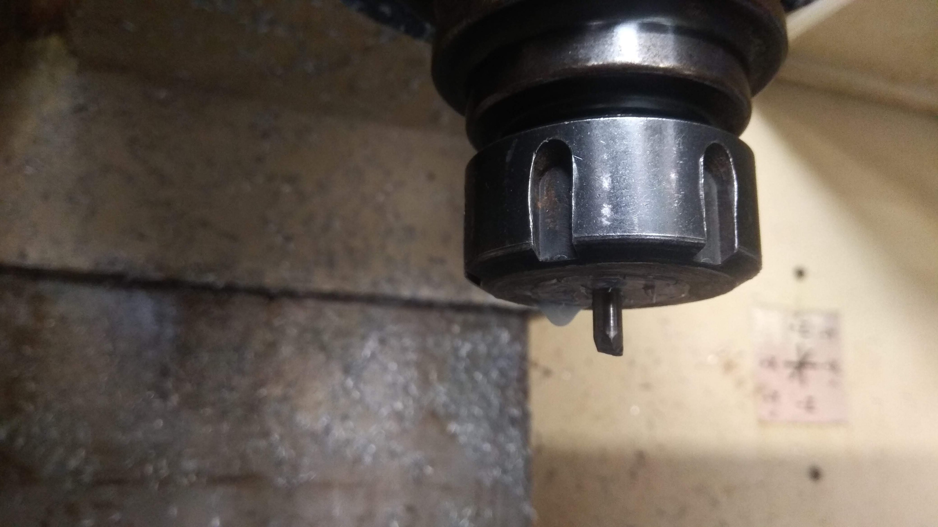

and the broken endmill I just broke while cutting them out! (happened 5 mins ago lol better get another one from my stocks)
regards
Andrew

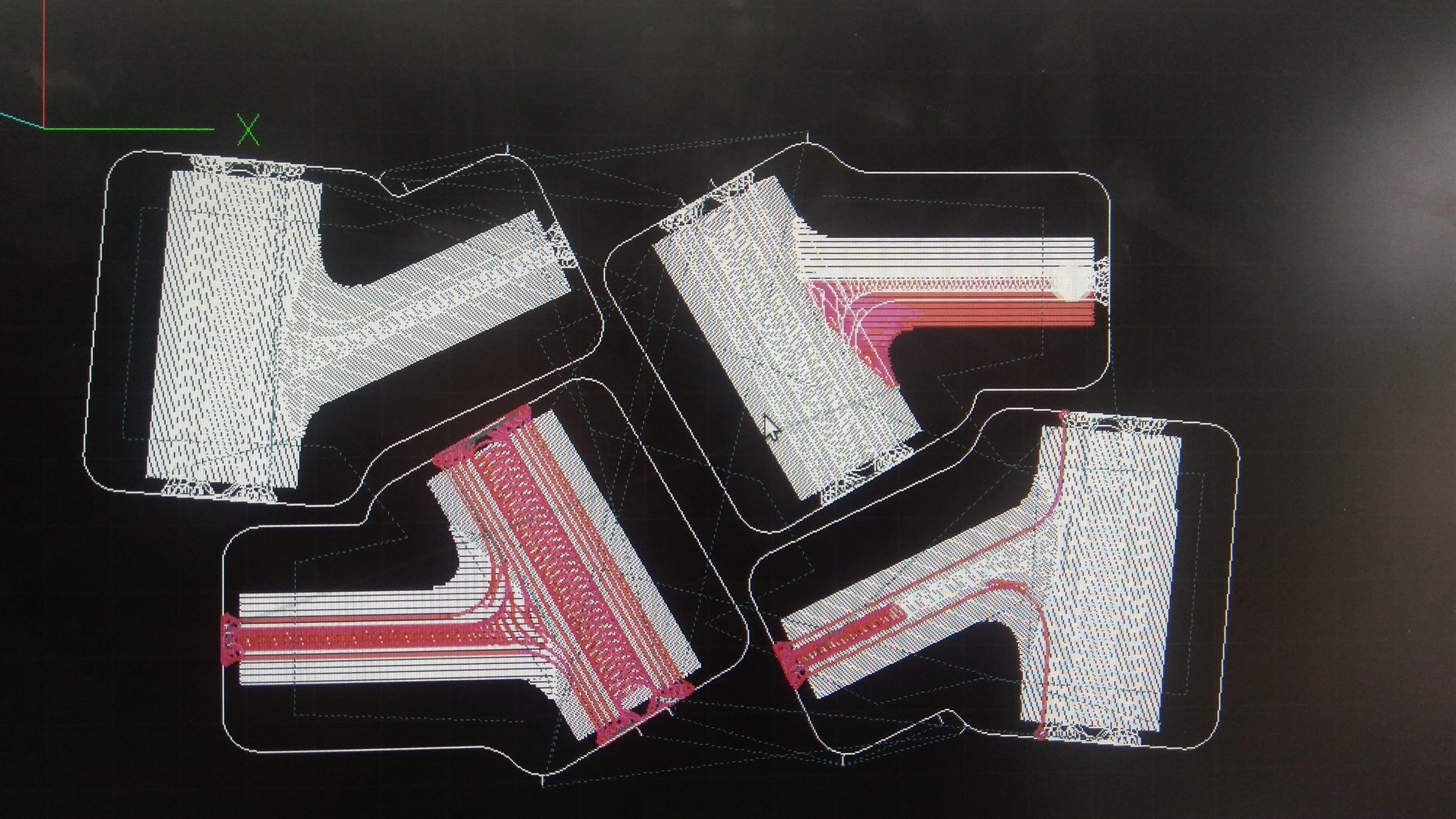

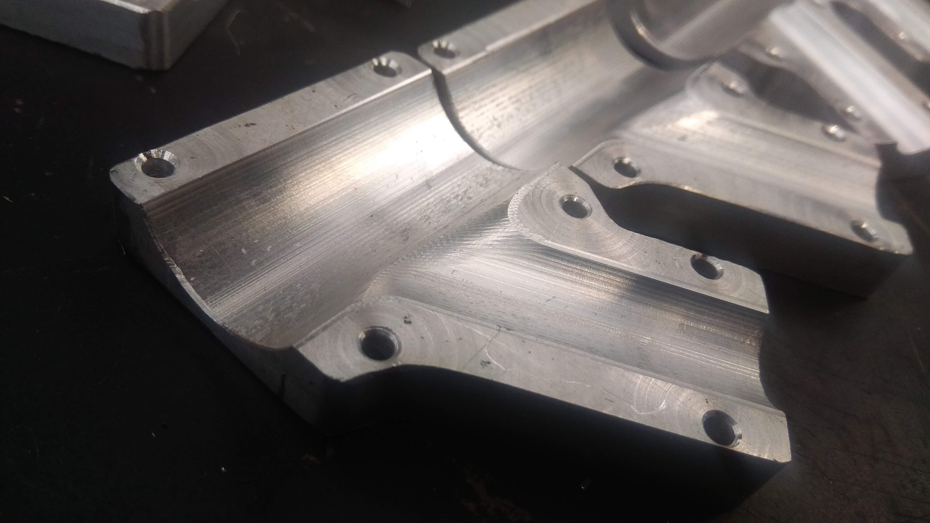

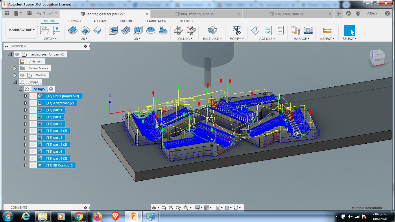

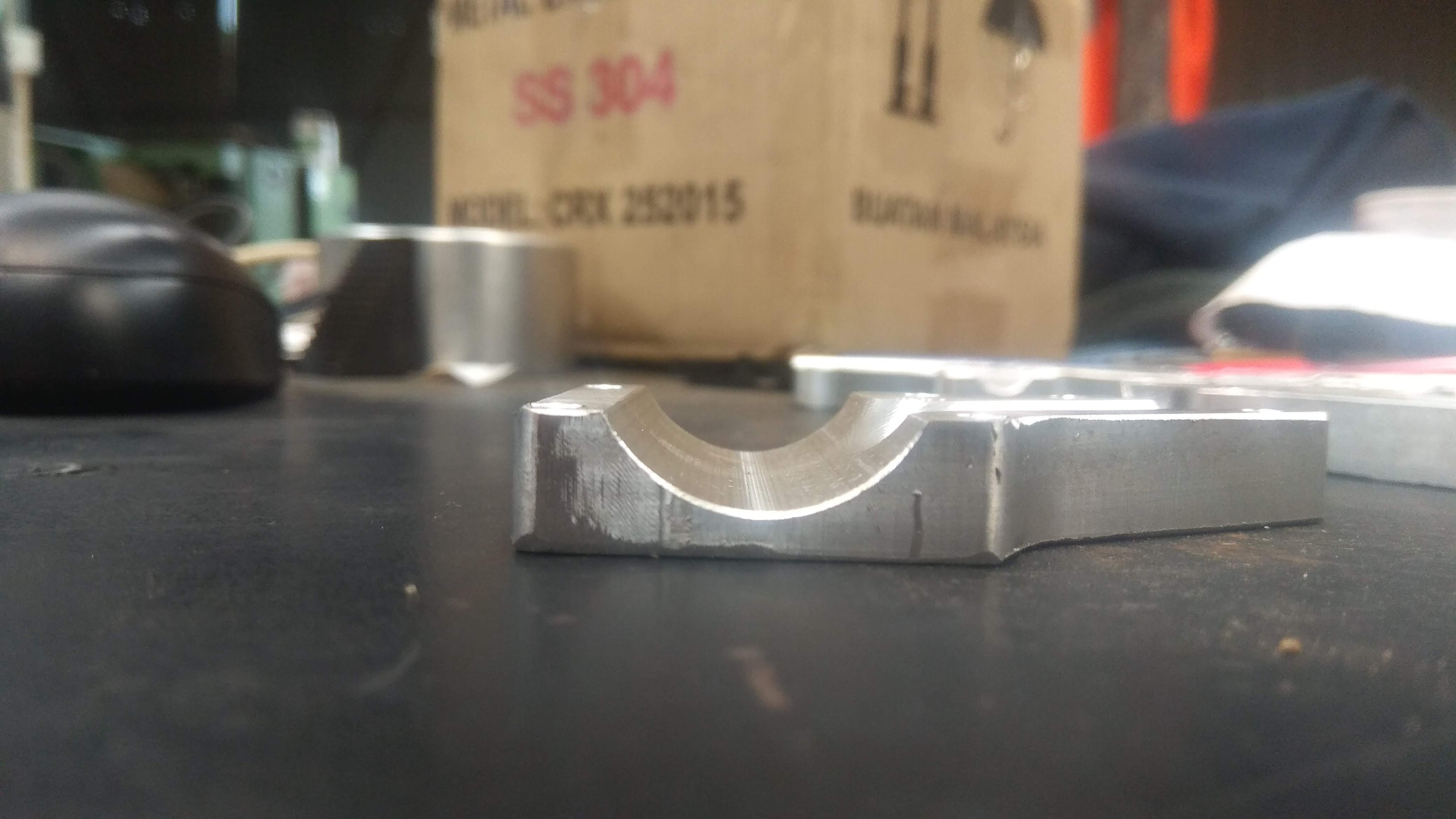

03 Jun 2020 01:58 - 03 Jun 2020 02:06 #169903 by Becksvill
here are some more photos of the finished parts
they are definitely not perfect and I would change how I did it next time but the mill worked without a fault. pretty happy with it.
and here is a screen shot of the fusion 360 cam
I will try upload heaps more photos as time goes on just to show what linuxcnc can actually do on a decent sized cnc mill. I think it will be pretty cool
