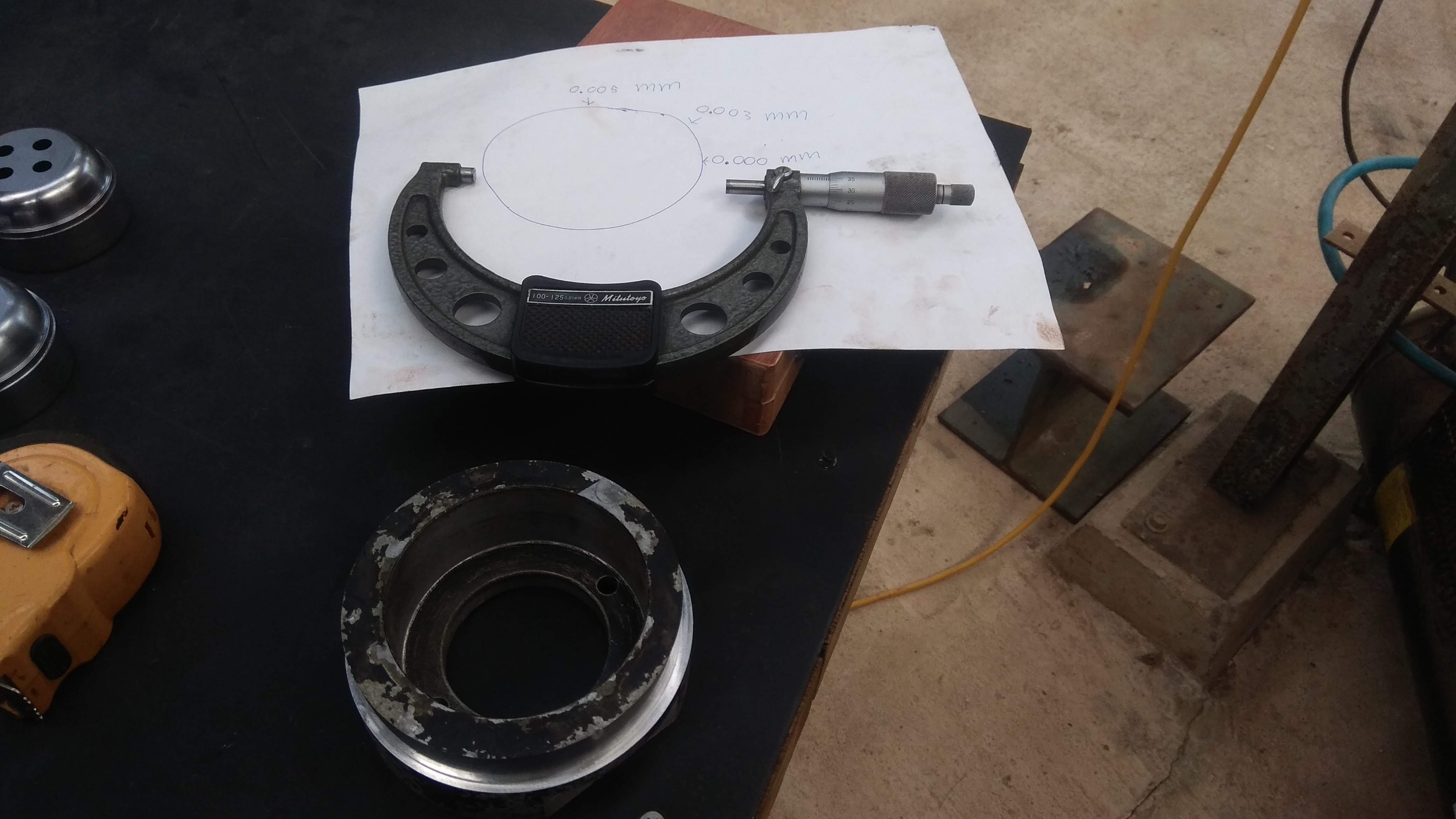

I did a accuracy test today to see how my servo tuning was. I have since found out that I actually need to change some parameters but the accuracy was still pretty good.
at 300 mm/min finishing speed with a 0.05mm cut 20 mm deep and a nice ultra sharp carbide endmill for alloy I milled a 110 mm circle and measured it afterwards.
It came out definitely within 0.01mm but possibly within 0.005mm of round when measuring all over with a mitutoyo mic
basicely it was close enough that it was hard to decide which side was the largest so pretty happy with that.
at 2000mm min the accuracy was still about 0.015 tops

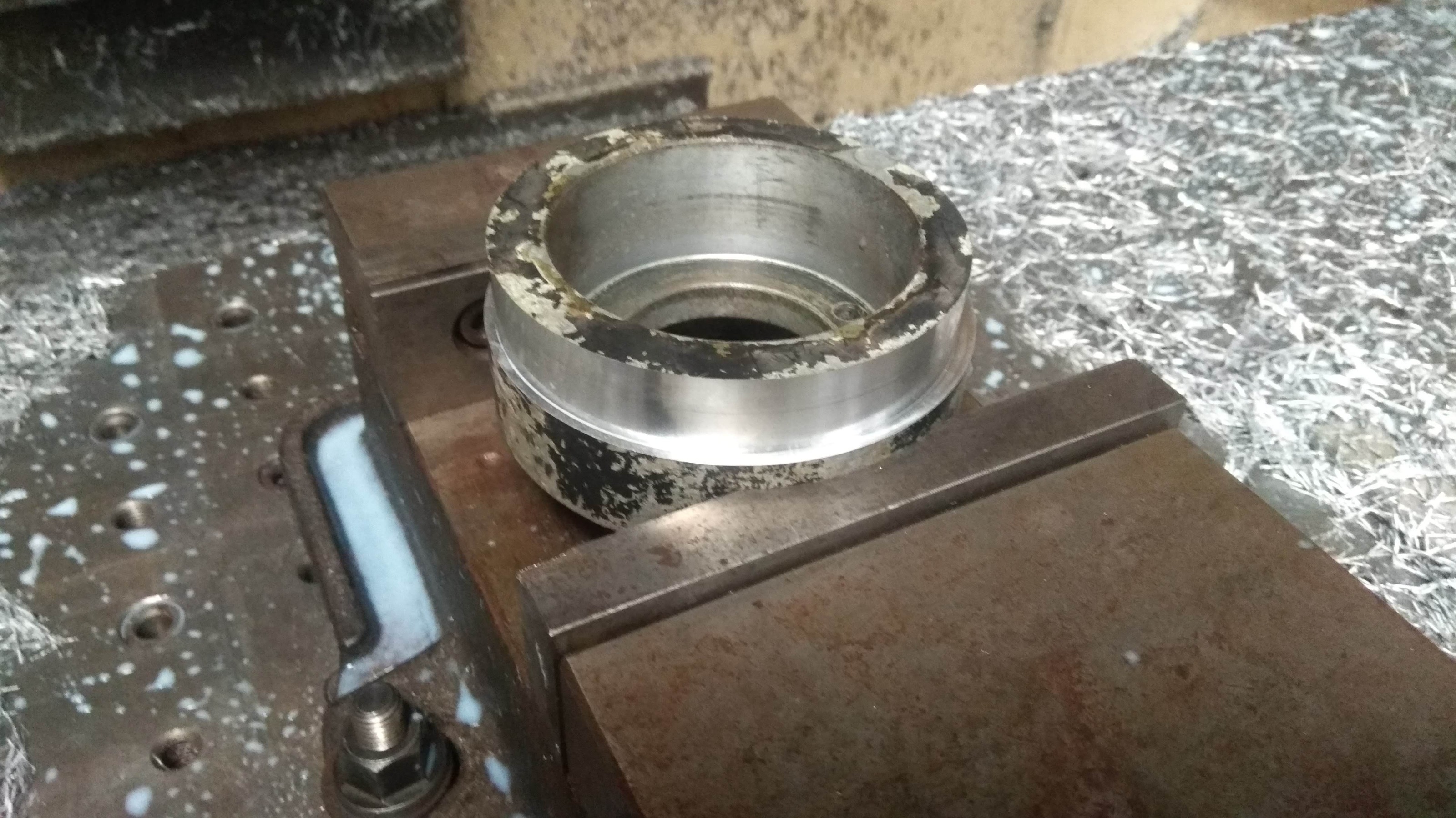

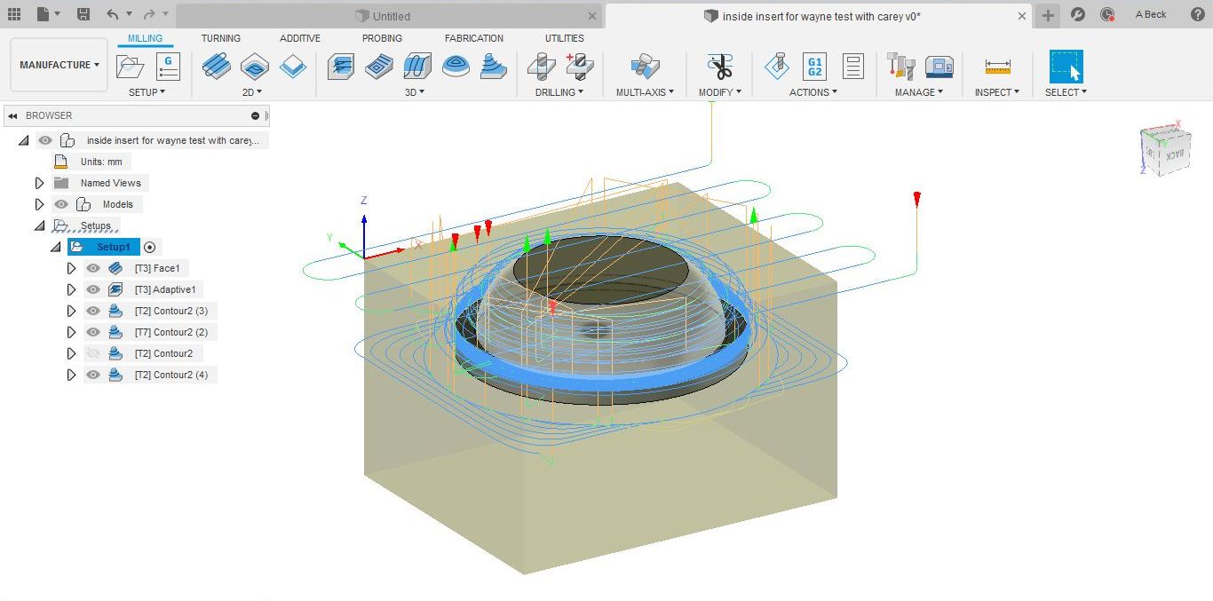

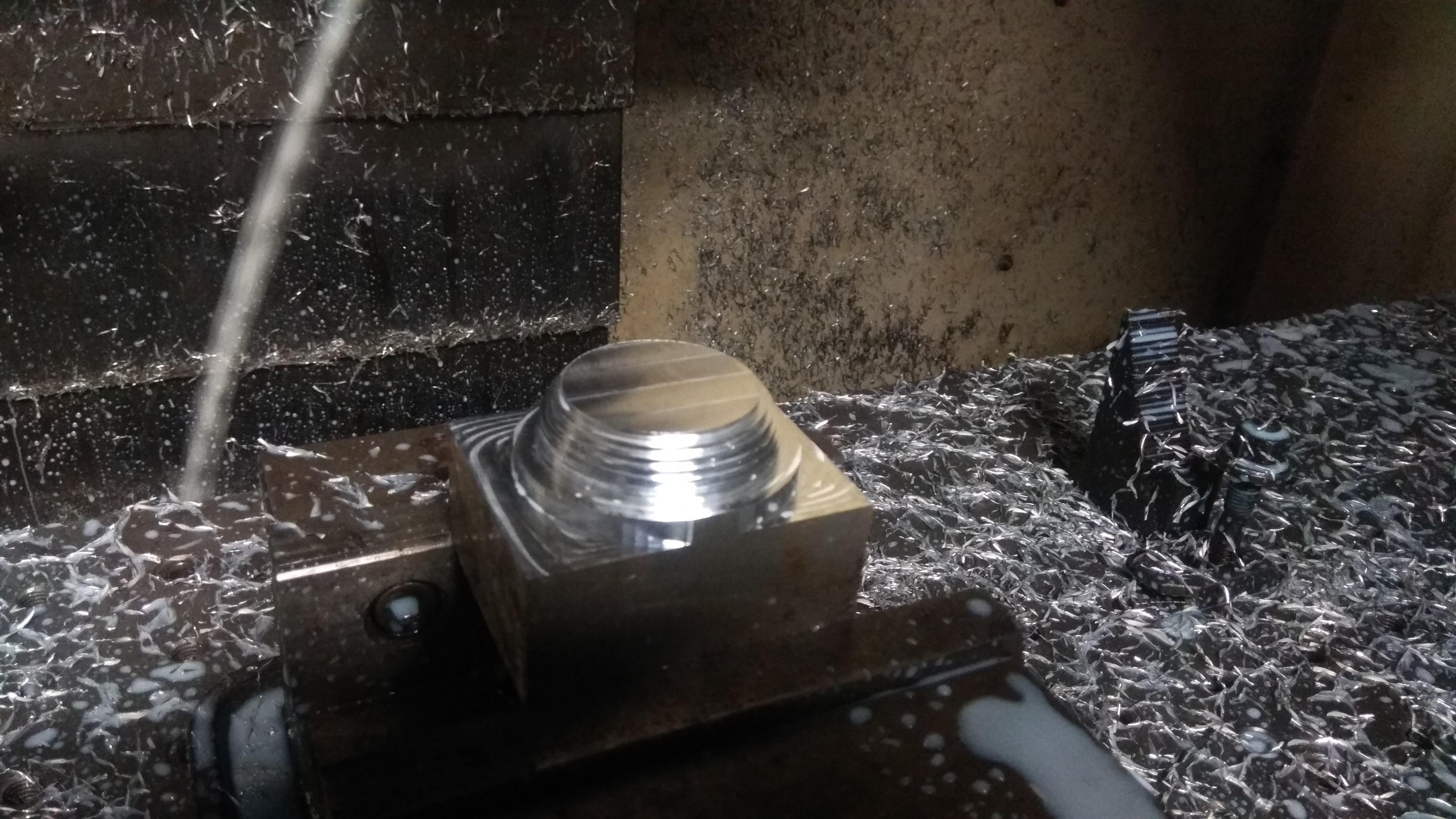

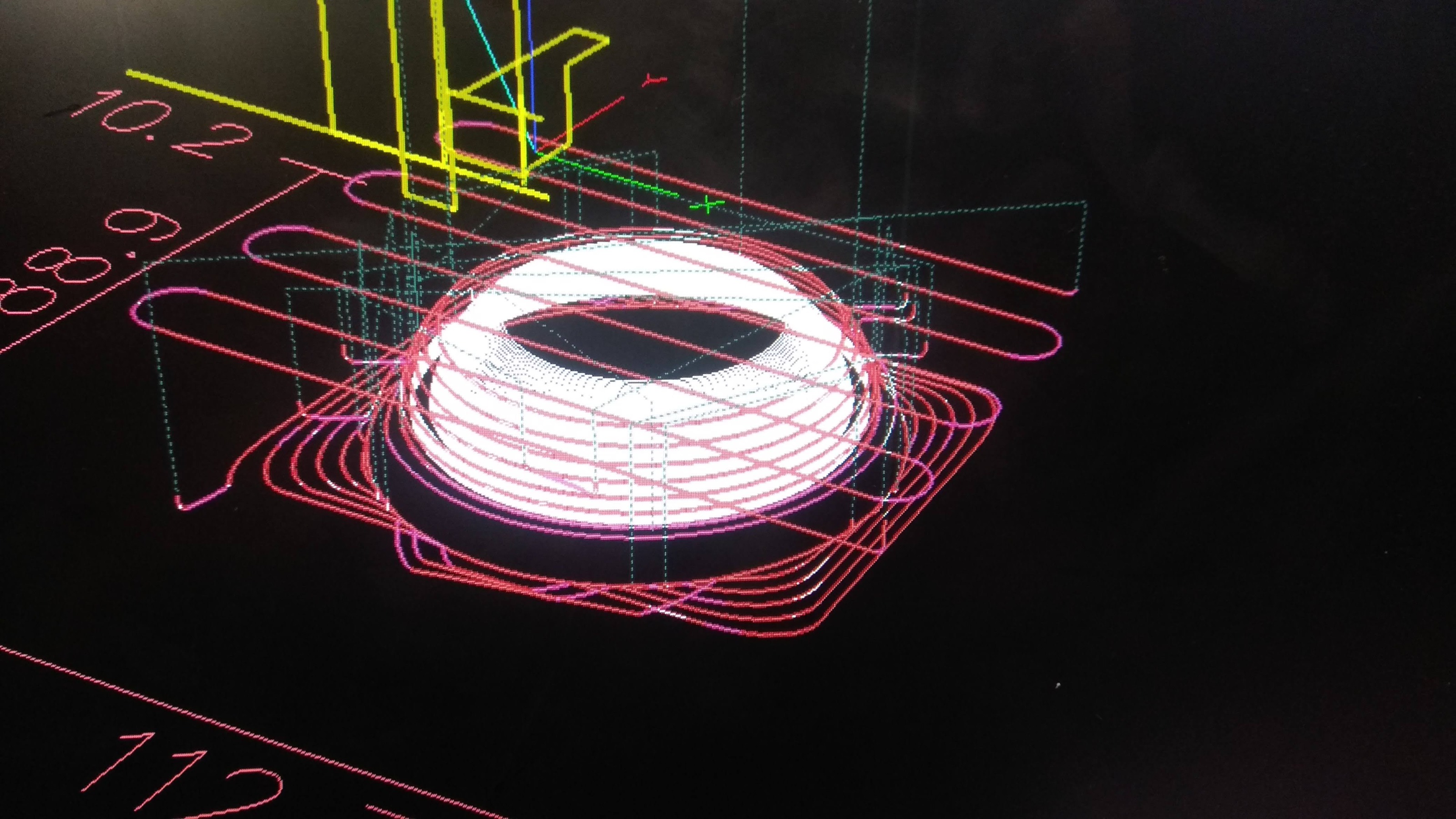

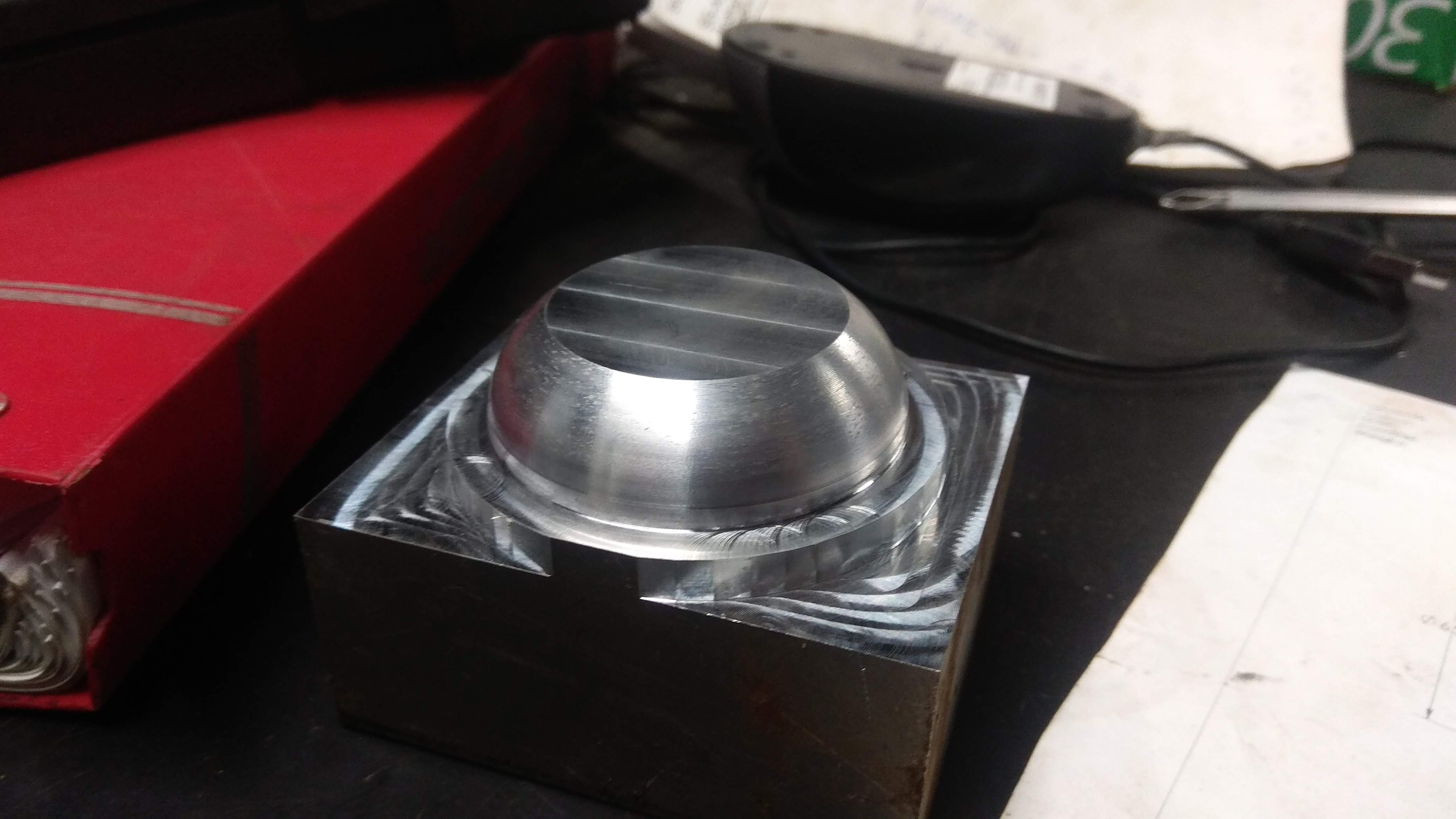

hey guys just some more photos here I am making a injection mold on my machine. and thought I would share some photos here of the processLinuxcnc doesn't get enough people taking photos of stuff they have made on big machines in commercial shops. this leads to many people thinking it is not capable enough for big stuff. But it totally is and I think I will keep posting photos here for the next person that comes along looking for a solution to fix there machine.

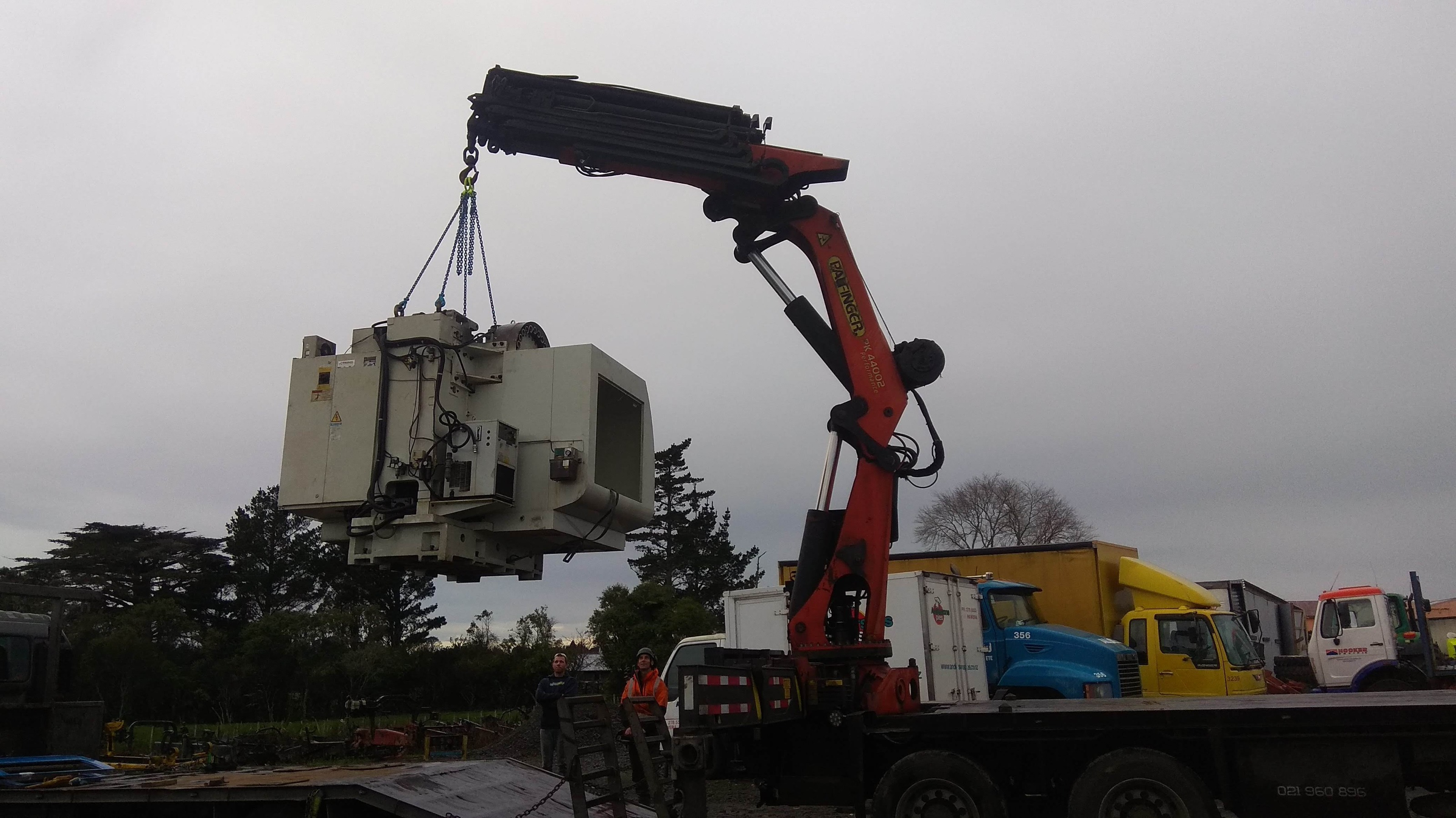

does anyone have any interest in some photos of how I move it down to my shed? it is coming 400 km away

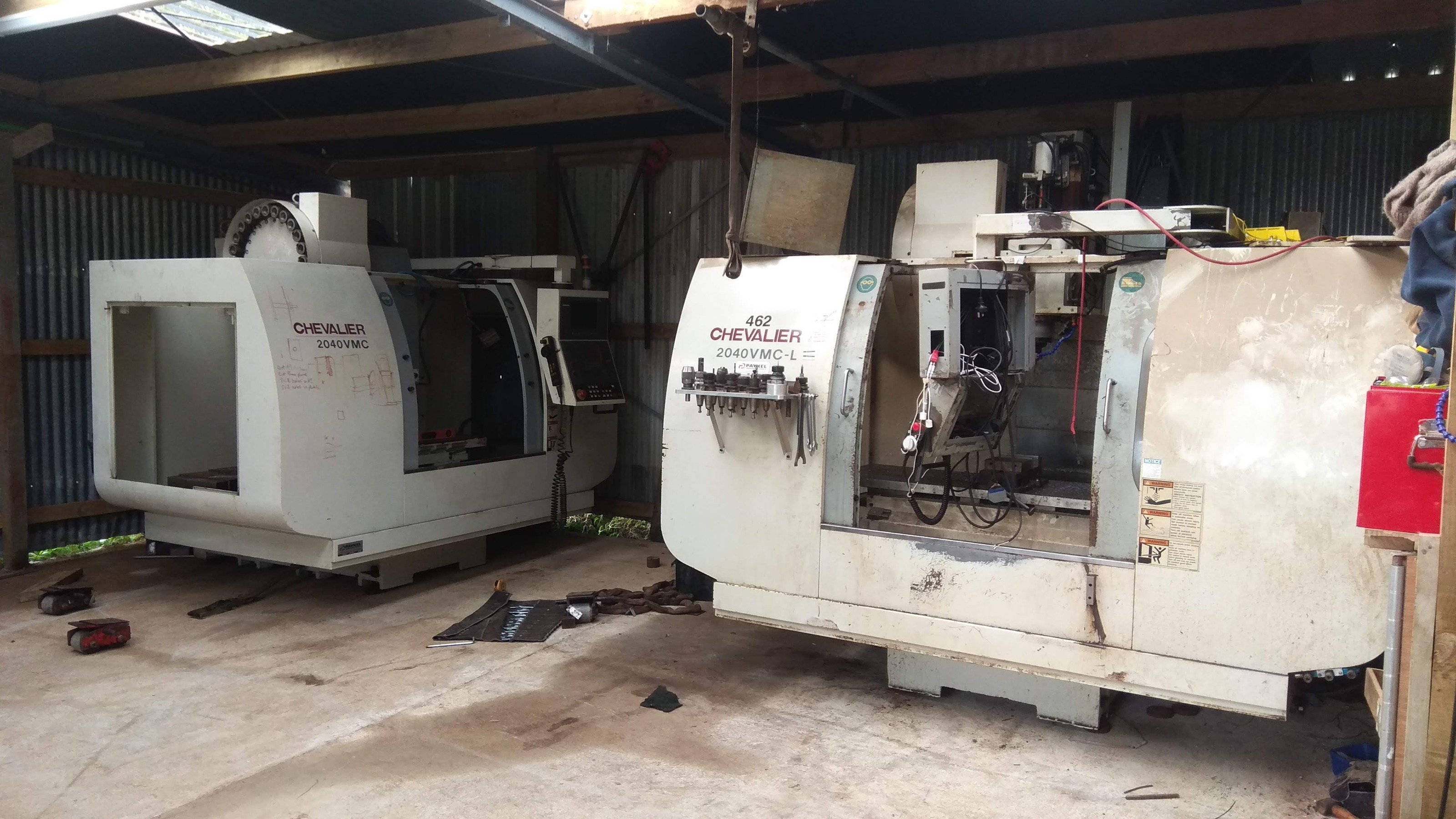

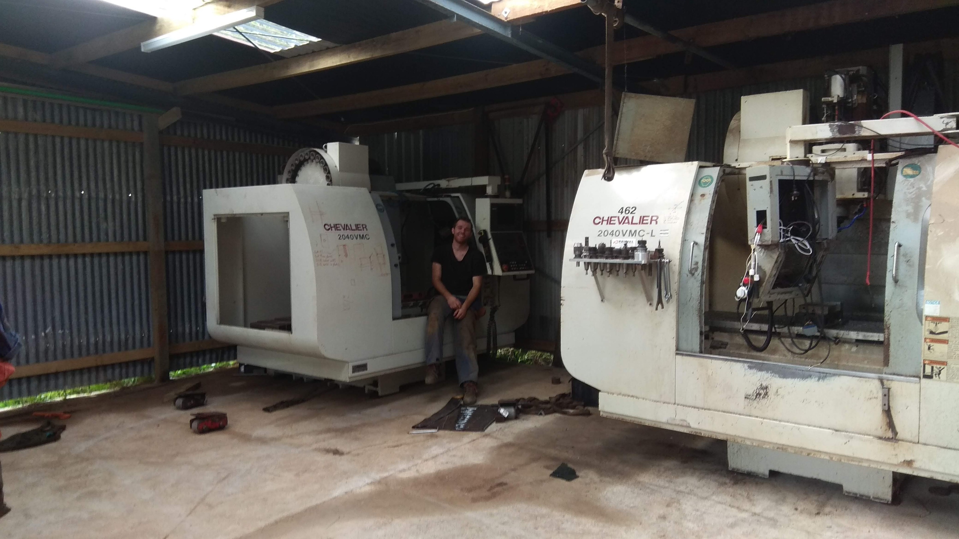

29 Jun 2020 21:34 - 29 Jun 2020 21:40 #173140
by Becksvill
Replied by Becksvill on topic Vertical Machining Centre Retrofit with Chinese Servo Drives Build Thread (NZ)

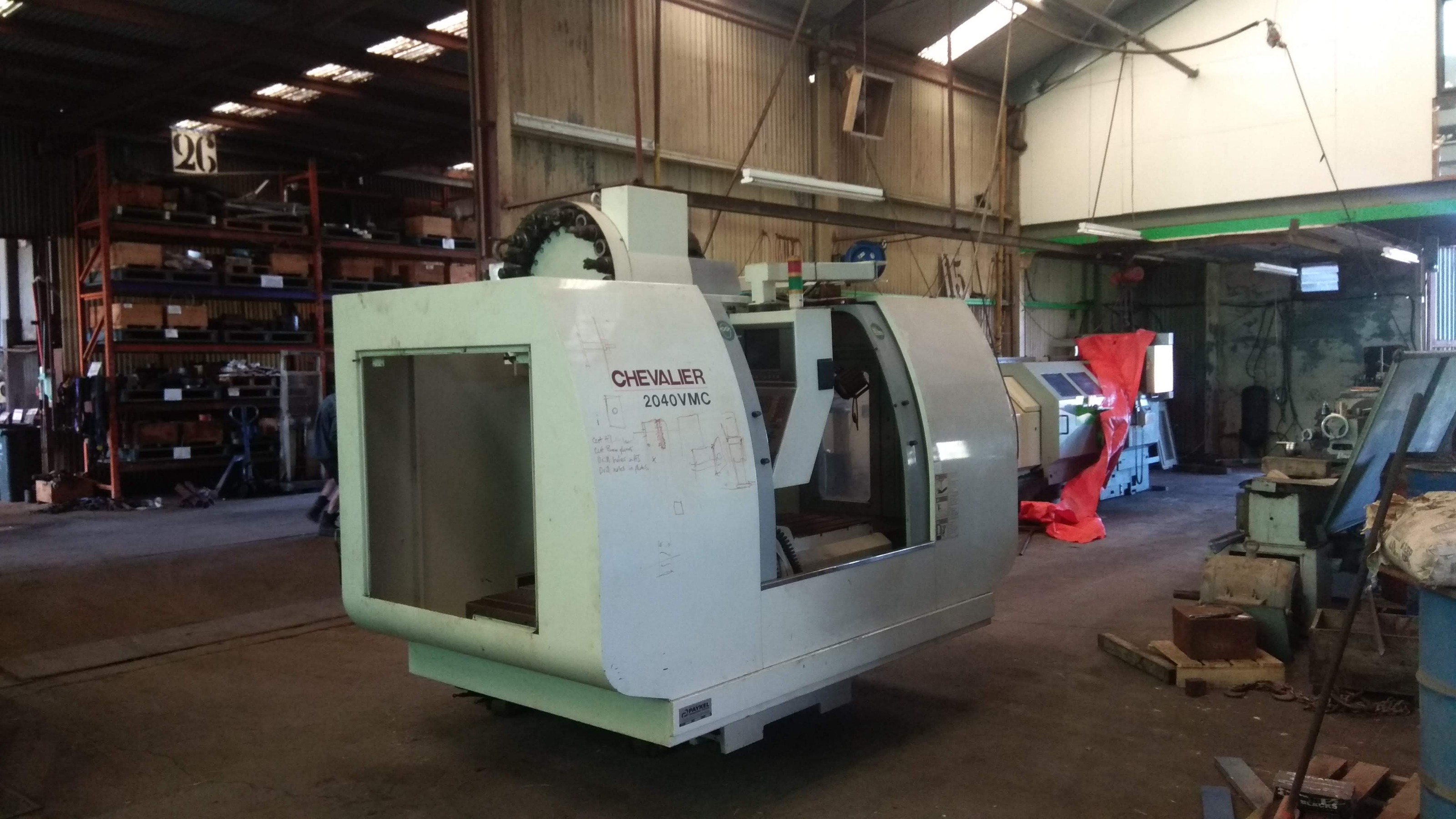

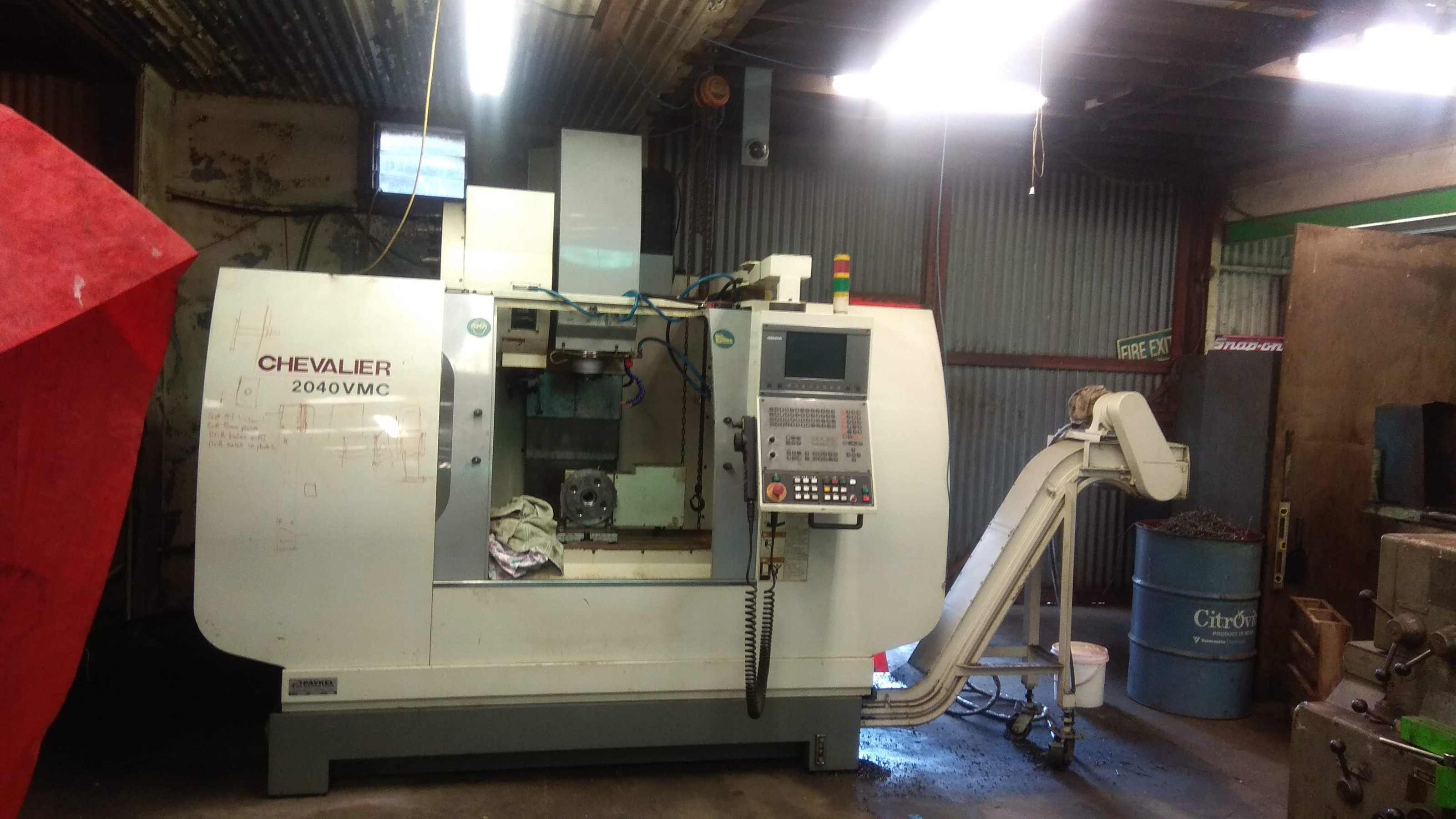

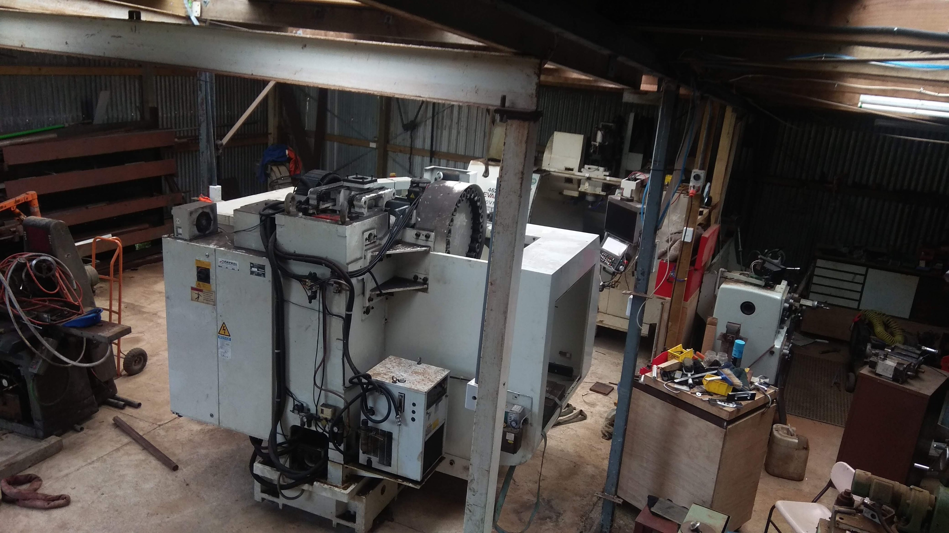

hey guys here are some photos of the new machine I bought. same heidenhain controller as last time. another project on the back burner for a few months lol
one thing about the new machine that i didn't realise at the time is the new machine has box ways.
my other machine has linear bearings on X and Y and box ways on Z
old box ways are a pain as you can't really fix them when they are worn out. But new box ways are much more rigid than linear ball bearings. so I will have a fast machine now and a rigid machine which is pretty nice
Last edit: 29 Jun 2020 21:40 by Becksvill. Reason: adding text to photo
