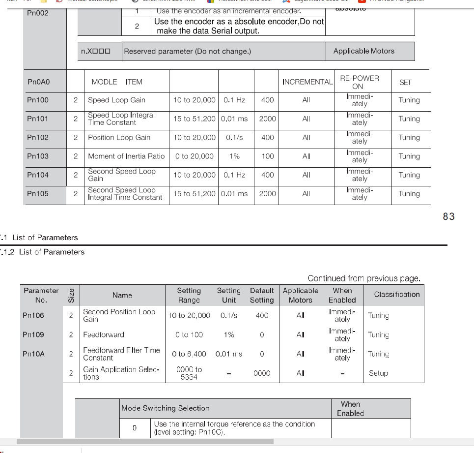

12 May 2020 21:42 - 12 May 2020 21:46 #167566
by Becksvill
Replied by Becksvill on topic Vertical Machining Centre Retrofit with Chinese Servo Drives Build Thread (NZ)
Hey Todd
the manual is written in pretty good english and the yuhai servo drives are basicly perfect copies of sigma2 or newer yaskawa servo drives I think. they have all the same gains and similar. The Bill at Yuhai has been really helpful and has given me lots of help. But is staying silent now. I don't know if it is the covid stuff in china and he is busy or he is just ignoring me.. But I kind of have to work it out myself now I think. have no trouble setting up the different parameters now though and doing whatever I want. there is a small lcd screen on the servo and 4 buttons that I can use to change anything I like. the tuning parameters can be adjusted easily that way.
So adjusting tuning parameters is not a problem. actually knowing what to adjust them to and making sure I am trying to graph the right signals is the problem
here is the relevant info in the servo drive manual about tuning. there is also 2 notch filters I can use that are not shown here. I was watching a yaskawa sigma 7 servo tuning tutorial and the info is sort of similar just I only have access to the actual parameters(no tuning software)
here is a link to the whole manual if you are interested but it is a pretty big manual
drive.google.com/open?id=1B_hC1_C8CejWU2ZDqxzp11reUN28kEXF
I am getting pretty good at connecting Hal signals to scope whatever I want to now.
I have worked out that my servos have 3 tuning loops in them.
there is the Torque PID loop. that is set at factory by a motor code that you set in the software.
next is the velocity loop. I have to set this
finally there is a position loop. which I can set
as you will see from the image above there are 8 tuning parameters I think.
currently I am commanding a move in linuxcnc and the 7i76 sends a whole bunch of step pulses to the drive. I think that means that the position and the velocity loop need to be tuned at the same time which may be a problem maybe I need to jog the servo internally instead and try tune the servo loop that way. but then I loose Halscope as I can't map the velocity error. also I am not sure what set s the acceleration in the drive. there are no acceleration parameters that I can find just the speed loop gains. I am wondering if they are how I set the acceleration in the servo. as I have read here that it needs to be slightly higher than the acceleration in linuxcnc the servo drive can keep up.
anyway if you have any hints I would appreciate it.
regards
Andrew
regards
Andrew
Last edit: 12 May 2020 21:46 by Becksvill. Reason: adding servo drive manual

14 May 2020 03:14 - 14 May 2020 03:33 #167700
by Becksvill
Hi guys
(ps for those that don't want to read the whole message here is a question for you... what does a torque ripple look like?)
Got a update for everyone here.. I have been having some sort of success with my tuning efforts after 3 days and about 30 hrs mucking around with values haha. I am getting a feel for what works.
feed forward was a very important parameter to increase. It is at its max value of 100 percent now.
I have gotten the following error down to .03 mm at 8000mm/min rapid speed.
and at 1000mm/min feedrate the max following error is 0.0018 mm though there is a spike up to 0.005 mm at the very start.
But as the video shows I am getting a annoying noise at low speed. I am not sure what it is, but changing the tuning values doesn't seem to change it too much. I assume it is high frequency harmonics. I have tried changing the velocity gain and also tried changing the position gain but haven't had any success. also I tried changing the velocity speed intergral time constant ( I think this is the same as Intregral) changing it to all sorts of values. I haven't brought them all down together...
apart from the sound the tuning in pretty good and I am happy with it. once I close the loop properly to linuxcnc with the 7i89 encoder board I might use a little bit of (intergral) to cut down any last little errors.
On these servos I have very high ppr absolute encoders that can output a incremental encoder pulse at whatever PPR I choose. So I started at 2500 ppr then changed to 10000 ppr
and finally I have changed to 25000 ppr which the mesa card seems to handle fine. remembering that is is quadrature signals and gets multiplied by 4 in linuxcnc. so that is 1,00,000 ppr (running through a 16 mm pitch ballscrew. so divide the total ppr by 16 to get a scale of 6250 which counts fine.
I saw someones reply on the emc user list and he was running a 7000 ppr encoder at 3000 rpm so I thought so long as I stay under that I will be fine..
But the higher encoder count seemed to stop encoder dithering I think. just that last little bit of accuracy not that it is really needed but it was just a parameter lol and the resolution was there free for the taking.
Currently at 8000mm/min max rapid my machine servo motor max speed is only 500 rpm and the servo max rated rpm is 1500 rpm so I can go quite a bit higher with the rapids if I want. It seems fast enough for now though
accelerations are set at 1500 mm/s2 I think in the ini file
But this high pitch harmonics would be really nice to get rid of! I know I can turn everything down but that will stop my nice and close position loop. and am definitely a fair way away from any bad oscillations. I turned the gains up for fun and that experience was a fair bit different than this sound.
Is it possible that I have a torque ripple?
or can you suggest any ideas to reduce the noise and harmonics. I have some notch filters that I can use on the servo drive but initial testing just seems worst.
regards
Andrew
regards
Andrew

Just a little confused, at one point it seems like you are talking about a servo driven spindle, then you seem to be talking about tuning an axis. Which are you talking about, a spindle or an axis? Are you using step/dir as the control signals? If so how fine do you have the step resolution set in your servo? I would suggest setting it at least as fine as the encoder resolution output to Linuxcnc including quadrature.
(PS: I did not see any servo tuning instructions in the manual you posted the link to. They may be in the manual for the tuning software,)
