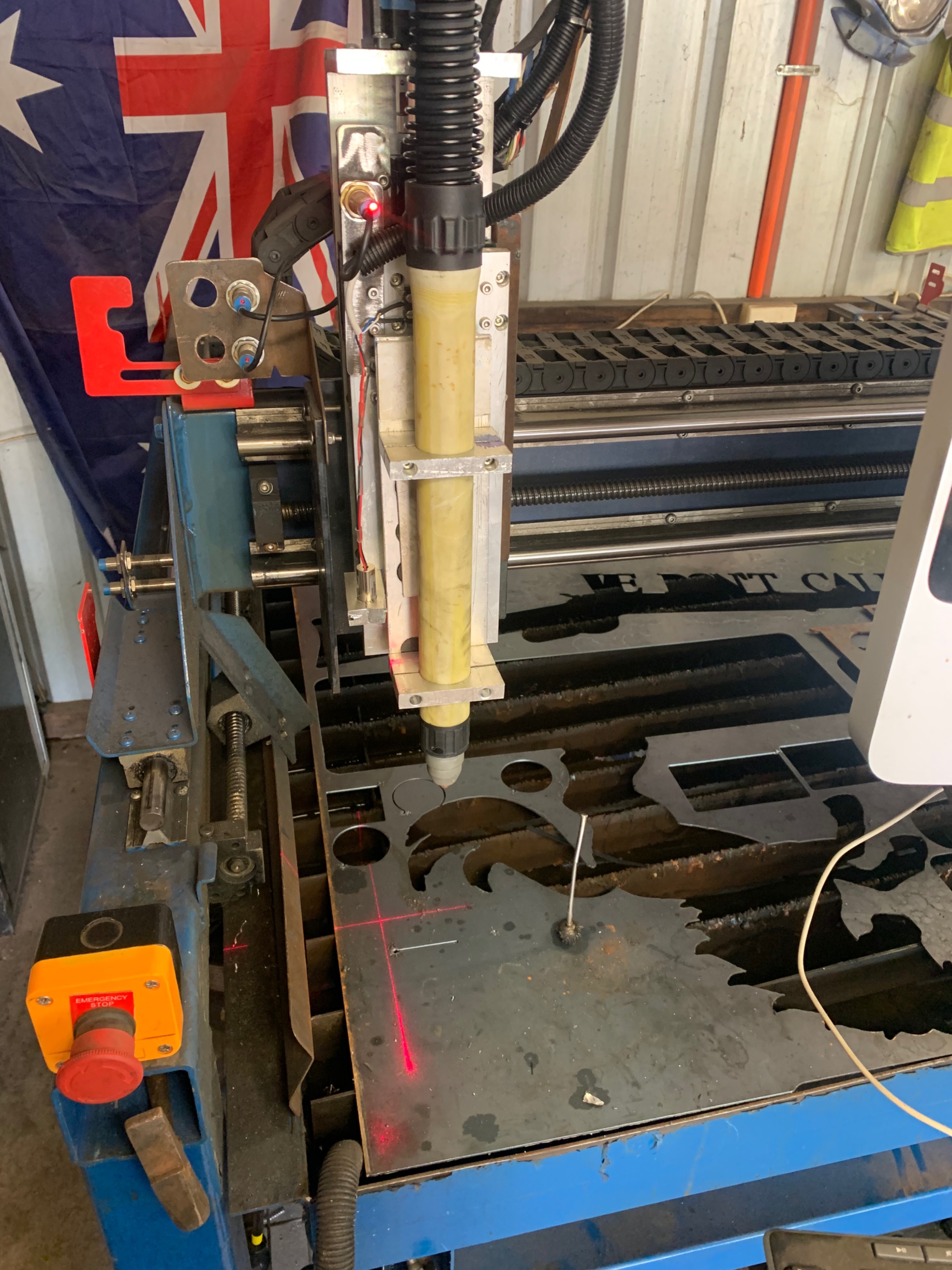

27 Dec 2021 05:13 #230041
by RNJFAB
Replied by RNJFAB on topic Homemade, cheap, plasma CNC
So post Christmas update 2021.
TB6600 stepped drivers getting bit funny in the heat of QLD (35+ deg C in the shed with 99.997% humidity).
New z axis has been completed, tested and is working - pictures to follow shortly. New torch also added to make life easier. 160mm travel.
New laser is in and linked to a button in the GUI. Offset all worked in to zero off laser point. Offset also worked out for framing as part of QtPlasmaC.
Still haven't worked out spotting in Sheetcam, or how to se the tool from QtPlasmaC instead of Sheetcam. Must need to watch more video's.

27 Dec 2021 05:19 #230042
by RNJFAB

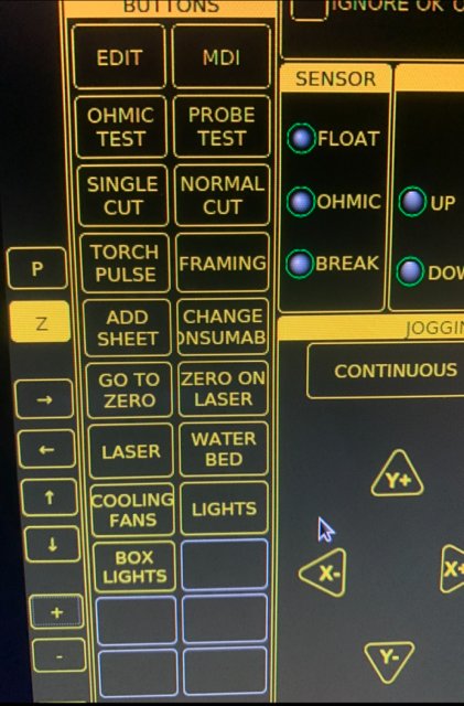

27 Dec 2021 05:25 - 27 Dec 2021 05:36 #230043
by RNJFAB
Here you can see some of the buttons that I have set. These just make my life easier in the way that I use my CNC.
Add Sheet - moves plasma to the back left to allow me to load a new sheet of material.
Change Consumable - Moves plasma to middle of bed right at the front to allow me to change consumables.
Go To Zero - Go to where the machine has been zeroed
Zero On Laser - zero on the laser pointer (still not working 100% of the time - if a job I loaded it doesn't work correctly)
Laser - Toggle the laser pointer on/off
Water Bed - timed button to fill the water table. ensuring the table doesn't overflow. and making sure I don't forget to turn the pump off.
Cooling Fans - turn the fans on in the control box.
Lights - Turn on lights around machine to help me see (not fully hooked up yet)
Box Lights - Turn on lights in control box (not fully hooked up yet)
