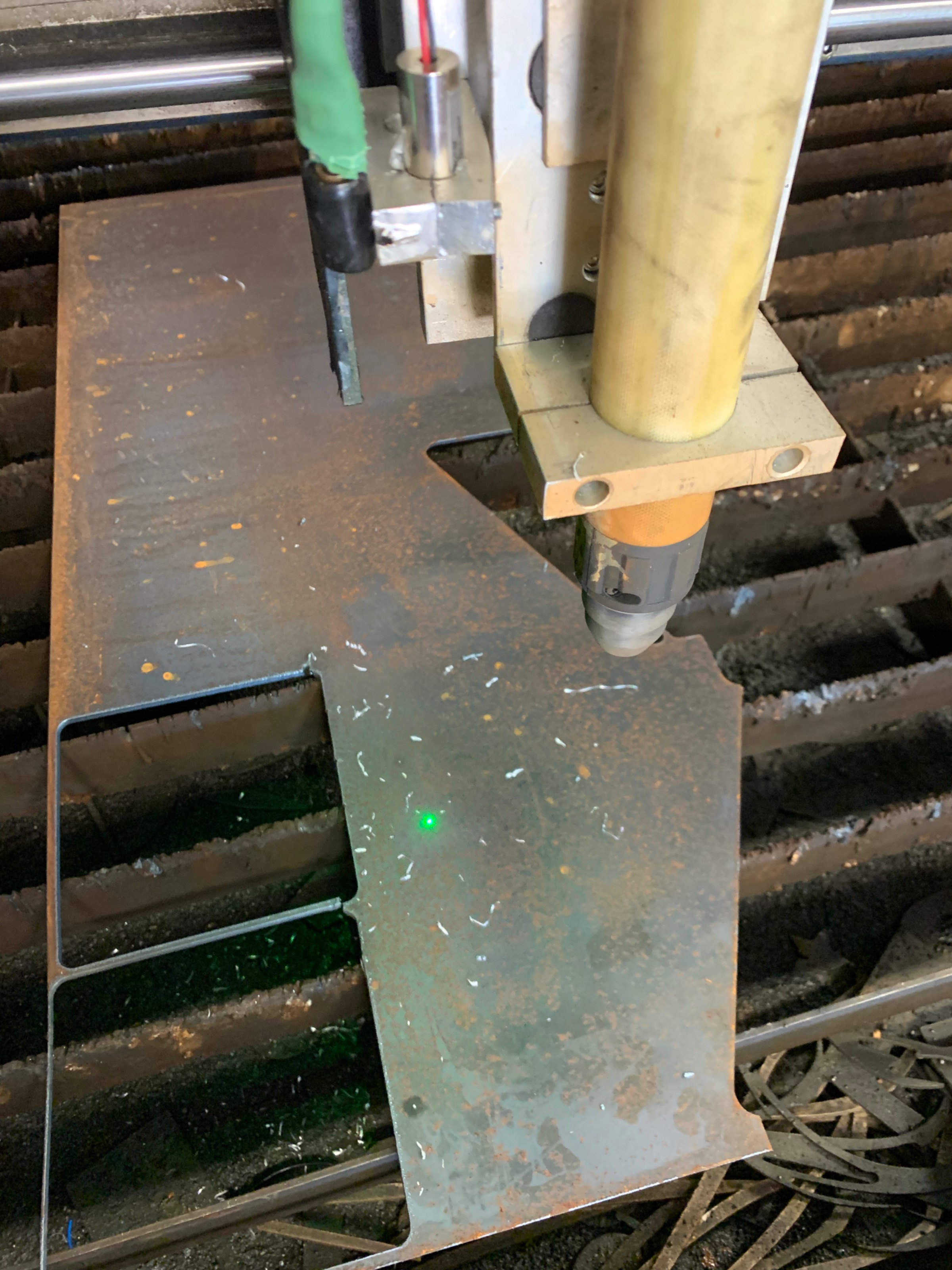

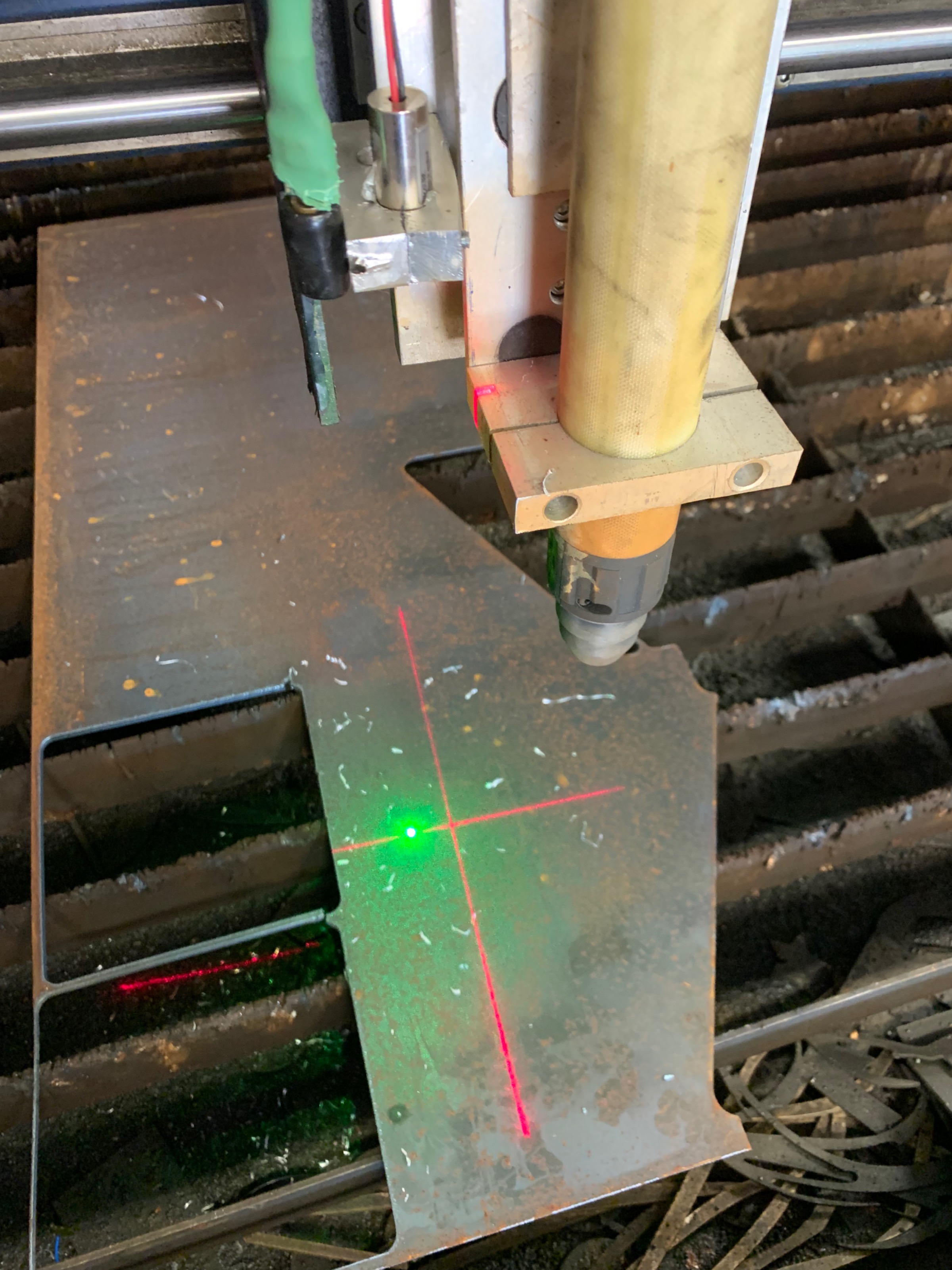

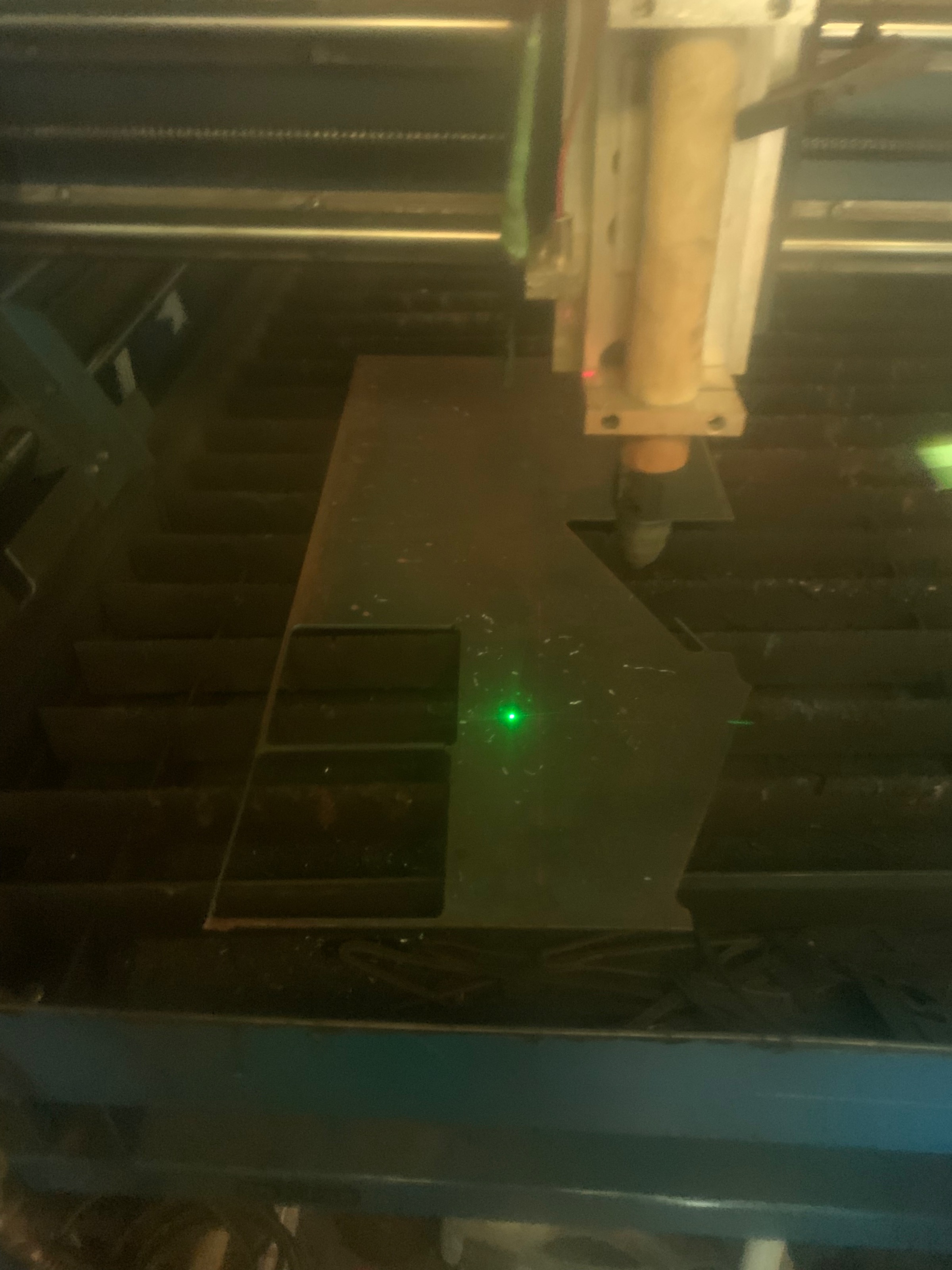

Thanks Phillc54,
I'm actually up to doing this now. I'll see if I can set it up with the red laser as that is when I would use it.

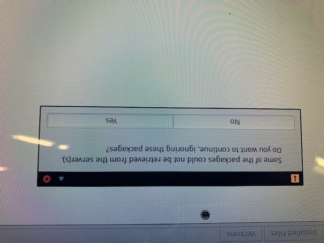

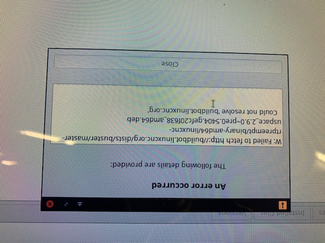

I did try the update but it failed. I'll try and upload the error for you.

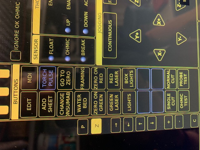

Below is my current button configuration, I still need to work on my g codes as they don't quite work the way I want them to.
Red and green laser are used at different times, red laser for setting up and getting ready, green laser to find new 0 point when I'm working through cuts. The green laser is to bright without my welding mask on, and you can't see the red laser when I'm wearing the welding mask. So each has a purpose.

The Buildbut has hung for several hours so there won't be much in the way of updates in any case.
buildbot.linuxcnc.org/buildbot/waterfall
Replied by phillc54 on topic Homemade, cheap, plasma CNC
That looks like your internat connection may have an issue.This is the error I got updating.
