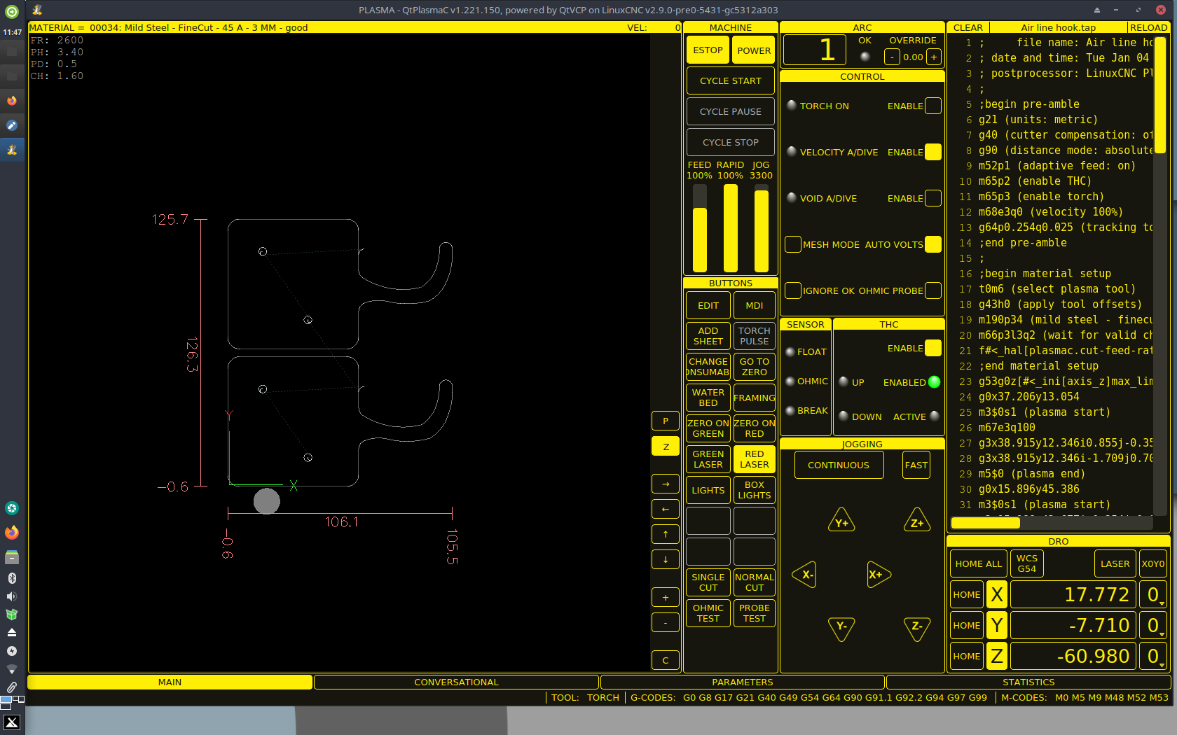

[attachment=42735"]zeroonlasersometimes.png[/attachment]

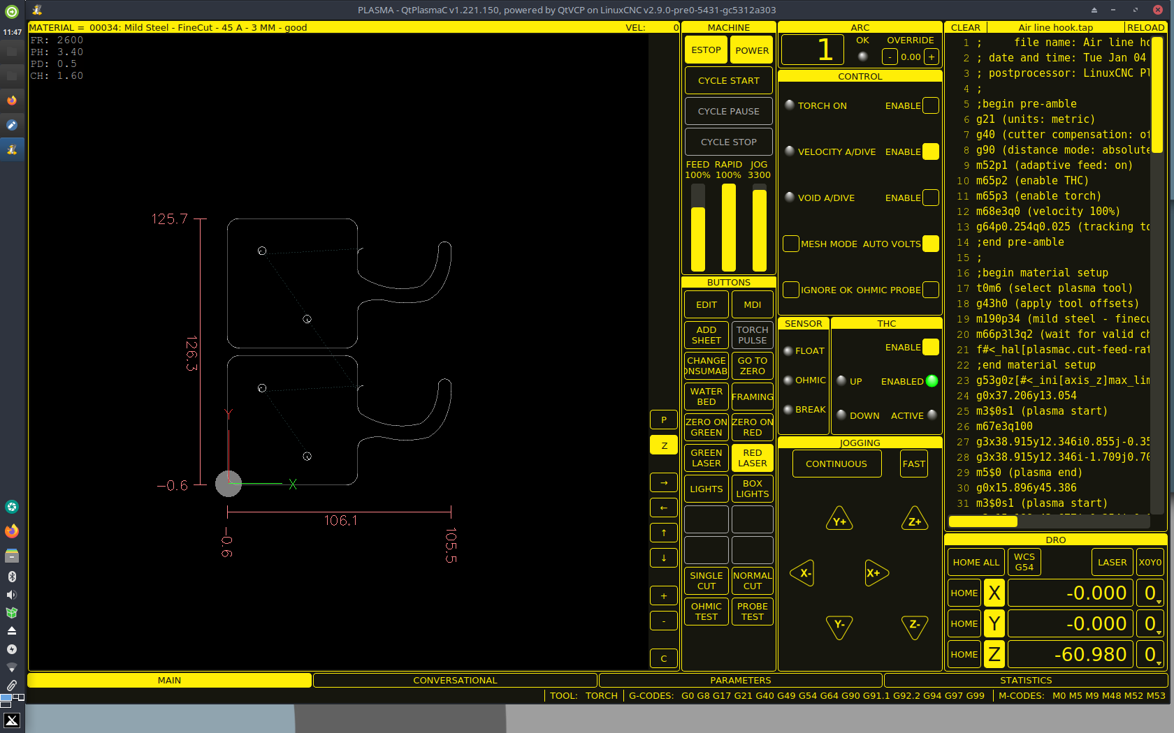

Feedback = works great.... most of the time. Initially it worked, then i loaded another file and re-zeroed and this happened.
Note the torch didn't go all the way to zero.
However, I was able to push my 'GO TO ZERO' button and it moved to the correct spot.
Yes, using sheetcam. I didn't realise that you were editing each code after setting it up. I have done this and it works a treat. Ovbiously it wont work for everthing, however it will be handy for some parts I just cut from scrap, now i can use whatever material I have. Cheers

Try this button code, it ought to do what you're after (at least it did in a sim here
BUTTON_7_NAME = ZERO ON\GREEN BUTTON_7_CODE = G10 L20 P0 X69.533 Y-9.724 \ G0 X0 Y0 BUTTON_8_NAME = ZERO ON\RED BUTTON_8_CODE = G10 L20 P0 X58.064 Y-25.190 \ G0 X0 Y0
Without seeing your g-code, assuming you're using the sheetcam post, if you remove these two lines from your g-code, you should be able to run whatever material is selected in the drop down above the graphics preview window:
(note that the lines may not be exactly this, and that XXX is the material number)
m190pXXX m66p3l3q2
That ought to do it, but be sure to report back!

I do see in the code what causes your G0 X0 Y0 to not finish its move, a fix will be upcoming. I'll try to remember to drop a line here to let you know when to update.
