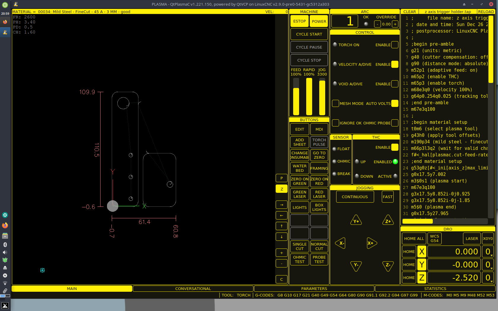

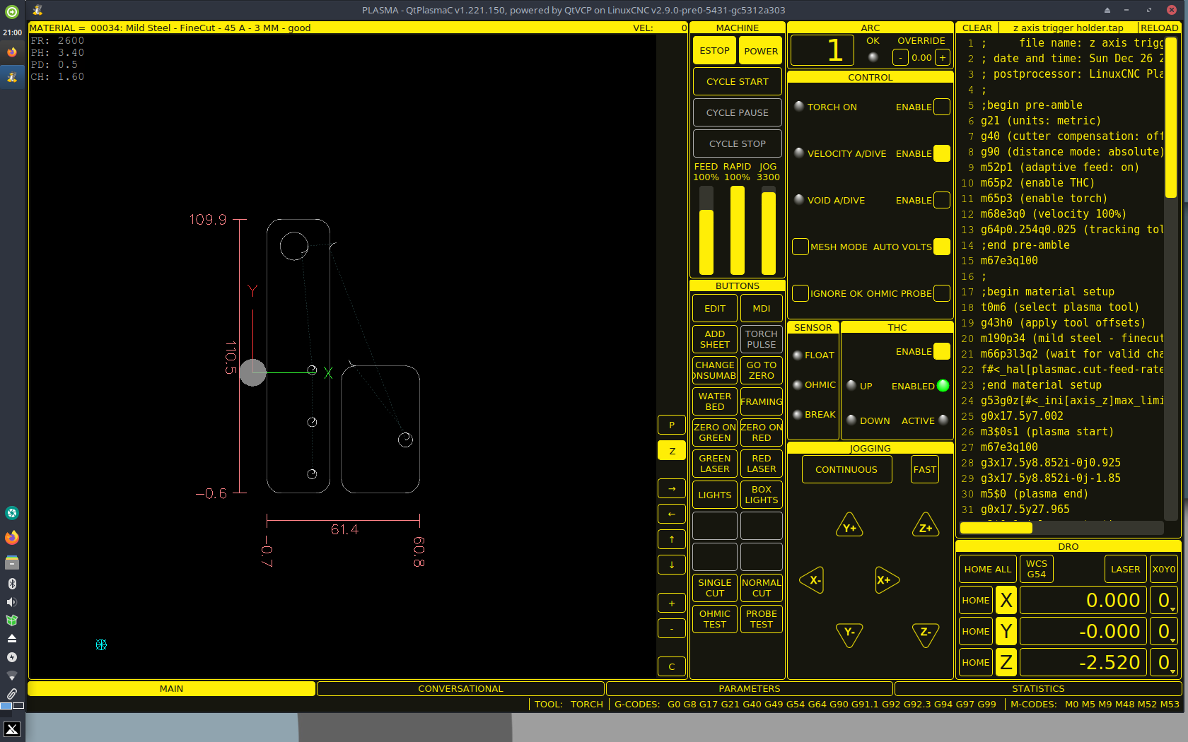

Tonight's problem, brought to you by the bloke in the shed who still has no idea.
When I first zero the machine off then open a cut file I get this.
Then if I zero on the laser button (I created)
Now if i close the file and reload it (and any file after this) it will always setup like this
I have tried to re home and zero, however every time i load a file it will align like this.
What have I done????
- phillc54
- Posts: 5711
- Thank you received: 2100
06 Jan 2022 11:11 #230937
by phillc54
Replied by phillc54 on topic Homemade, cheap, plasma CNC
What is your laser touchoff code?

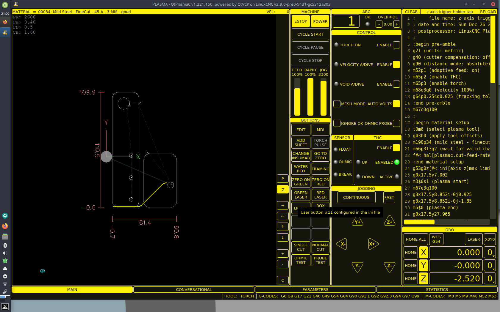

- Posts: 12156
- Thank you received: 4149
06 Jan 2022 11:14 #230938
Replied by rodw on topic Homemade, cheap, plasma CNC
Sometimes linuxcnc's persistent g code variables get corrupted, particularly when setting up a machine.
It has not happened to me for a long time.
You could try deleting metric_parameters.txt in your config folder.

06 Jan 2022 11:19 #230939
by RNJFAB
Replied by RNJFAB on topic Homemade, cheap, plasma CNC
BUTTON_7_NAME = ZERO ON\GREEN
BUTTON_7_CODE = G92 X0 Y0 \ G0 X-69.533 Y9.724 F800 \ G92 X0 Y0
BUTTON_8_NAME = ZERO ON\RED
BUTTON_8_CODE = G92 X0 Y0 \ G0 X-58.064 Y25.190 F800 \ G92 X0 Y0

- snowgoer540
- Posts: 2580
- Thank you received: 907
06 Jan 2022 22:11 #230991
by snowgoer540
Replied by snowgoer540 on topic Homemade, cheap, plasma CNC
Try this button code, it ought to do what you're after (at least it did in a sim here
Without seeing your g-code, assuming you're using the sheetcam post, if you remove these two lines from your g-code, you should be able to run whatever material is selected in the drop down above the graphics preview window:
(note that the lines may not be exactly this, and that XXX is the material number)
That ought to do it, but be sure to report back!
BUTTON_7_CODE = G10 L20 P0 X69.533 Y-9.724 \ G0 X0 Y0
BUTTON_8_CODE = G10 L20 P0 X58.064 Y-25.190 \ G0 X0 Y0Without seeing your g-code, assuming you're using the sheetcam post, if you remove these two lines from your g-code, you should be able to run whatever material is selected in the drop down above the graphics preview window:
m190pXXX
m66p3l3q2 That ought to do it, but be sure to report back!
The following user(s) said Thank You: RNJFAB
