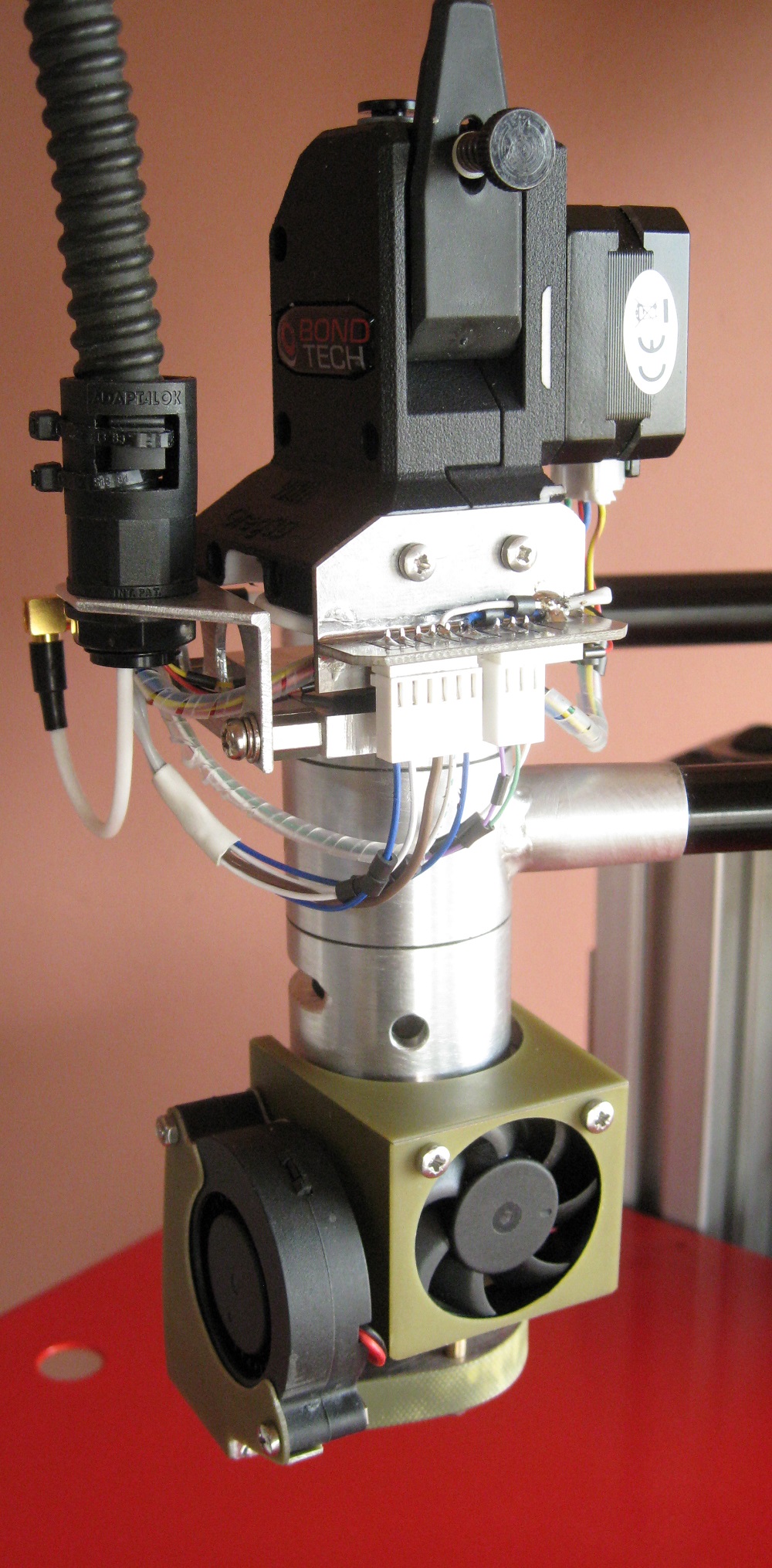

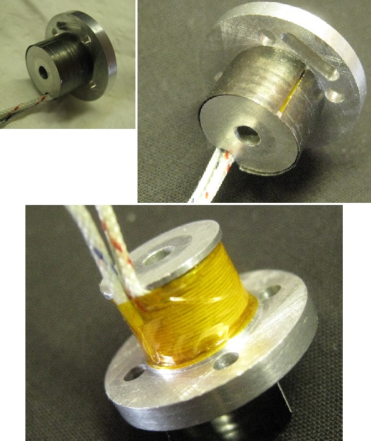

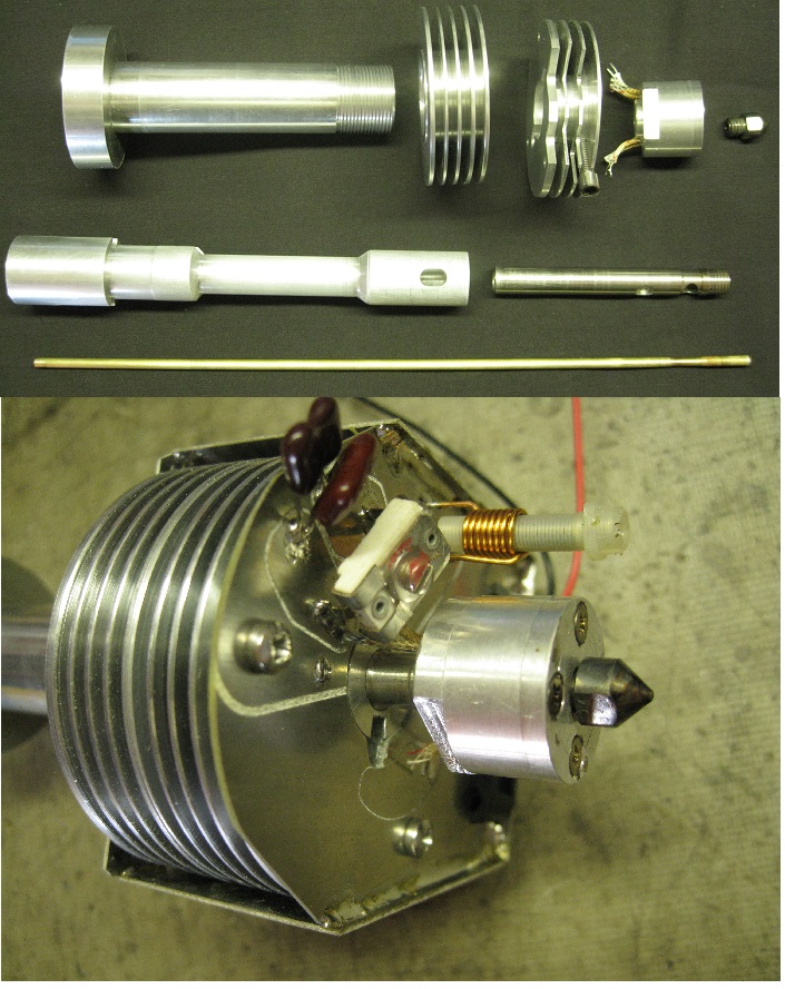

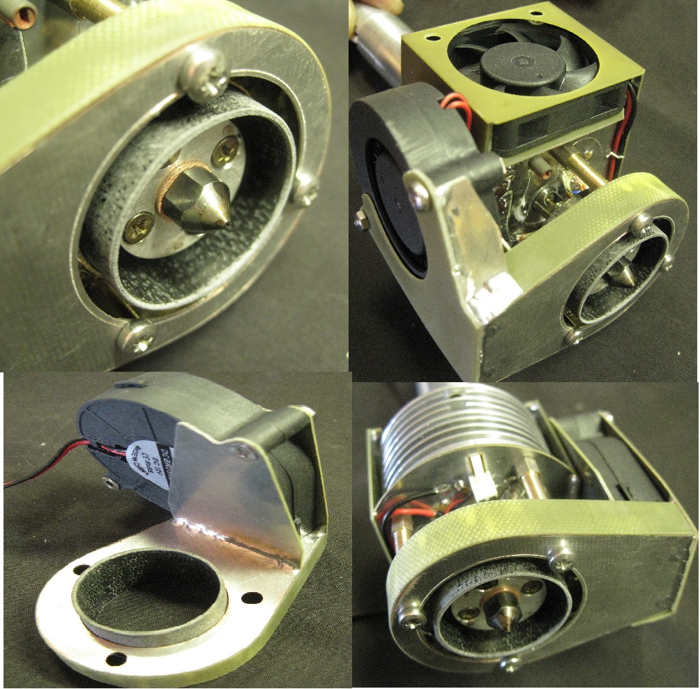

3d printer pics - Extruder hotend is induction heated..

26 Sep 2021 07:47 #221613 by Aciera
That 3D printer seems to have an interesting kinematic, what controller do you use that with?

26 Sep 2021 11:21 #221625 by NoJo
Well, again one of those things - I seem to do this stuff because I think I can - sometimes I succeed, sometimes I don't!

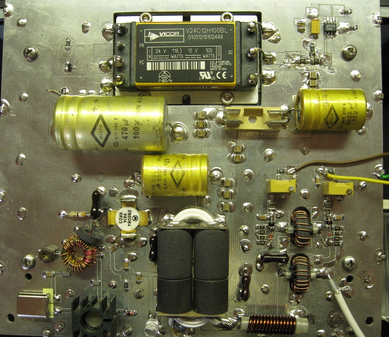

The controller is 'home made' - based on a Nucleo uController board - a sort of Arduino on steroids - 32bit cpu @ 80MHz. The software is also 'home made' - Reads  cartesian Gcode from Cura slicer - all done by my good Wife again - all the kinematics/reverse Kinematics and control. The hot end is an RF (10.1MHz) 80watt induction heated job - very fast, from 16deg C to 350decC in 5sec...
Why did I do it? As I said above, it was the challenge - I really have no need for a 3D printer - it has not been used since I proofed it!
