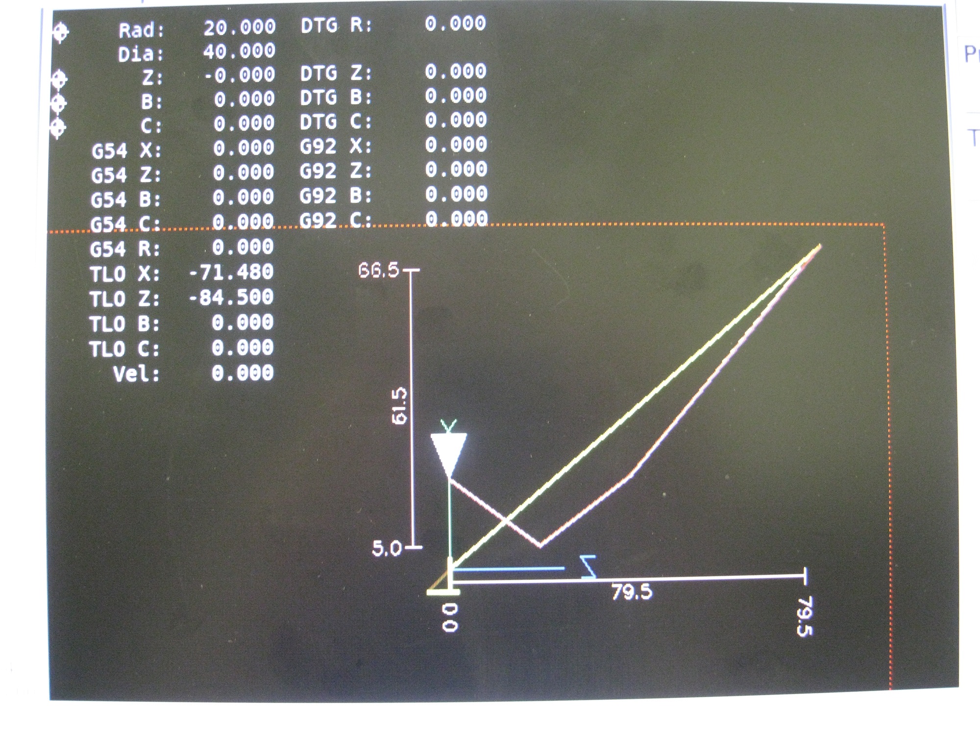

14 Oct 2021 13:49 - 14 Oct 2021 14:26 #223084 by NoJo
Linuxcnc lathe manages somehow to frustrate me at every opportunity..
I thought I had Tool Offsets under the belt..Not so it seems.

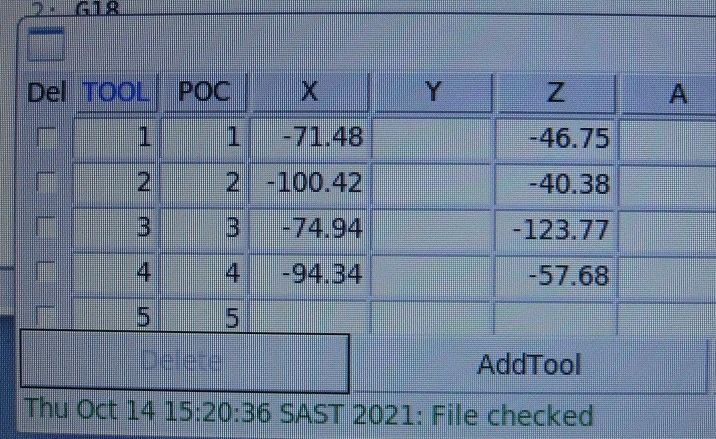

Lets use just one tool - I establish its offsets in X and Z OK - appears in the tool table as expected.
The lathe is back-tool mode, with it set so in ini as well.
Open Lcnc , Home all axes and load this Gcode file ( with appropriate setup G and M codes, etc)
G7
G18
G01 X40 Z40 F800
G01 X20 Z20 F800
G01 X40 Z0 F800
M30
Display looks like this:
(262)
Then Single step the Gcode - after the T1 M6 G43, display looks like this with the workspace aligned inside the red work area.:
(267)
Continue single step and all is well, - file completes OK.

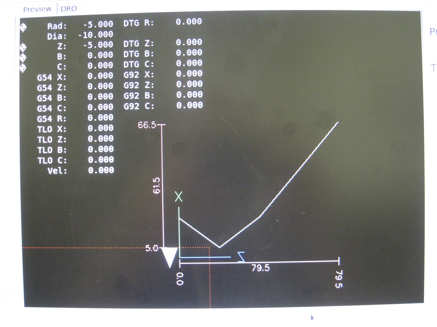

Now start again, close Lcnc, re-open,
Home all, Load same Gcode file.
Display looks so:
(269)

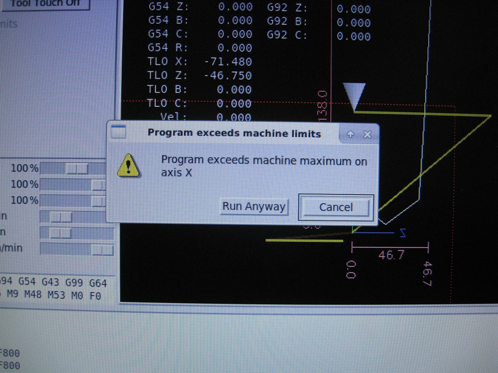

Now I wish to set a new  workpiece Z zero for tool 1.
In MDI I then do T1 M6 G43.
Then I jog Z to its new Zero position, and do Tool-Touch-Off Z=0.0  ( with mode=tool touch off to workpiece selected)
I load the Gcode file again: - display Becomes:
(271)
The new Z offset is in place..
When I try to step ( or run) I have a limits error.
(272)
(273)

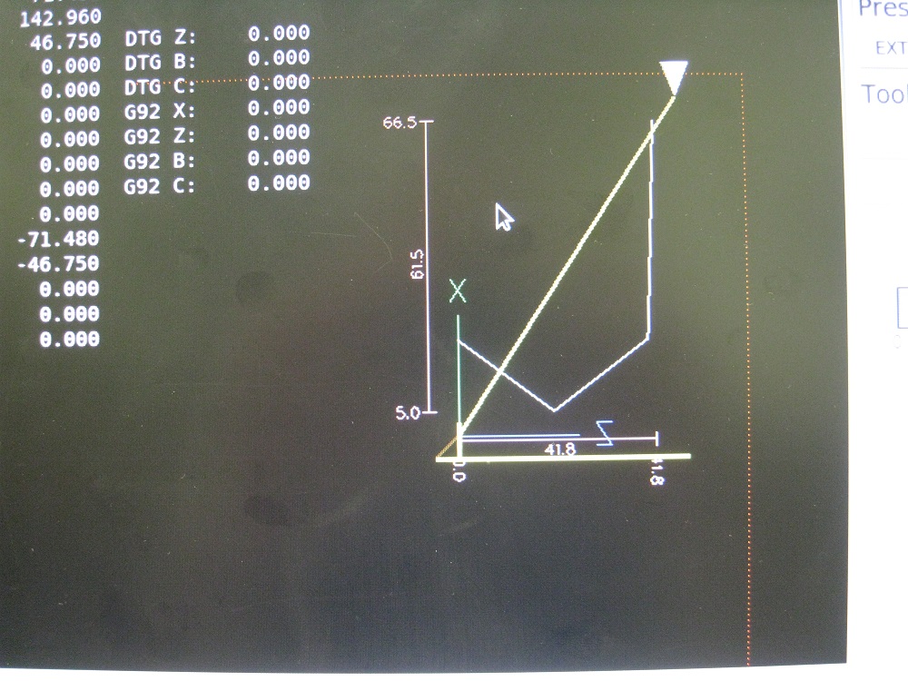

Then I exit Lcnc again, re-load it, Home all, load the Gocde file again.
Now the Tool offsets are as they were in the last failed run.
I then run again and everything works!!!!!
(276)
(277)
What is going on????
Nothing was out of limits in the failed run at all.
Axes were well away from software axis limits, hardware limit/home sensors, etc.

15 Oct 2021 10:04 #223188 by andypugh
You should _not_ do tool touch off once the tool length is set.
You should do coordinate system touch-off. (G54, typically)
Here is what I do.
Tool 1 is a conventional turning/facing tool. I maintain offsets of zero in X and Y for that tool. It is my reference tool, and all other tool offsets are relative to that tool.
I load that tool and touch off the coordinate system Z to a convenient place on the workpiece.
If the machine has lost position, then I set the X of the working coodinate system (G54) approximately to the workpiece (this step is not normally necessary)
I typically face-off the stock at Z=0 at this point.
I then generally take a test cut on diameter or stop a bit short of final dimension, and measure the diameter, then set the X value in G54 (this accounts for work and tool deflection for the work at hand)
If I need to use a different tool, then that will often already have the correct offsets relative to tool 0 in the tool table. If I need to tweak Z or X then _that_ is a tool touch-off.
Note that if the tool table offsets are correct then I can touch-off the coordinate origin using any tool, it does not have to be the reference tool that is used to set the working coordinate system.
