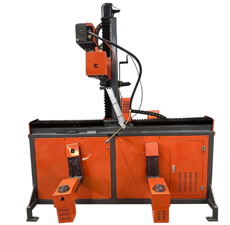

I'm afraid I don't have a ready made kinematic for a machine with 2 work side rotaries and one spindle rotary.
Do you have a picture of the machine geometry? I'm having trouble picturing a spindle with a C rotation only. C would rotate around the Z axis and usually the spindle itself is aligned with the Z axis.

i attached representive photo of the machine.
C axis is for rotation of the welding torch and this torch has offset between torch tip and rotation center of the C axis This ofsett can modified by operator according to welding jig.
A and B axis are for rotation of the object that operator needs to weld.

Replied by Aciera on topic Kinematic model for a 5axis mill with universal (nutating) head
I see. Yes, that would require a new kinematic model. Basically the 'xyzab-tdr' expanded with the tool side c rotation and the torch tip offset.
