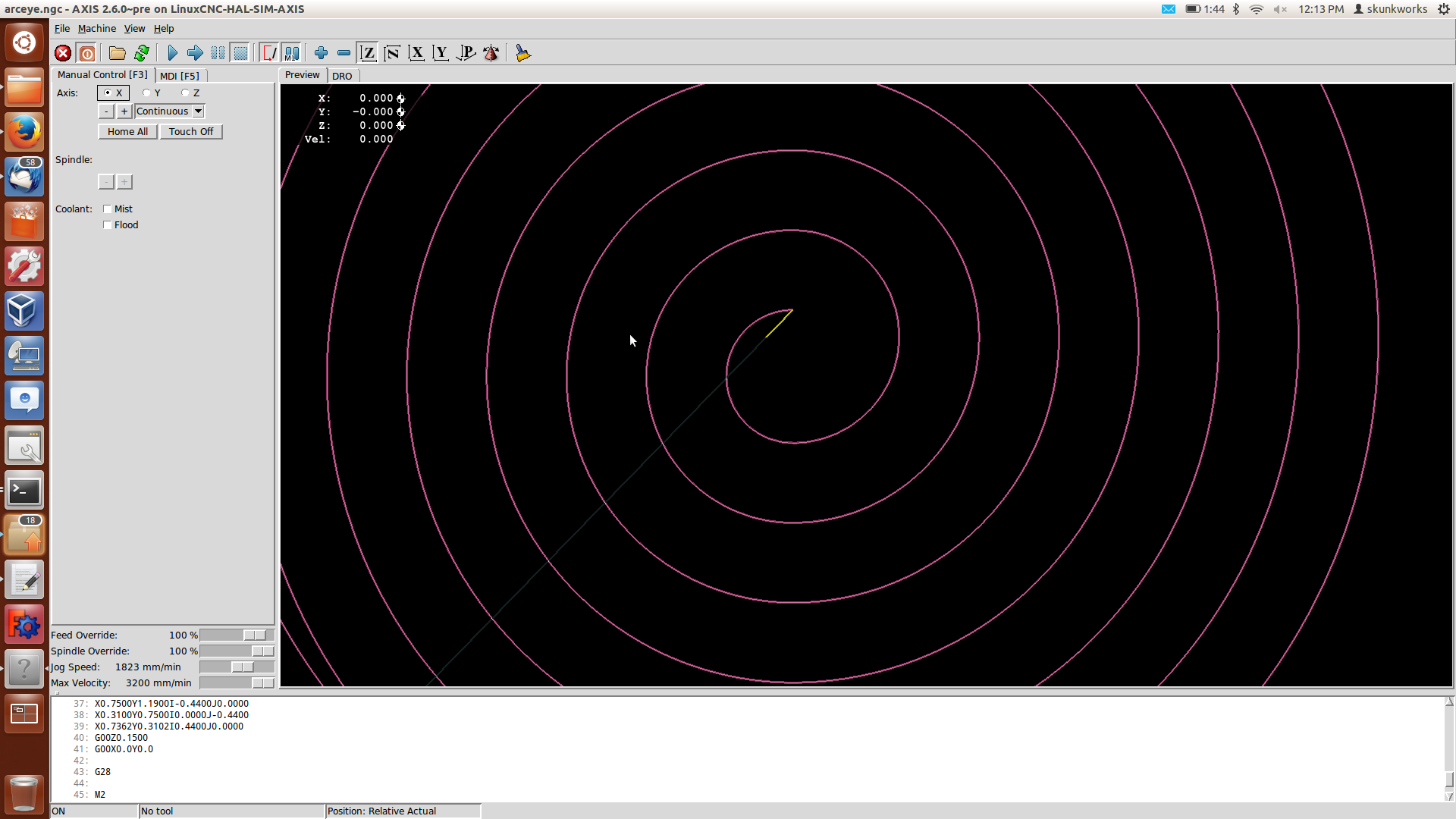

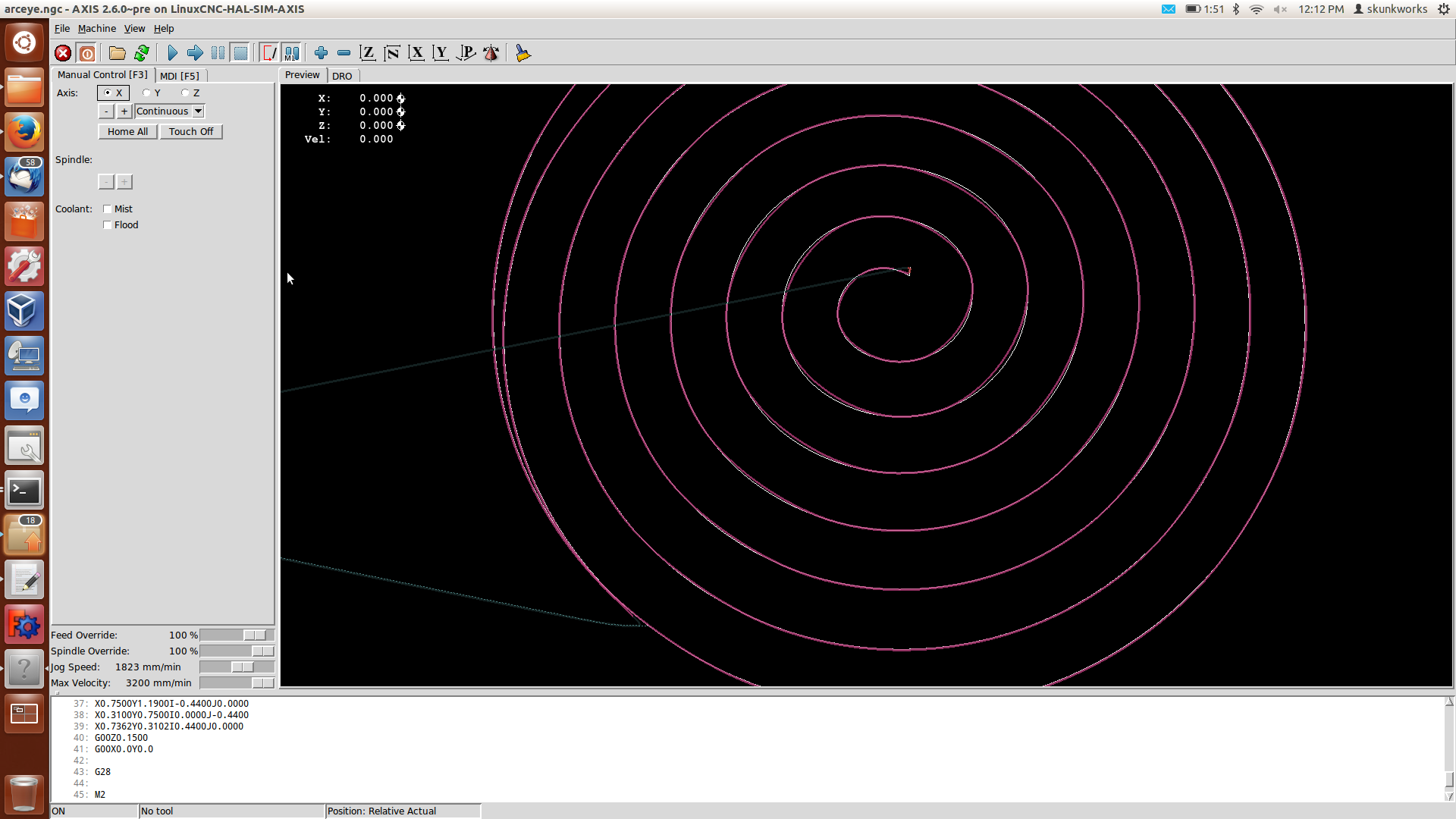

15 Jan 2014 01:24 - 15 Jan 2014 01:25 #42777
by ArcEye
Replied by ArcEye on topic New Trajectory Planner - Testers/programs wanted
Hi
I don't pretend to understand it, but here is a non-scientific test that shows a difference
Run 1 - the patched linuxcnc-beta RIP
Velocity during the spiral in axis_mm sim, with all the [TRAJ] settings made, max velocity set to 3200
1701mm/min
Run 2 - 'standard' RIP of 2.6~pre
Same sim and velocity settings
1828/1813 mm/min fluctuates between 2 as each segment changes
The code is here (it is imperial, but I didn't have a metric equivilent)
Obviously it is not quite the sort of short segment code some others were testing, but there is a real difference in the 'wrong' direction
regards
1701mm/min
G40 G90
G20 G17
G40 G8
F3000
;M3 S600
;G4 P10
;M5
G00 X0.7500 Y0.7700
G01 Z-0.0300
G03X0.7000Y0.7200I0.0000J-0.0500
X0.7500Y0.6700I0.0500J0.0000
X0.8300Y0.7500I0.0000J0.0800
X0.7500Y0.8300I-0.0800J0.0000
X0.6400Y0.7200I0.0000J-0.1100
X0.7500Y0.6100I0.1100J0.0000
X0.8900Y0.7500I0.0000J0.1400
X0.7500Y0.8900I-0.1400J0.0000
X0.5800Y0.7200I0.0000J-0.1700
X0.7500Y0.5500I0.1700J0.0000
X0.9500Y0.7500I0.0000J0.2000
X0.7500Y0.9500I-0.2000J0.0000
X0.5200Y0.7200I0.0000J-0.2300
X0.7500Y0.4900I0.2300J0.0000
X1.0100Y0.7500I0.0000J0.2600
X0.7500Y1.0100I-0.2600J0.0000
X0.4600Y0.7200I0.0000J-0.2900
X0.7500Y0.4300I0.2900J0.0000
X1.0700Y0.7500I0.0000J0.3200
X0.7500Y1.0700I-0.3200J0.0000
X0.4000Y0.7200I0.0000J-0.3500
X0.7500Y0.3700I0.3500J0.0000
X1.1300Y0.7500I0.0000J0.3800
X0.7500Y1.1300I-0.3800J0.0000
X0.3400Y0.7200I0.0000J-0.4100
X0.7500Y0.3100I0.4100J0.0000
X1.1900Y0.7500I0.0000J0.4400
X0.7500Y1.1900I-0.4400J0.0000
X0.3100Y0.7500I0.0000J-0.4400
X0.7362Y0.3102I0.4400J0.0000
G00Z0.1500
G00X0.0Y0.0
G28
M2Obviously it is not quite the sort of short segment code some others were testing, but there is a real difference in the 'wrong' direction
regards
Last edit: 15 Jan 2014 01:25 by ArcEye.

15 Jan 2014 02:13 #42780
by skunkworks
Replied by skunkworks on topic New Trajectory Planner - Testers/programs wanted
I am seeing that too with the axis_mm.ini. The only thing I can see is that the path following is a bit different between the two..
The current tp seems to be a lot looser

- rellenberg
- Posts: 37
- Thank you received: 10
15 Jan 2014 03:08 #42782
by rellenberg
Replied by rellenberg on topic New Trajectory Planner - Testers/programs wanted
I ran your test file and can confirm that it does hit a speed limit of 1701 mm/min during the spiral portion. This is because I scale the maximum velocity of all arc motion slightly to allow safe tangential acceleration. I found during testing that running at the actual maximum speed during tight arcs hits the acceleration limit just from normal acceleration. This means that if we have to slow down in the middle of the arc, the total acceleration will be greater than the limit. A good analogy here is driving a car around a corner at the limit of the tires' friction. If you're a great driver, you can keep it on the road, but if you have to hit the brakes suddenly, you'll likely slide out and crash.
What you're seeing is the maximum speed of the machine (1828mm/min) scaled down by sqrt(sqrt(3)/2). This scaled velocity corresponds to sqrt(3)/2 * max acceleration, which means we have 0.5* max acceleration free for tangential acceleration.
What I realized looking at your results is that I applied this scale factor to every circular arc in the program, without checking if it actually needed scaling. This means that large-radius arcs could have a higher maximum velocity. This is a subtle bug with an easy fix. I'll post a fix shortly in my experimental code branch , and move it to the beta branch if it passes the tests.
Thanks for tracking this down! I doubt I would have seen this myself, as my test code does not often hit the maximum machine velocity.
- Rick G
- Posts: 27
- Thank you received: 114
15 Jan 2014 14:10 #42807
by Rick G
Replied by Rick G on topic New Trajectory Planner - Testers/programs wanted
Regarding the above spiral test what values were used for G64 P & Q?
Rick G

15 Jan 2014 14:17 #42808
by rellenberg
@Rick, I ran ArcEye's test with P0.0 and Q0.0, since the code didn't specify a G64 explicitly.

15 Jan 2014 15:09 #42809
by ArcEye
Hi Rick
I ran it with P0 Q0 by default the first time, because G64 was enabled without any values set
I tried a few modest values then and found it did not make any difference, which appears to be because the governing
factor was a built in limit on arc velocity rather than how tight or loose the plot following was.
regards
