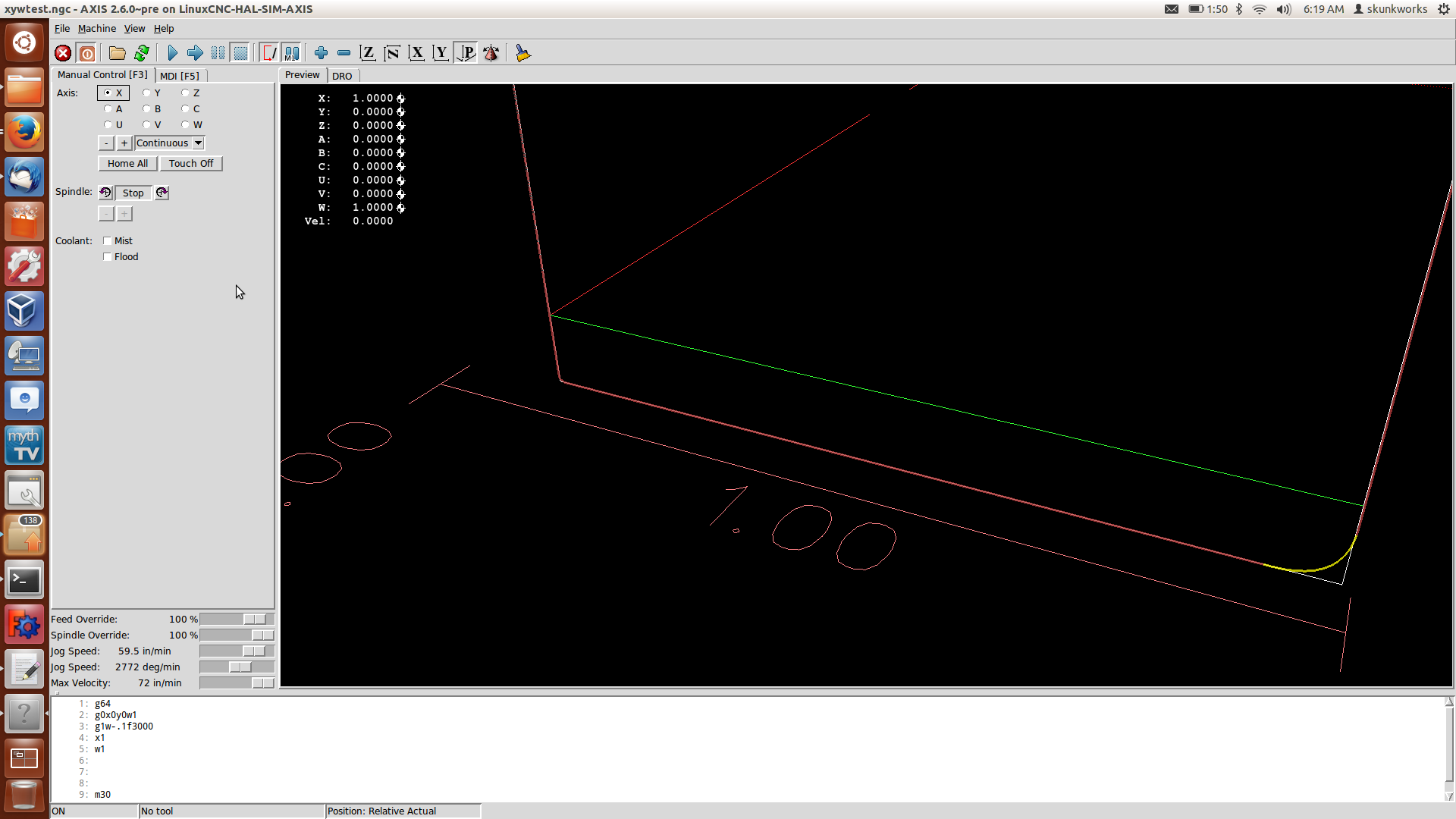

10 Jan 2014 20:19 #42576
by skunkworks
Replied by skunkworks on topic New Trajectory Planner - Testers/programs wanted
Ok -I think I am seeing it. I am using the sim axisabcxyzuvw config with the circular blends added to the ini file..
this simple program
g64
g0x0y0w1
g1w-.1f3000
x1
w1
m30
you can see in the first screen shot - the left corner isn't blended. (compared to the right) I assume this is quite a constraint violation but I have not added acc readout for the w axis yet. I assume your sytem is step/dir servos? (I could see that type of system just overshooting at the violation and recovering)

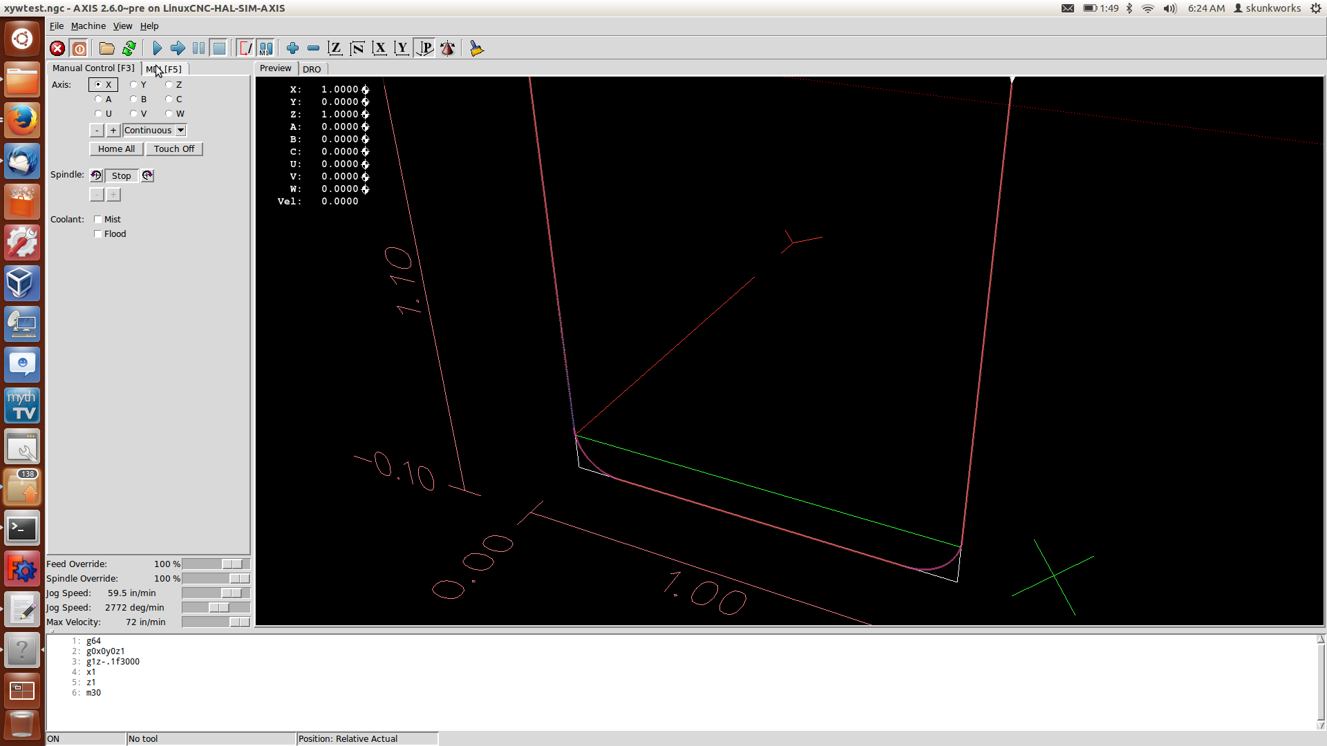

Here is the program run with z instead of w
g64
g0x0y0z1
g1z-.1f3000
x1
z1
m30
you can see it blends both the left and right corner.

this simple program
g64
g0x0y0w1
g1w-.1f3000
x1
w1
m30
g64
g0x0y0z1
g1z-.1f3000
x1
z1
m30

- Todd Zuercher
- Posts: 4786
- Thank you received: 1476
10 Jan 2014 21:57 #42579
Replied by Todd Zuercher on topic New Trajectory Planner - Testers/programs wanted
My config is analog torque mode servo using a Mesa 5i25/7i77 combo to interface with some Teknic servo drives. So LinuxCNC is closing both the position and velocity loops. Hence why my servo period is 2.35kHz, as fast as I could get this PC to run. Wish I could have gotten it about twice as fast. I would have felt a little better about tuning it. This is the last time I will buy drives that can not do velocity input. In hinde sight I should have set this up with step dir, and encoder feed back, for digital velocity command, but I realy wanted to try setting up an analog system. I did digital on another machine with a 5i25/7i85 setup after this and it worked very nicely.

11 Jan 2014 00:51 #42581
I think I see where the problem is.
The blending turns off (or is suposed to right now) for movements that contain axis other than XYZ. In this snipit of code:
the error occurs at the transition of a line with a W comand to a line line that does not have a W command. My guess is that the new planner is blending this transition move for XYZ but letting W do ??, causing the small gouge at that point.
G1 Z0. W0.
G1 X2.0155 Y2.3983 Z-0.015 W-0.015
G1 X2.0368 Y2.3972 Z0. W0.
G1 X1.8094 Y2.2127
G1 X1.8083 Y2.1915 Z0. W0.
G1 X1.8094 Y2.2127 Z-0.015 W-0.015
G1 X1.7881 Y2.2138 Z0. W0.
G1 X2.0155 Y2.3983
G1 X2.0166 Y2.4195 Z0. W0.the error occurs at the transition of a line with a W comand to a line line that does not have a W command. My guess is that the new planner is blending this transition move for XYZ but letting W do ??, causing the small gouge at that point.

11 Jan 2014 03:55 #42586
by rellenberg
Replied by rellenberg on topic New Trajectory Planner - Testers/programs wanted
I think I've fixed this in the latest commit. It looks like I forgot to check both segments for ABC/UVW motion, so it was incorrectly creating blend arcs in the case when the previous segment had W movement. Now it detects ABC/UVW motion in either segment and skips circular arcs in this case.
