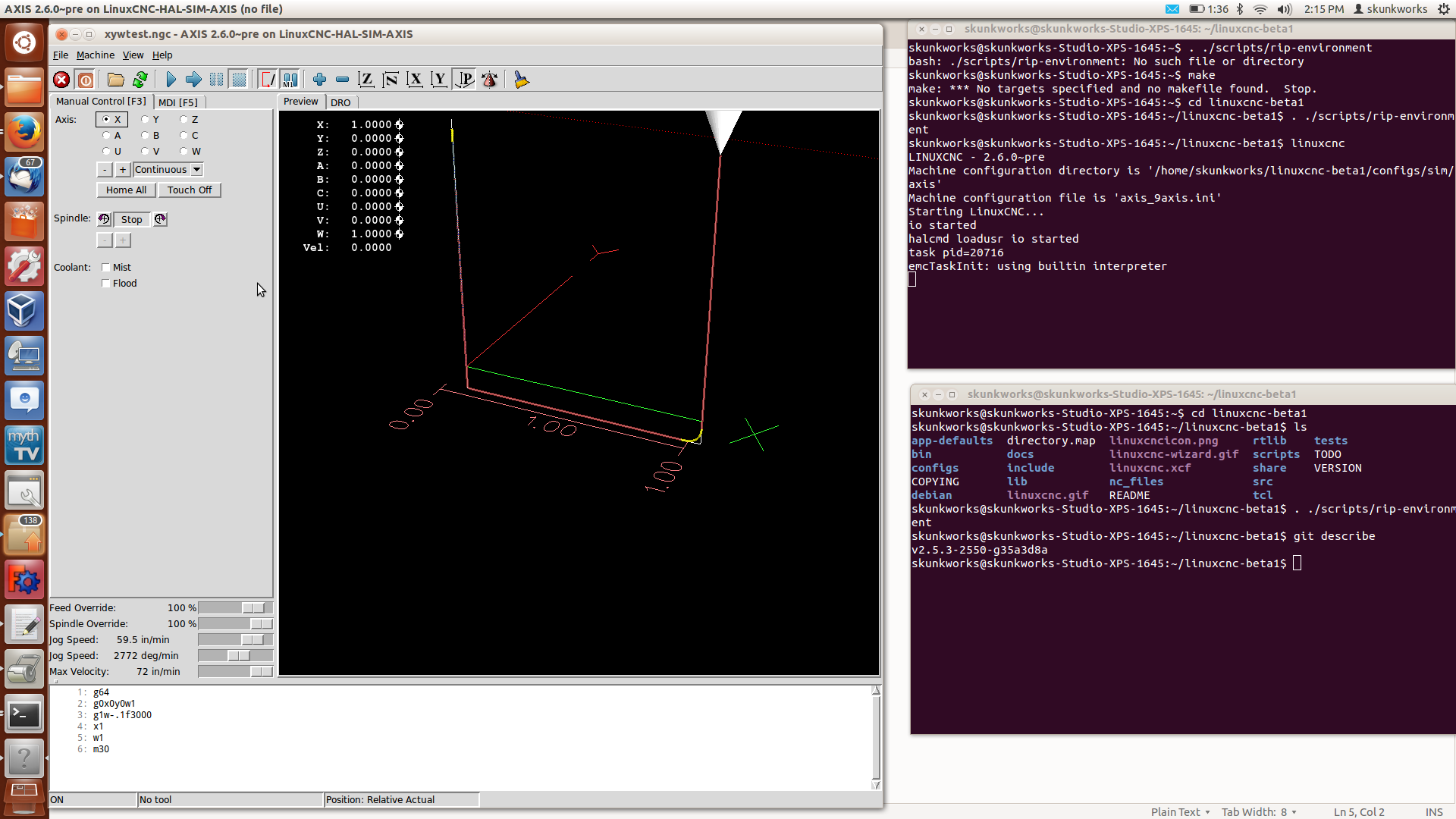

I am still seeing it here with the latest pull. The first corner doesn't seem to have any blending. This in on a sim install - not realtime. Make sure you start fresh - I had goofed around with loading programs and it seems to start blending the first move. (don't remember the steps) but on the inital loading of linuxcnc and run of the program shows this.
g64
g0x0y0w1
g1w-.1f3000
x1
w1
m30
sam

11 Jan 2014 06:43 #42595 by skunkworks
Replied by skunkworks on topic New Trajectory Planner - Testers/programs wanted
if you look at the screenshot - you can see that it still isn't blending on the first corner (left side)
Does this mean that it's working for you now after doing a rebuild, or do you still see the blend missing sometimes?
11 Jan 2014 07:37 #42597 by rellenberg
Replied by rellenberg on topic New Trajectory Planner - Testers/programs wanted
Ok, after further research, I think it's because I forgot to apply the same change to the tangent line check. This was an (un)lucky case because [1,0,0] is the default unit vector for XYZ when there is motion on ABC/UVW. It must be flagging the X move as tangent to the previous move. My lastest push should fix that, and extends the acceleration constraint check to the W axis.
11 Jan 2014 08:48 #42601 by skunkworks
Cool - that seeemed to fix my test program..
sam

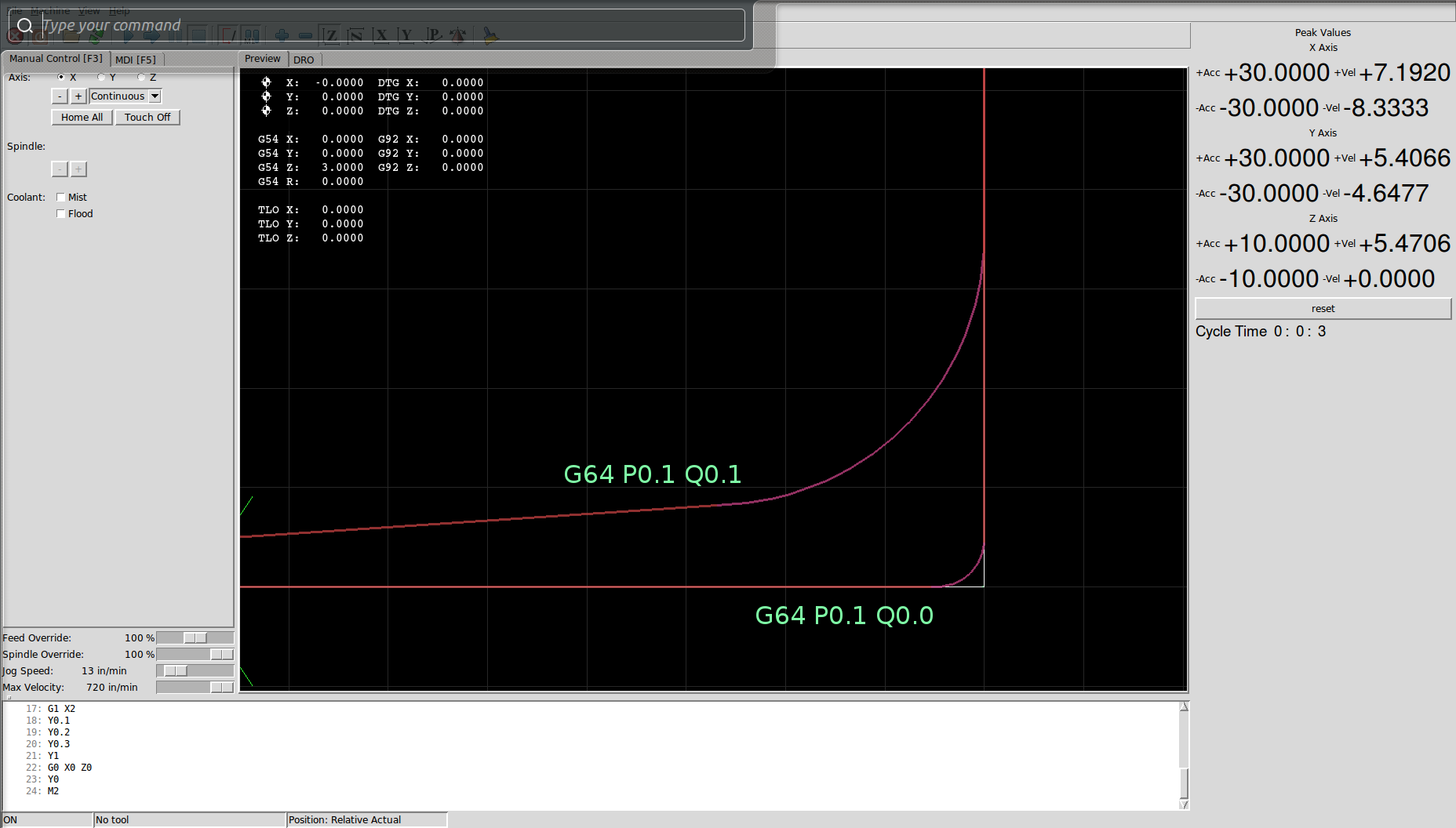

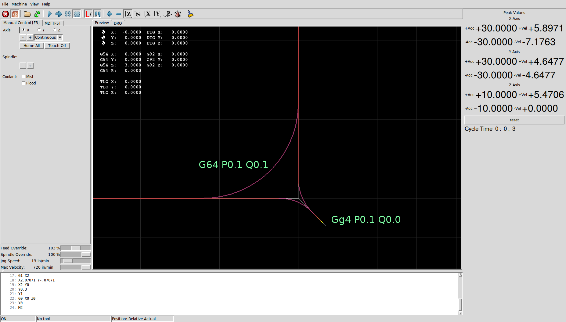

13 Jan 2014 00:43 - 13 Jan 2014 00:57 #42662 by rellenberg
Thanks for your feedback, Rick!
Well yes that is clear but would it not be better to be consistent with the current TP for existing code and compatibility?
I changed the behavior of G64 P & Q mostly because I found the default behavior counter-intuitive. In the original TP (as you said) G64 P0.01 implies Q0.01 as well. The attached image / G code shows what happens if you have a few segments that are less than or equal to the blend tolerance (run using circular-blend-arc-beta). With Naive CAM enabled, the worst-case tolerance is almost double what "P" specified. The actual path tolerance is (in the worst case) the sum of P and Q, it makes more sense to me to have to explicitly specify the Naive CAM tolerance. Having Q default to the P value "hides" this extra tolerance from the user.
