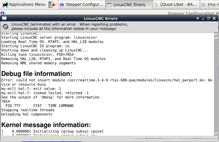

i did added A axis but no luck ....both time same error triggered
- Posts: 19876
- Thank you received: 4642
10 Sep 2015 21:23 #62398
If you don't have an A-axis, then why do you have 5 stepgens? You do everything else for the A axis except link it to parport pins.
Replied by andypugh on topic 5 Axis ParPort Stepper Setup with RTCP
I dont want to configure A axis, i want to configure B axis, so is it necessary to put A information ?
The following user(s) said Thank You: marq_torque
- Posts: 19876
10 Sep 2015 21:25 #62399
It looks like another module (probably lp) has claimed the parallel port.
lsmod should answer the question as to which, and then you can usemodprobe to remove the offending module, then try again. If that works then you can blacklist the offending module.
en.wikipedia.org/wiki/Modprobe

Sorry for late reply, actually my previous emc setup ran on onboard PP. On this system I was using PCI PP... So it was difficult to setup in linux a little bit. So changing my board and updating what will happen then needed link and pivotpoint configuration.

i tried board with Parallel port, no luck .... now will be trying search how its occupied

Have you correctly identified what the address of the PCI parallel port is?

@andypugh : i did set all stuff including homing sequence to all setup from 5axis sample reference, thanks a lot mate.
@Todd : thanks, i did changed PP type in BIOS to EPP and also updated to latest version i.e. EMC 2.7.0
Finally i am set to run stepper with 5Axis Skin, all set now. all i needed to do is how to change joints details, sample skin have B/C Head when my configuration is XZ axis B Head C table, now i am stuck where to dig.
