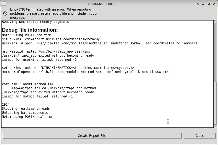

Ok, I found my one mistake. i was trying to compile "5axiskin.c" but it didnt work so after reading more, I found there is "userkins.comp" file need to be compiled. so i edited file as per attachment and getting error as per screenshot.

15 Jun 2026 07:12 #347080 by Aciera
Replied by Aciera on topic 5 Axis ParPort Stepper Setup with RTCP
1. As you have already found out 'halcompile' will not work with all .c files. A 'run-in-place' (RIP) installation would be required here.
2. .comp files have their own syntax, so you cannot simply copy-paste the code from a .c file into a .comp file.
The following user(s) said Thank You: marq_torque
