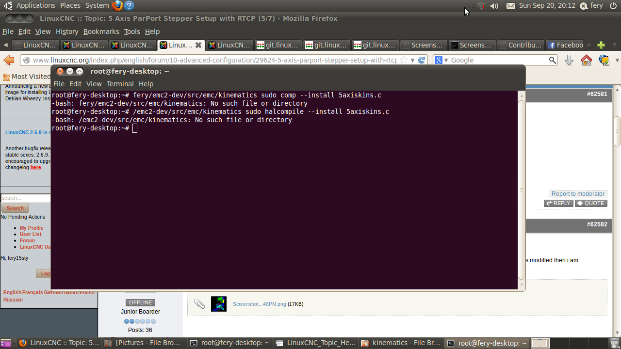

20 Sep 2015 20:15 #62810 by fery15sty
Replied by fery15sty on topic 5 Axis ParPort Stepper Setup with RTCP
I tried to compile kinematics file, but the result is like this:
what i am doing??

20 Sep 2015 21:56 #62817 by dgarrett
Replied by dgarrett on topic 5 Axis ParPort Stepper Setup with RTCP
An example shell session using linuxcnc installed from deb packages follows.
A run-in-place (RIP) environment is not required when using linuxcnc installed from
deb packages.
In this example, linuxcnc-uspace packages from the buildbot are used but instructions
are similar for any package install
$ # verify required packages (the -dev package provides the halcompile utility)
$ dpkg -l linuxcnc\*|grep ii
ii  linuxcnc-uspace     1:2.8.0~pre1.1082.gaa37cb0 amd64        PC based motion controller for real-time Linux
ii  linuxcnc-uspace-dev 1:2.8.0~pre1.1082.gaa37cb0 amd64        PC based motion controller for real-time Linux
$ # verify halcompile is in standard path:
$ which halcompile
/usr/bin/halcompile
$ # -h shows usage
$ halcompile -h
halcompile: Build, compile, and install LinuxCNC HAL components
Usage:
           halcompile [--compile|--preprocess|--document|--view-doc] compfile...
    [sudo] halcompile [--install|--install-doc] compfile...
           halcompile --compile --userspace cfile...
    [sudo] halcompile --install --userspace cfile...
    [sudo] halcompile --install --userspace pyfile...
           halcompile --print-modinc
$ # examine current directory:
$ ls -gG
total 4
-rw-r--r-- 1 3029 Sep 11 03:21 5axiskins.c
$ # try compiling:
$ halcompile --compile 5axiskins.c
Compiling realtime 5axiskins.c
Linking 5axiskins.so
$ ls -gG
total 20
-rwxr-xr-x 1 15232 Sep 20 07:45 5axiskins.so
$ # try installing:
$ touch now
$ sudo halcompile --install 5axiskins.c
cp 5axiskins.so /usr/lib/linuxcnc/modules/
$ find /usr/lib/ -newer ./now -ls
166767   16 -rw-r--r-- 1 root root 15232 Sep 20 07:46 /usr/lib/linuxcnc/modules/5axiskins.so

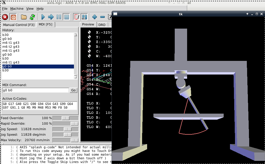

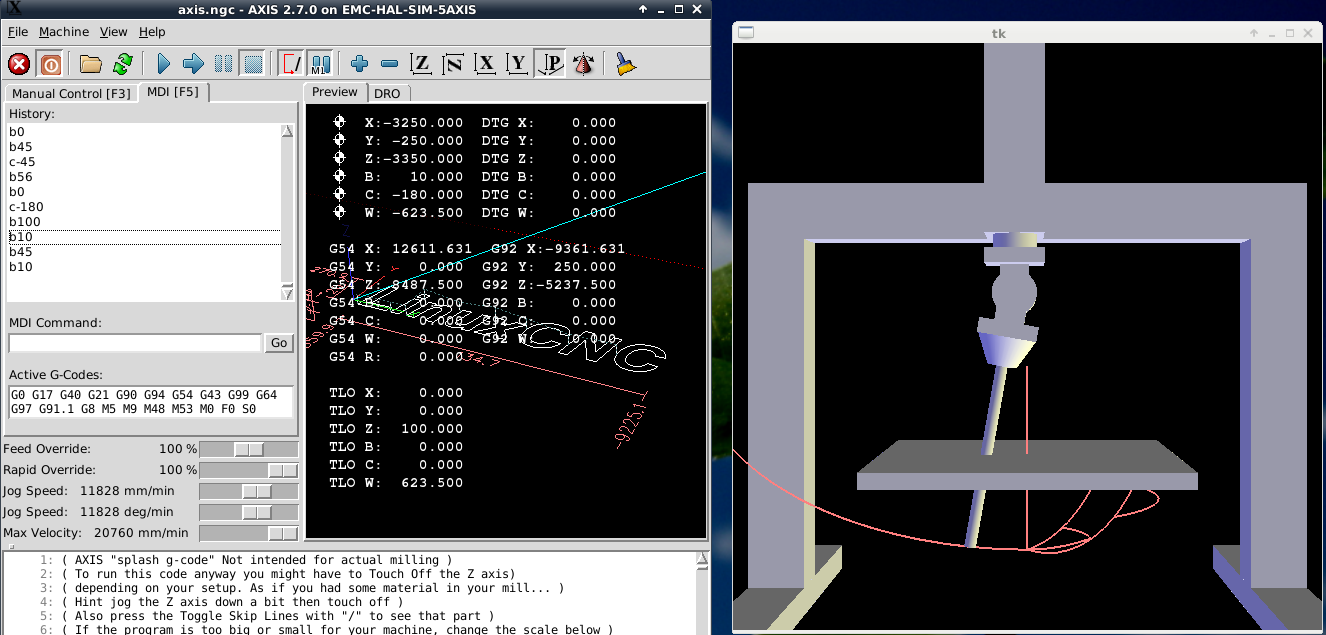

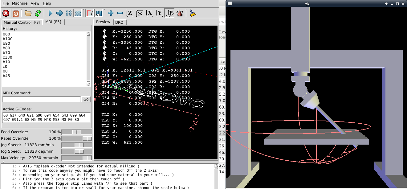

25 Sep 2015 19:46 #62974 by marq_torque
Replied by marq_torque on topic 5 Axis ParPort Stepper Setup with RTCP
Hello Andypugh,
yes its already linked. bt there is also on more thing coming wrong.... is whenever i rotate C axis ... XZ B movement is totally unpredictable ..and goes wrong ... if i command XZB when C at 0° it moves fine but still tool length is question. but when i first try to move C then try to move XZB it moves very awkwardly... i am trying to post screenshot from computer.
25 Sep 2015 19:50 #62975 by andypugh
Replied by andypugh on topic 5 Axis ParPort Stepper Setup with RTCP
I thought that the C-axis was not involved in the kinematics calculations?
Maybe this is just a Vismach problem? You probably shouldn't have the C-axis connected to Vismach.
Does the tool length shown in Vismachmatch the tool length shown at the bottom of the Axis window?
Does the Vismach picture change when you change tools?

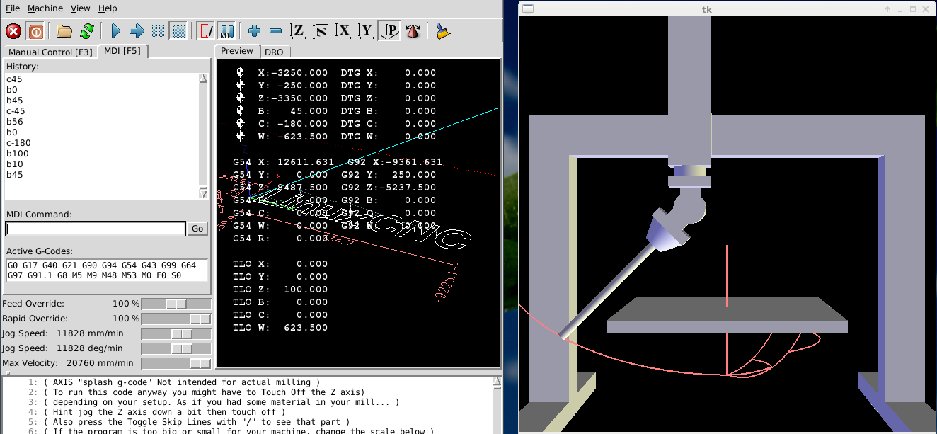

25 Sep 2015 20:35 #62977 by marq_torque
This is movement of XZB when C axis is 0
it is holding spindle center Point not tool tip

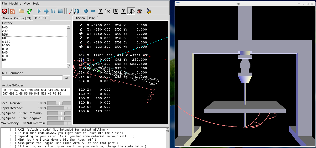

25 Sep 2015 20:38 #62978 by marq_torque
This is Movement of XZB axis when C ia Rotated -180 Degree.
