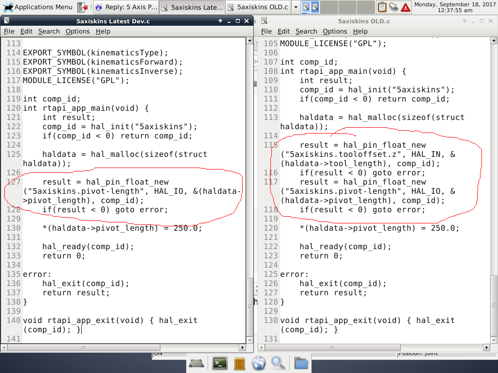

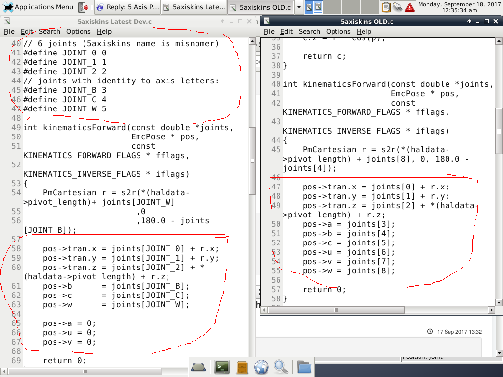

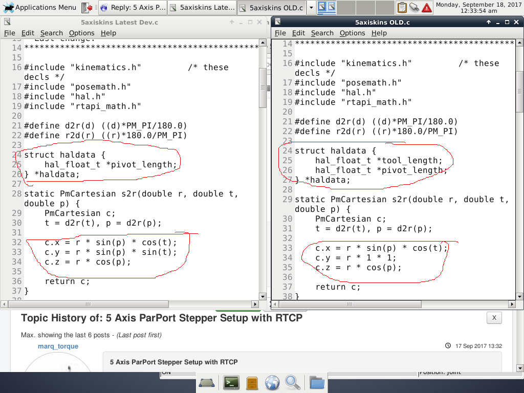

Hello Members,
After long long time i am back some routine struggle and all, at present working on machine. did setup everything on machine physically and now trying to configure linux, as expected stuck at kinematics, here is situation
1) I learned to configure step axis, and configured all axis and its live and working as expected. tried jogging in world and joint mode no any errors nothing
2) i tried to install latest kinematic file, but its throwing error with joint 3 follow error, and even if federate in this latest kinematic is very slow this throws error and installed old kinematic which i attached in this thread previously, now problem is its jogging and switching without any errors but main problem started showing when i started moving w axis, it started moving in Y axis which is not present in my machine as its only rotary head with B axis and C axis is rotary table. now scratching head where i gone wrong. i havent had tested W axis movement before only tested b axis rotation and it was working fine.
any help ?
attached here old kinematic which is running smoothly without any errors,
and latest kinematic file from dev folder. any help much appreciated.
marq

These are differences between Latest Kinematic and old kinematic if anyone could save me please?

Replied by andypugh on topic 5 Axis ParPort Stepper Setup with RTCP
I think that any RTCP machine will always have a Y axis.
The XYZ coordinates define a position in space and the machine joints move to accomodate that.
Unless you live in flatland , every position in space is defined by XYZ.
Which version of LinuxCNC are you using?

i have found one thing that modifying kinematics to remove link between C axis and Head rotation works fine, but it need to modify for this Y axis movement, when issued W axis move, Y axis moves automatically to that W amount, regardless what degree B and C have even in 0 Position of both rotary when i issue W axis command it moves both Z and Y axis. Z is working fine without any problem as it should, but Y is moving which should not, now thats causing me real problem because i am on the way to setup head type 4th axis Router with W axis. dont know what to modify in kinematics. !
Ankit

Possibly you need to reconsider what RTCP means?
It may be that this page in the docs helps to explain it.
linuxcnc.org/docs/devel/html/motion/5-axis-kinematics.html
I think that you might be confused about the the difference between axes and joints. (which is understandable, because LinuxCNC 2.7 is confused about the difference too). 2.8 will make the distinction much clearer, that documentation link above is actually to the 2.8 (development) version of the documentation.
