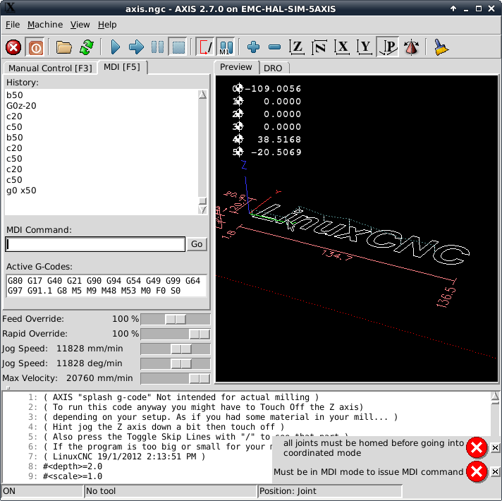

I have checked math.... i am so noob ... BTW do you have idea why it shows error like, "Must be in MDI mode to issue MDI command."
Also ... totally blank again ... how to break link of C from 5axiskin ... :(
16 Sep 2015 04:24 #62626 by andypugh
Replied by andypugh on topic 5 Axis ParPort Stepper Setup with RTCP
It means what it says. What are you doing to prompt it?
I thought you said that you had checked the maths? If so, That's what you do, put that maths in the kinematics file and recompile.

16 Sep 2015 04:40 #62627 by marq_torque
Replied by marq_torque on topic 5 Axis ParPort Stepper Setup with RTCP
After changing Value of C in line 44 and 65 ...
16 Sep 2015 05:17 #62630 by andypugh
All the axes do seem to be homed, can you actually go into World mode?
I assume you just typed G0 X50? That's an MDI command, but you can't do that because at the moment you don't have an X axis, you are in Joint mode, and have Joints 0,1,2,3,4,5.
You need to switch to World mode, then G0 X50 will be valid (but might not work, for other reasons)
The following user(s) said Thank You: marq_torque

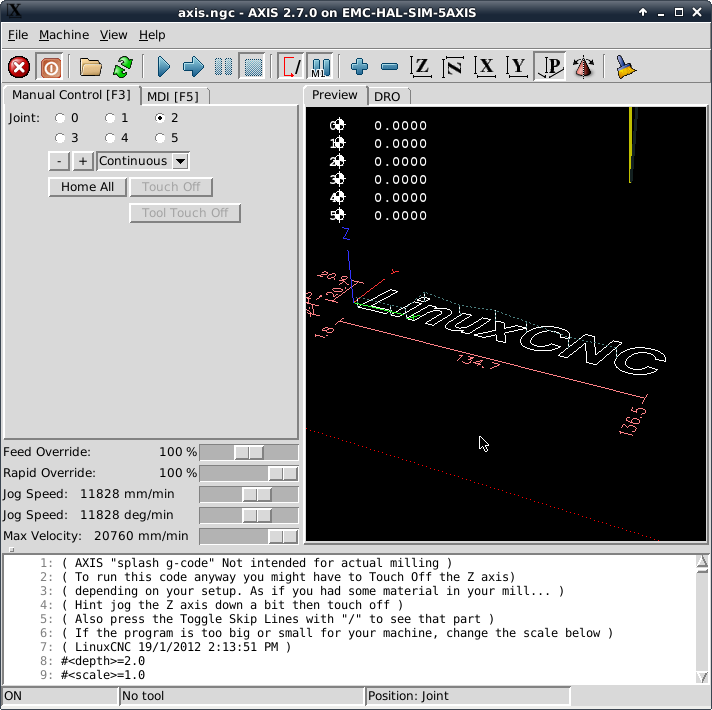

now coming to next step how to touchoff too ?? i mean how to add tool offset ?? because this screen has locked tool touch button ... any ideas ??
Regards,
Ankit
17 Sep 2015 05:46 #62659 by andypugh
You can't touch-off until you are in World Mode.
(then the coordinates XYZ etc mean something, and that is what the DRO shows.)
The keyboard shortcut is $ but you can also do it from the Axis menus (Machine? I can't recall)
