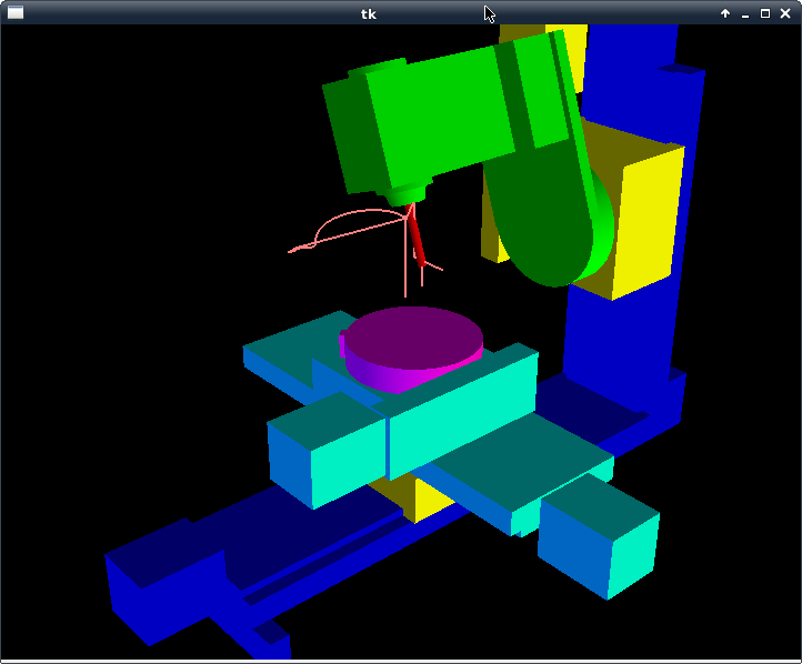

can you show me tutorial, how to build tk simulation like this:
Last edit: 17 Sep 2015 06:27 by fery15sty.
- Posts: 19896
- Thank you received: 4648
17 Sep 2015 16:55 #62680
www.linuxcnc.org/docs/html/gui/vismach.html
Replied by andypugh on topic 5 Axis ParPort Stepper Setup with RTCP
The following user(s) said Thank You: fery15sty

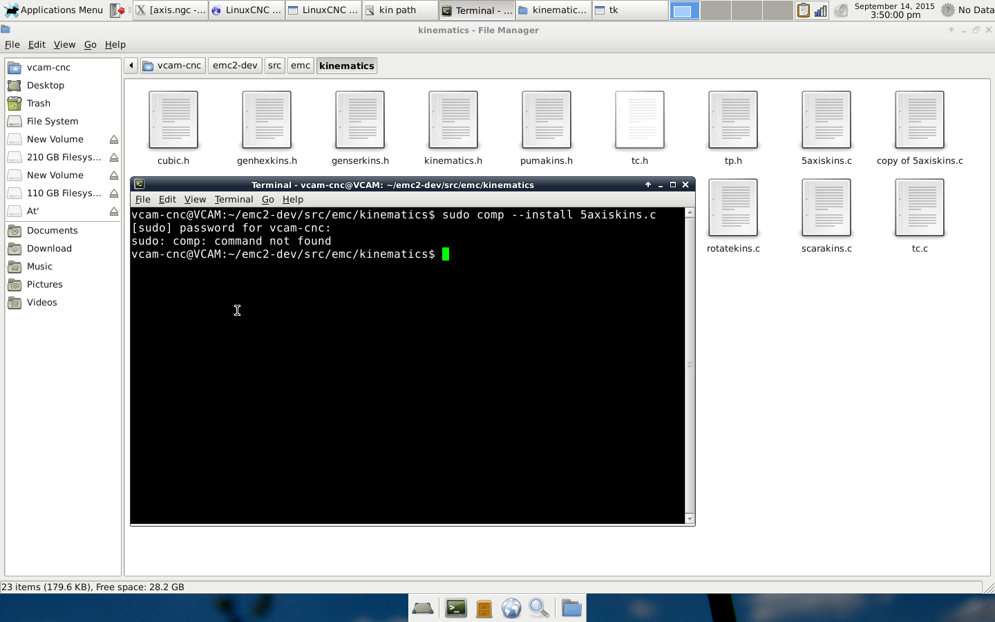

First of all update your EMC Version, then you browse to specified kinematics folder and check, i also tried on ubuntu-10.04-linuxcnc1-i386
Hi marq_torque,
I'm sorry! Maybe my English is not good, but I hope you can help me
I'm from Indonesia, and i'm is beginners about linux cnc.
I also want to buil 5 axis configuration.. What version of your ubuntu? i use ubuntu 10.04 and i can not find 5axiskins.h. can you help me? how to you can get it.
Last edit: 17 Sep 2015 17:15 by marq_torque.

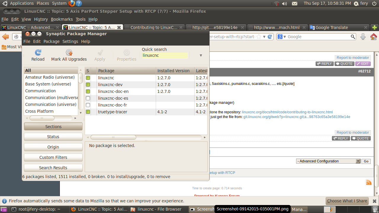

I have update linuxcnc 2.7.0.
i can not find folder kinematic, 5axiskins.c, pumakins.c, scarakins.c, ..... etc.
i just find 5axiskins.ko, genserkins.ko, pumakins.ko, ... etc on folder system/usr/realtime-2.6.32-122-rtai/modules/linuxcnc/
How to i have kinematic file *.c for example..
Please help me..
Please help me..
- Posts: 19896
17 Sep 2015 22:06 #62712
[quote="fery15sty" post=62707i can not find folder kinematic, 5axiskins.c, pumakins.c, scarakins.c, ..... etc.[/quote]
You need the source code.
(and, also, probably, the linuxcnc-dev package from the package manager)
To get all the source code you would want to install git and clone the repository: linuxcnc.org/docs/html/code/contributing-to-linuxcnc.html
But to work on just a single kinematics file you can probably just get the file from: git.linuxcnc.org/gitweb?p=linuxcnc.git;a...98763c65a3e58199e14e
(right-click the "raw" link of the files you want)

i was upgrde linuxcnc-dev package on package manager but i can not find kinematics file on my pc..
- Posts: 19896
17 Sep 2015 23:07 #62715
You won't find _any_ source code files unless you download the source code.
But you can get individual files from the second link.
