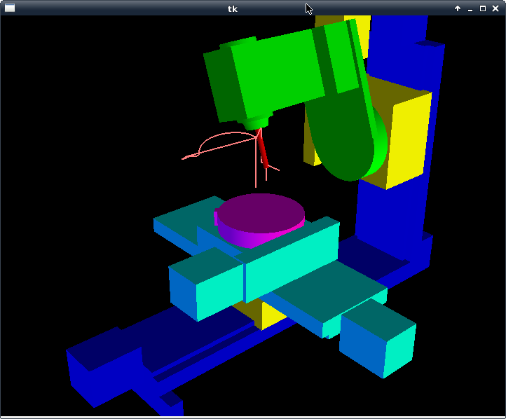

15 Sep 2015 03:47 #62582 by marq_torque
Replied by marq_torque on topic 5 Axis ParPort Stepper Setup with RTCP
also one thing ... i was browsing configurations. i found something similar to my needs.
its in vismach.max5kins, trying both configurations screen-shot attached. but still i need some modification. but is 5axiskin gantry is modified then i am happy kid. no need to dig anything else :)

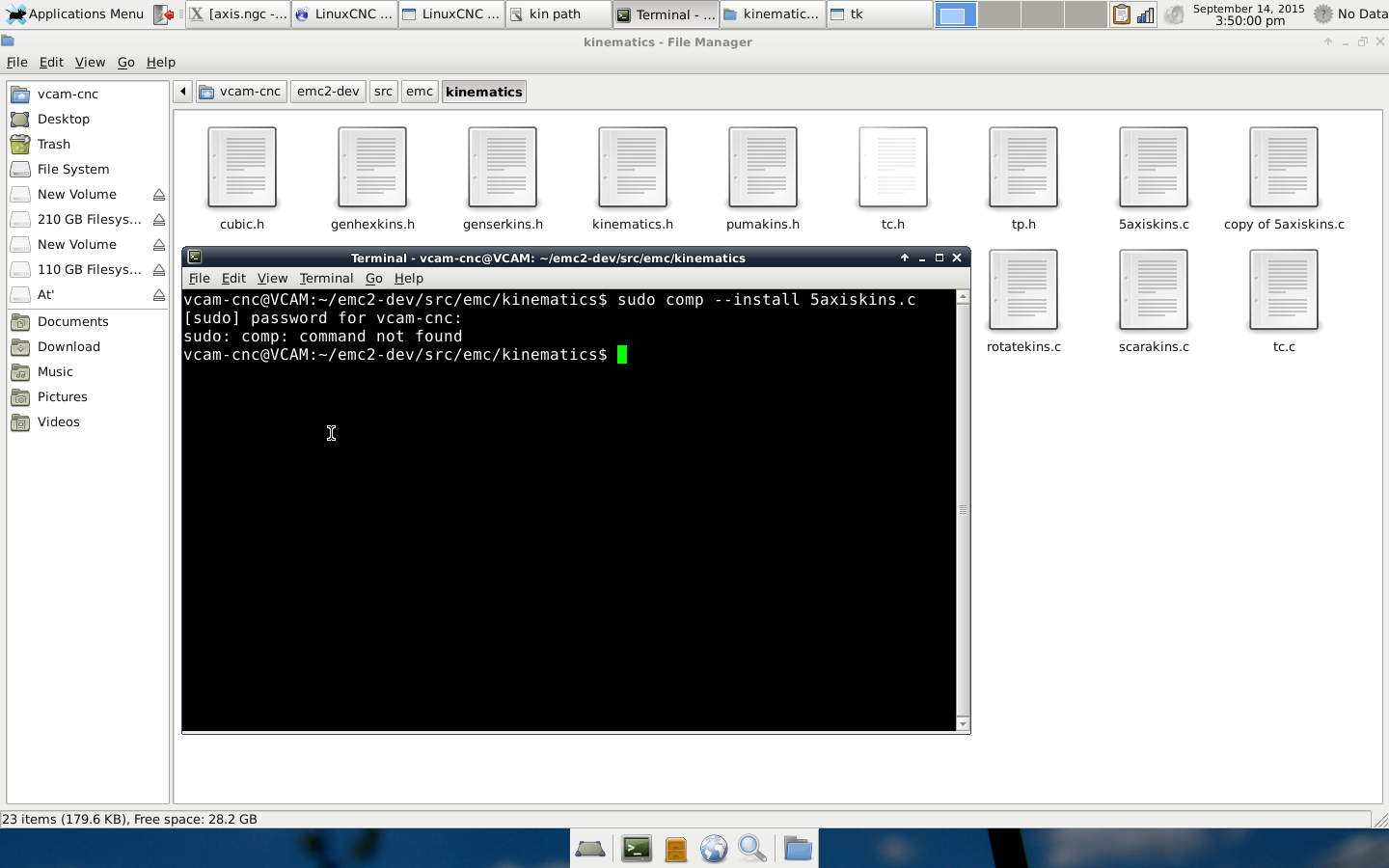

15 Sep 2015 03:51 #62583 by marq_torque
i tried
sudo comp --install 5axiskins.c

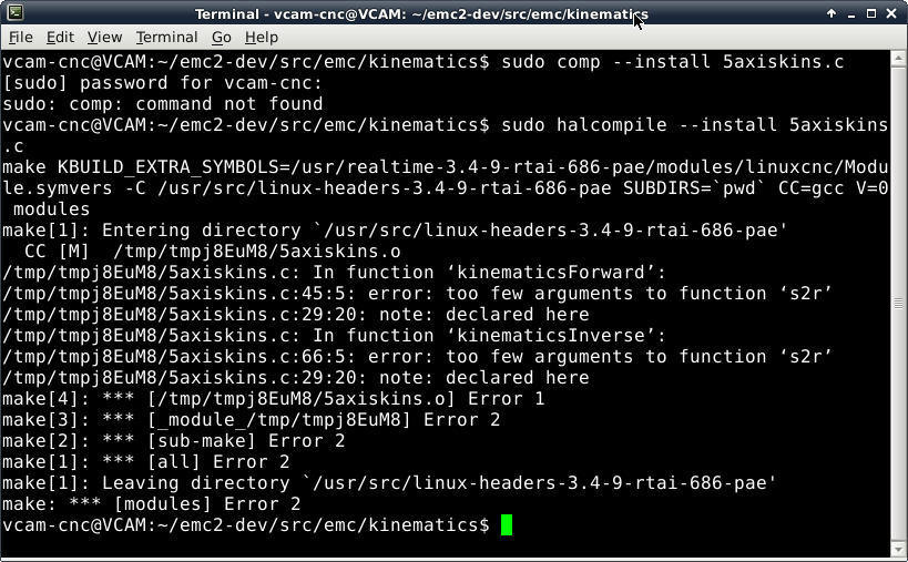

15 Sep 2015 03:52 #62584 by marq_torque
and i got this whe used
sudo halcompile --install 5axiskins.c
15 Sep 2015 04:03 #62587 by andypugh
Replied by andypugh on topic 5 Axis ParPort Stepper Setup with RTCP
You can copy and paste from the terminal window, which is a bit easier than attaching screen shots.
As you have noticed, max5kins might actually work perfectly for you. I think that it is approximately identical but with a different pivot length.
try "maxkins" in your HAL file and see if that works.
As for 5axiskins:
It looks like you just deleted the references to C and joint 5. You can't do that, you needed to replace them with 0 so that the s2r function has the right number of arguments.
First, go back to the original 5axiskins and see if that works. If it does, then you can change things. But try maxkins first.
