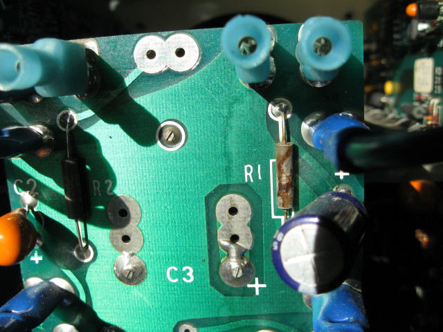

Today I unplugged the "y" wire set from power supply amplifier preparing to apply 1.5 vdc (battery) to TB5 (Drive 1), no connection was made to the battery, so as if that side was not connected to power supply on the control voltage side. As soon as I released the e-stop (as to allow power to the power supply for 1st time) a few sparks flu, and some smoke before I could reset e-stop, upon close inspection it appears the resistor has been cooked, the other one looks ok. I can get the numbers from the other one if that will help find a replacement.
Edit: the more I look at this part that is bad, it appears to be on the "x", the one side still connected. The circuit board is on the bottom of what looks to be a capacitor.

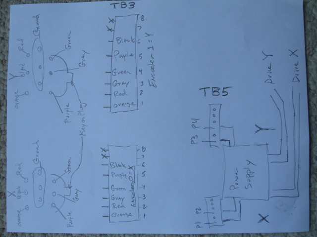

22 Jun 2016 15:27 #76441
by new2linux
Is this ok for diagram of the components, there is a ground wire to all the pieces not shown other than the plugs. The left side is the plugs for the encoders going to the drives. The center is labeled TB3, connections 1 thru 6; 7 and 8 are open on encoders 0 and 1. The right is the power supply with separate heavy wires going to the drives and the light control wires going to TB5. If this is not acceptable please make comments so I may tweak it.
Replied by new2linux on topic retrofit Bridgeport Prototrak Plus
- Todd Zuercher
- Posts: 4786
- Thank you received: 1476
22 Jun 2016 15:59 - 22 Jun 2016 16:00 #76444
Replied by Todd Zuercher on topic retrofit Bridgeport Prototrak Plus
In your drawing, is what your calling the "Power Supply" the white box that has the amps in?
Maybe a photo of what you have going on might be better.
I do think you would have been better off not messing with anything in the big black box and just wired up a connector to the DB25 port on the outside of that to the 7i77.

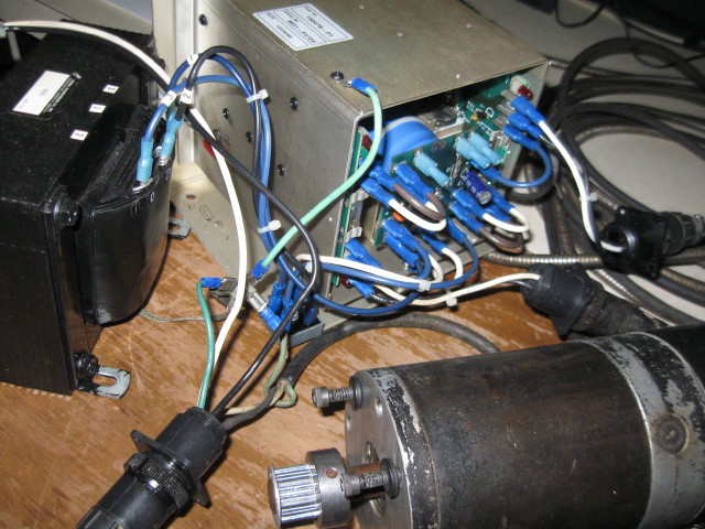

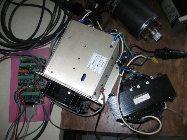

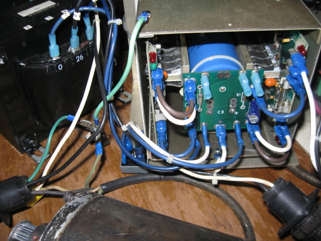

22 Jun 2016 16:33 - 22 Jun 2016 17:34 #76446
by new2linux
You are correct these pics may be better info.
At the bottom center is a small gray cable with rectangle red plug going in to the side of aluminum case, this is P3 and P4, on other side is same for "x" P1 and P2
Can just see red plug under white wire.
The light blue thing is the capacitor with the dead part on the right side, centered top to bottom; labeled R1 on circuit board
In the background you see the 7i77 card with plugs to encoders
Edit: There are 2 of them, the other is to the left of the one that blown, on the end of the blue capacitor.
Many thanks
Many thanks
Last edit: 22 Jun 2016 17:34 by new2linux.
22 Jun 2016 16:39 - 22 Jun 2016 16:40 #76447
The blown resistor looks like it might be intended to discharge the capacitor, ie it is a safety resistor. Does that look likely from inspecting the PCB?
Maybe not, you wouldn't need two of those.
