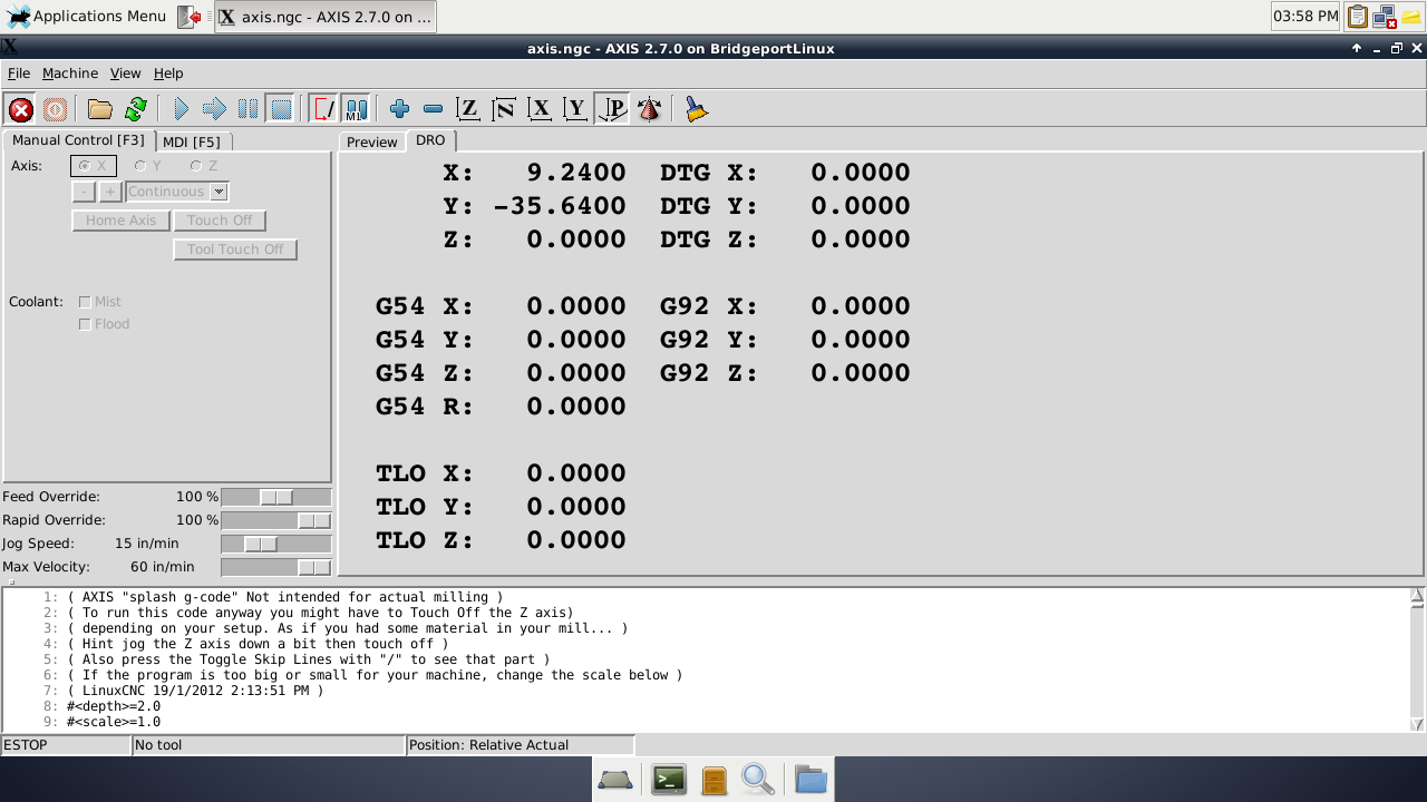

Andy, I have deleted the spindle area of the ini file. Attached are the files and current errors.

You are still calling a HAL fie somewhere called mitsub_vfd.hal which is trying to run a GS2 VFD.
Look: It says exactly that in the error message.

I think you will find the VFD HAL file called up in the postgui call list HAL file.

Andy, Thank You, For your thoughts. I have found the files in question, should I delete the "source mitsub_vfd.hal" and leave the only other file "source custom_postgui.hal" alone?
EDIT: I have just deleted the 1st line of code and asis.ngc is up!! many thanks!!
