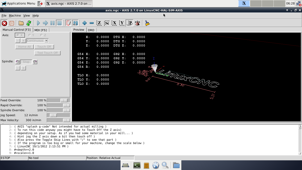

13 Jun 2016 14:46 - 13 Jun 2016 14:52 #75923
by new2linux
I started with a fresh download, used axis.ini as the config template to get to the screen you see in the attached screenshot. Am I correct to get the config file as close to the machine I have, prior to starting the final edited config file or do I edit this config file? I am thinking that I should get the DRO to read and a few other tests soon.
many thanks!
Replied by new2linux on topic retrofit Bridgeport Prototrak Plus
many thanks!

13 Jun 2016 15:34 - 13 Jun 2016 15:48 #75927
Replied by Todd Zuercher on topic retrofit Bridgeport Prototrak Plus
I'm not sure that it matters much. Just do what your most comfortable with and what you can make work. The first machine I set up I started with one of the sample stepper machine configs, copied all the files to a new folder, then modified and renamed some of the files. It worked fine.
I don't even think you have to move, make, or rename directories, if you don't want to. The config files for different configurations can happily live together in a single directory. But it is often simpler to keep them separated for human eyes.
There are example config files here for the Mesa cards you are using.
freeby.mesanet.com/7i77.zip
You could also try to generate a set of config files using the Pnconf Wizard. (A program used for automating the creation of configurations for Mesa Card machines.
Last edit: 13 Jun 2016 15:48 by Todd Zuercher.

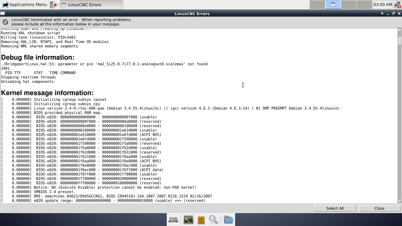

15 Jun 2016 11:16 #76055
by new2linux
This is the most recent error message I get. When I used the Pncconf Wizard I tried the mill option, and found no way around the request seeking the 3nd axes info, could not save and close any other way, so I used the lathe (seeking only 2 inputs made sense to me at the time) and seemed to finally allow a save and close. The DRO has not worked yet, but making head way.
many thanks!
many thanks!

15 Jun 2016 11:24 #76056
by BigJohnT
Replied by BigJohnT on topic retrofit Bridgeport Prototrak Plus
Much better than a screen shot is to copy the complete error message and place it between code tags (the button that looks like a page with <>) or attach a text file as the error could be anywhere.

15 Jun 2016 12:34 #76065
by new2linux
JT Having some small issues coping file as you suggest, please help me out, what program works best. It seems the file won't save, as for this forum to be able to upload.
- Todd Zuercher
- Posts: 4785
- Thank you received: 1476
15 Jun 2016 13:22 #76069
Just copy and paste the text by clicking on the select all button at the bottom of the window, then press Ctrl+c to copy to the clipboard (do not close the error window until after you paste the text or the clipboard info will be lost) Then open a text editor and press Ctrl+v to paste the text and save it, or paste it into your message on the forum like JT suggested.
