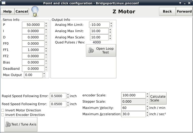

The screen to set the "z" as per Andy (Many thanks!) "keep the Z and set the f-error limits _really_ high" is this the area of the program I should be able to set in the "Servo Info" area?

Replied by andypugh on topic retrofit Bridgeport Prototrak Plus
I think that would be a manual edit of the INI file [AXIS_2] section.set the f-error limits _really_ high" is this the area of the program I should be able to set in the "Servo Info" area?

17 Jun 2016 14:00 #76220
by new2linux
This is the area Andy has talked about. Open this with Mousepad and edit to the preferred settings.
Replied by new2linux on topic retrofit Bridgeport Prototrak Plus

21 Jun 2016 13:02 - 21 Jun 2016 13:09 #76341
by new2linux
I have edited the ini file (specifically the "z" f-error limits 0 to 50; 1 to 100; and 0 to 50), I don't see any change. There was a comment about if I were editing the ini file of not. If I were to run the Pncconf Wizard it will over right changes to the ini file, I did not use that wizard, but edited va. the mousepad.
Edit: On the 7i77 card there are 3 amber lights on.
many thanks
