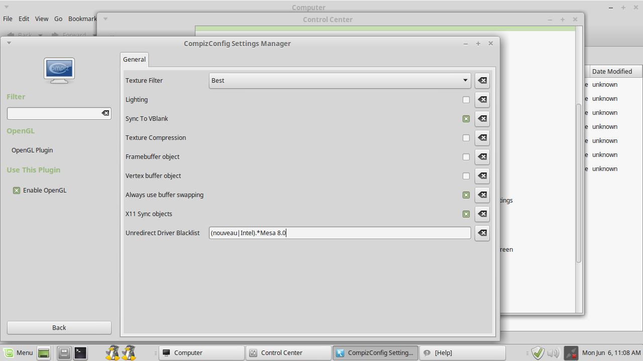

Resolution or quality won't have any effect. Try using a non-graphical GUI as a test.
In the INI file change DISPLAY = axis to DISPLAY = tklinuxcnc
This is an experiment, we are not suggesting that the solution is to use that GUI.
Replied by andypugh on topic retrofit Bridgeport Prototrak Plus
[attachment=7573]This is the screen shot of the OpenGL settings, I changed the top from Good to Best. Did not seem to matter.

06 Jun 2016 22:15 #75594
by new2linux
Replied by new2linux on topic retrofit Bridgeport Prototrak Plus
Andy, You are so correct, it took several moments to get this correct, but now the screen says (LinuxCNC-HAL-SIM-AXIS) has a blue back screen with X, Y, Z, almost centered in window. From you comment this is to tease out what the correct fix will be.
Andy, Many thanks!
Chris
Andy, Many thanks!
Chris
