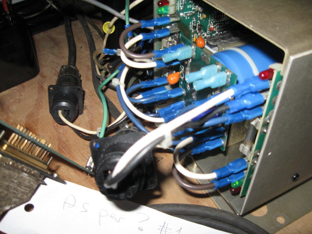

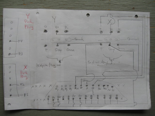

Just to confirm about the shield for the pins in the plug, there are 3 pins that go to ground on the male half of plug, in the mating half of plug it is ok to jumper 2 of the wires coming from the back into one socket with wire going to ground on the base of the card, where the card attaches to cabinet under a screw or is there a specific ground location.
The red plug is just laying there to show the wire positions, for the X (P1-P2) this is the TB5 PIN 3 and 4 locations on the 7i77 and on the Y (P3-P4) this is the TB5 PIN 7 and 8 locations are used.
Referencing the red plug, from an earlier comment that the black jumper pins may be used (as you can see I have a wire coming from each pin that was used in the old controller) as input as well, but what location on the 7i77?
many thanks!
many thanks!

24 May 2016 17:39 #75047
Yes they can and should be all connected together.
Are you asking where you should connect the wires that were the old jumper?
If so, first you need to figure out what exactly they are and do. When the jumper is disconnected does it in fact disable the amp, or does it do something else?
What kind of voltage did the jumper carry? AC, DC, which wire is +, which is -?
If they are an enable, and they are DC current, less than 100v and 50mA, you could connect the one for the X, positive wire to TB5 pin2 on the 7i77 and the negative wire to TB5 pin1.
Once you have a basic config, set up for Linuxcnc, the first thing you want to do is test the encoders. I'd suggest leaving the amps disconnected at this point. Once you have the encoders working (turning the motor moves the DRO in Linuxcnc). Then you are ready to try the amps. You could enable the amp and apply a small voltage with a battery (think AA or C battery), see if the motor turns. This might give a clue how you should connect the analog wires to the 7i77. Then you are ready to test the amp connected. Be prepared for a runaway (the odds of it happening is at least 50/50).

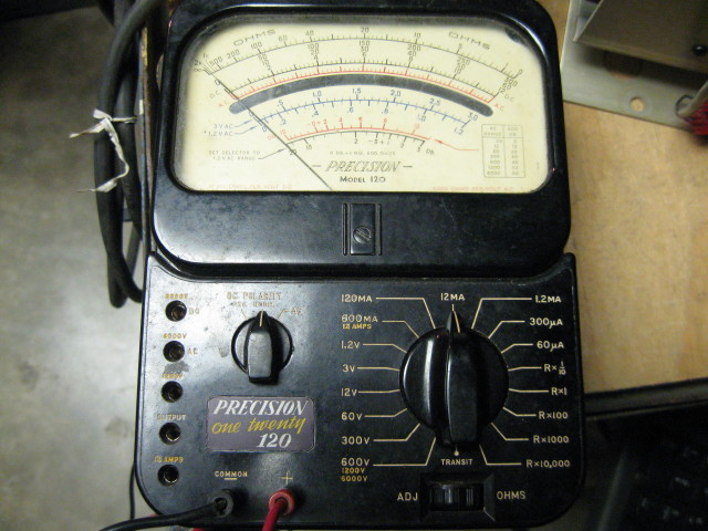

Todd many thanks for all your help.
As to respond to 1st & 2nd question, as the pic shows the lights are located on the edge of the enclosure and did not change during the testing.
3nd question: for those that did not know how to test for AC or DC look at your meter (if a professional grade equipment) and you will see a separate dedicated spot to connect one of the probes that will allow you to tease out with type of voltage you are dealing with, then use the appropriate scale for accurate voltage assessment as far as voltage values.
4th question: The needle was at the(180 OHMS) top scale on (12 MA setting at the multi-select)
(As you see the left side has AC spot DC spot when used on special 600 volt setting, at bottom)

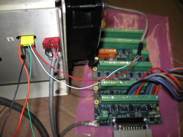

5th question: It is not real clear in some of the earlier pics, but if you were to trace the black wire (between the red and tan wires on the red plug that has the black jumper as well) it goes absolutely nowhere. If you apply low 1.5 v (single battery) the "x" drive it turns slow and apply 2 batteries goes quite a bit quicker.
The pic above is not my best work,as you see P1 AND P2; if you apply positive battery voltage to P1 it turns clockwise (looking at the face of motor); if you apply positive battery voltage to P2 it turns counter-clockwise (looking at the face of motor)
6th question: with the jumper removed there is no motion at all.
7th question: see question 5.
