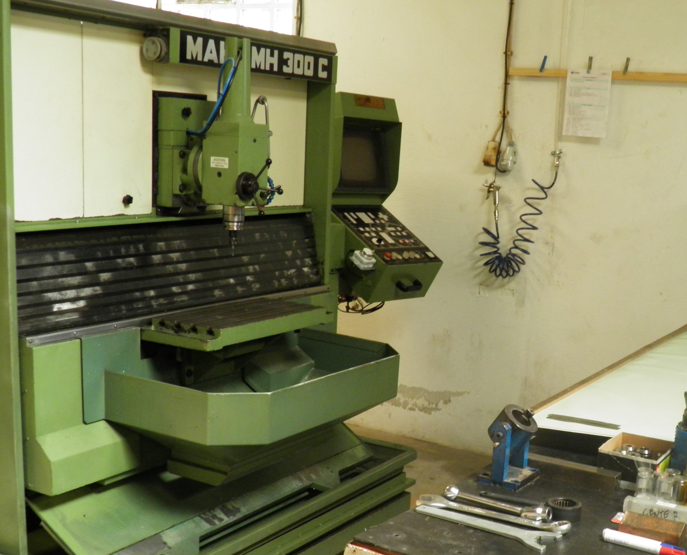

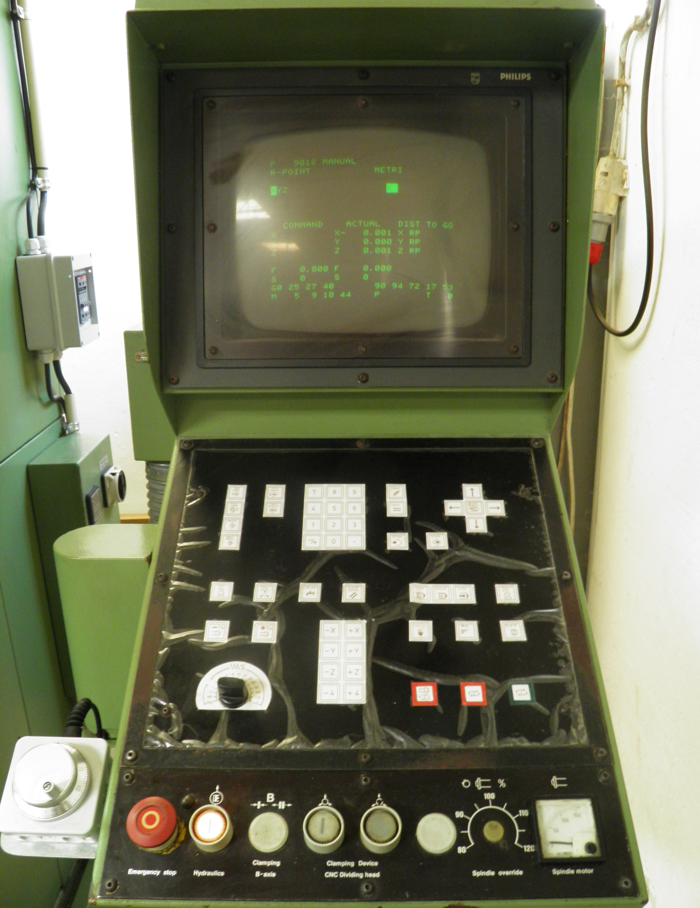

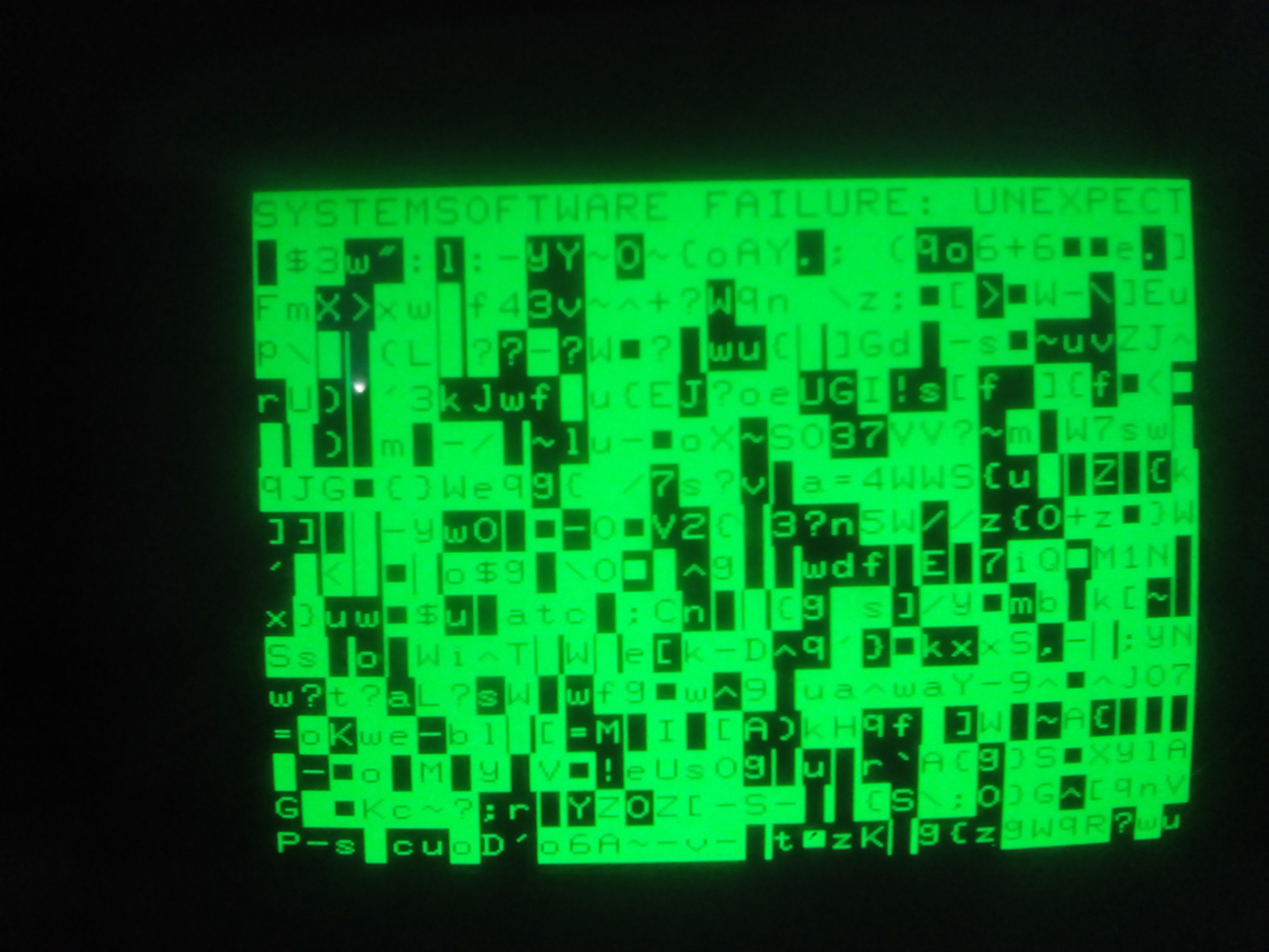

Hi!
I''m speaking here from Portugal. This is my first post in this forum.
I've been reading this topic just for the sake of it, but I have not read it all yet. The topic already has a lot of information, and I still have to translate it into Portuguese, ... I've been reading it a little everyday.
In this moment I just want to say that I also have too a Maho MH 300 C that I will have to do retrofit. At the beginning of last month it has broken down and all paths indicate that it will have been the CPU.
I'm thinking of doing is putting controller, servomotors and servodrives all new.
I have not started yet because besides the Maho I also have a Schaublin 32 CNC that I had bought shortly with some malfunctions, and at this moment the priority is focused on this one.
I leave some photos of the Maho that I have, one of which is the failure ...
I give strength, and continuation of great work.
Sorry, my english is a google

It might be Eprom's, I think so. I had the help of two technicians who at first suspected could be the power supply of the controller, but the measured voltages are all within the admissible values. I replace battery battery to eliminate possibilities but has remained the same...
I had a problem on monitor, and shortly before I tried to read the Hz to replace that monitor with an LCD. I was going to have to use a converter to convert the signal to VGA, I think that's the way it is said, and to do the reading, not knowing I ended up making a short circuit. At that point I lost part of the constants. I re-entered the ones that were missing or wrong and everything was ok again.
Then worked twice, about 4.5 hours and everything ok. The next day when I turned on the machine this error appeared and I was never able to do anything.
But I'm seeing this for the right side.
-In the monitor sometimes editing programs the letters were so diminished at the time that almost could not read what was written.
-At to date I have never been able to establish a connection between PC and Maho effectively, I had communication difficulties, ... I copied some lines and stopped transmitting.
-The machine does not run DNC completely, it does 2.5 ... ?(...)
The intervention I'm going to make ends up with some evolution / progress ...
