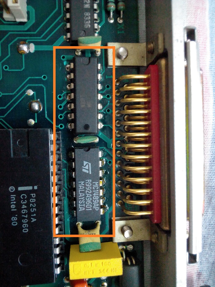

The controller that I intend to put in has no way to communicate with the existing servodrives, it has no analog output. It has analog output only for spindle control. That is why I have to replace everything.
What I have in view is not very sophisticated. The investment I intend to make is related to the machine and its dimensions.
Of all the times I tried to communicate with the pc the best I could was to copy a program that had a total of 18 lines. I know it has nothing to do with the capacity of the machine memory because at that time the memory was empty.
A technician advised me to replace the integrated circuits I send in this photo, possibly some of them would not be good. I replace the two circuits but the problem remained. In a diagnosis to the V24 appeared information saying "DTR / DSR Must be 1"
I tried the constants but nothing, I think there was something out of my reach there.
These integrated circuits had previously been replaced perhaps by the same problem.

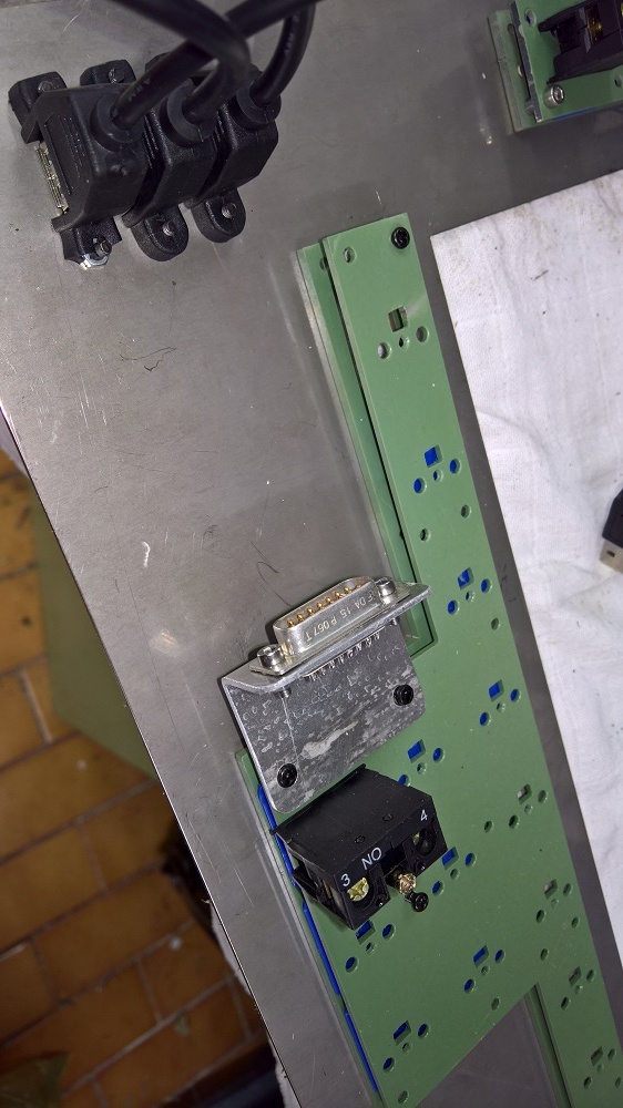

04 May 2018 20:06 #110218 by RotarySMP
I was away on a business trip most of the week, but found a few minute to make a bracket to mount the control panel buttons connector.
Mark
05 May 2018 18:39 #110260 by drimaropoylos
Mesa states for the 7i84 that it can handle relays, but it doesn’t state the same for the contacts on the 7i77. They have the same current and voltage capability but it is not clear that 7i77 will handle the overvoltage during the switch of on the coils. Can the diodes on the Maho relay board protect the 7i77? Or the 7i84 (or some buffer solid state relay board) is the only way?
Nice work on the panel Mark, are you going to use 7i73 for the matrix on the panel?
05 May 2018 18:47 #110261 by drimaropoylos
How the boutons feel? They have clicking feel or the long travel feel of the original boutons on the maho panel? Do the plastic bind on the metal during the press or on the release?
