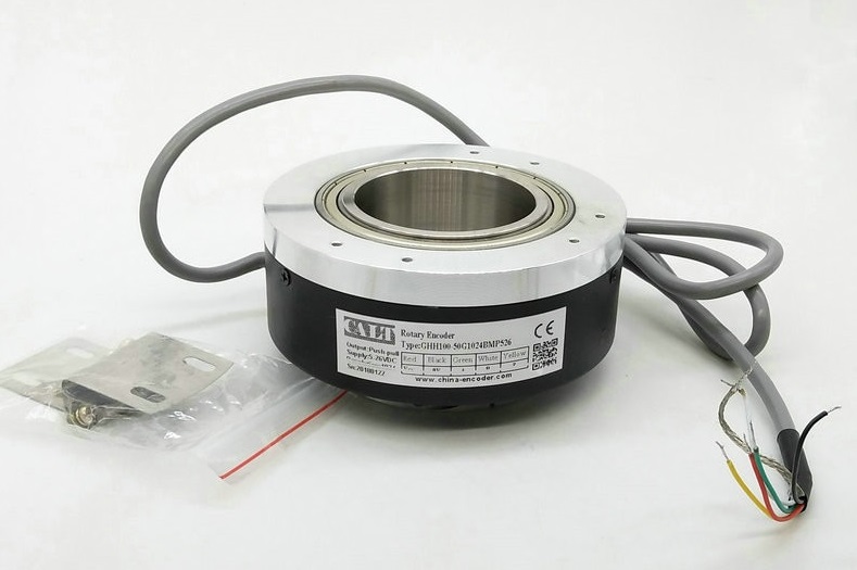

Hi John,
That encoder looks like a great solution (for my lathe project
), at least for shafts which are not within an oil bath, Strange they used -Z bearing shields instead of -2RS seals.
Where did you source it from?
Mark

- drimaropoylos
- Posts: 265
- Thank you received: 39
23 Oct 2018 06:50 - 23 Oct 2018 06:52 #119242
by drimaropoylos
They are very common encoder in elevators, so they are relative cheap.
www.aliexpress.com/item/Good-quality-GHH...5e-acf2-3d73ec1c44a1
.They can even customize the bore.

- RotarySMP
- Posts: 1500
- Thank you received: 558
23 Oct 2018 10:00 #119249
by RotarySMP
Thanks for the link. I should have guessed.

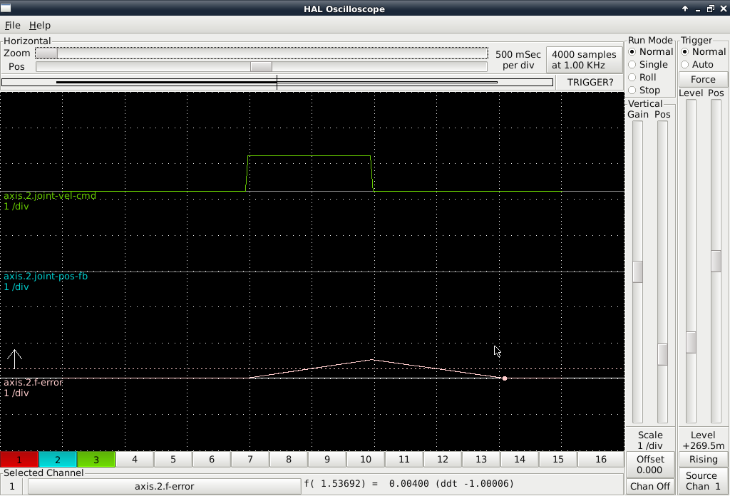

I got the EXE 602D wired up to the Z axis encoder. It is working fine with the output scale correct. I am having some trouble with the PID tuning, but will sleep on it.

26 Oct 2018 19:18 #119478
by RotarySMP
Dumb question, but how do I reverse a servo axis? Z is moving reversed. Going up when it should go down.
Running this slow (0.2 output scale) moves smoothly and moves the correct distance, up to 1mm when commanded, but the following error is moving out to 1mm, and then slowly returns once the axis stops.
Mark
Mark
- Posts: 19619
- Thank you received: 4524
26 Oct 2018 19:22 #119479
Change the sign on the encoder scale so that the counter counts in the right direction, and then _also_ swap the sign of the PWM (or analog) output scaling.
Replied by andypugh on topic Retrofitting a 1986 Maho MH400E
- RotarySMP
- Posts: 1500
26 Oct 2018 19:33 #119481
by RotarySMP
Thanks Andy, that makes the motion sense correct, but I still have the following error = distance moved. The encoder is working and the 1mm move stops after exactly 1mm,
