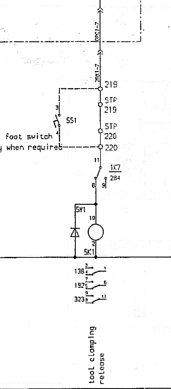

Hello and merry Christmas to everyone, Maho has put interlocks in 110 volt circuits and in 24 volt circuits so you can’t activate the hydraulic release wen the spindle turns and you can’t start the spindle wen the hydraulic pump has reliesed the tool. I think the best thing is to put a hard bouton in a convenient place and make an interlock in hal (and inform linuxcnc for the tool change) to send the signal to 5k1.
The best place for that hard bouton I think is this.
John
John

25 Dec 2018 16:41 #122877
by drimaropoylos
A single bouton to mesa card and you are good to go.
John
John

In second thought the foot switch directly as a tool clamp relies signal is dangerous.

25 Dec 2018 18:34 #122885
by RotarySMP
Hi John,
How is your MH600 coming along. I'd like to see some pictures of want you are currently working on.
I currently have the Tool release button on my user panel (it is on the button I made for mist cooling, but I haven't installed that yet.) I am going to move it to the pendant once that is designed and made.
Mark
