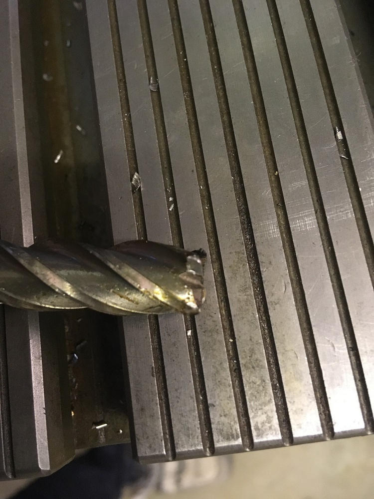

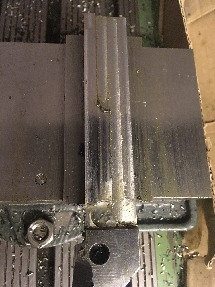

Yesterday, I made a new, much more conservative program to mill down the sandvik lathetool holder, using a brand new 10mm chinese HSS four flute. Use 2mm depth of cut, 50% engagement, 480rpm and 75mm/min feed. The first ~250mm went fine with nice chips, but then it died.
Although I did use cutting oil, itprobably need flood coolant to keep HSS cool enough to work in that steel. Oh well, another end mill for the hall of shame. Lucky I bought the Clarkson T&C grinder last year.

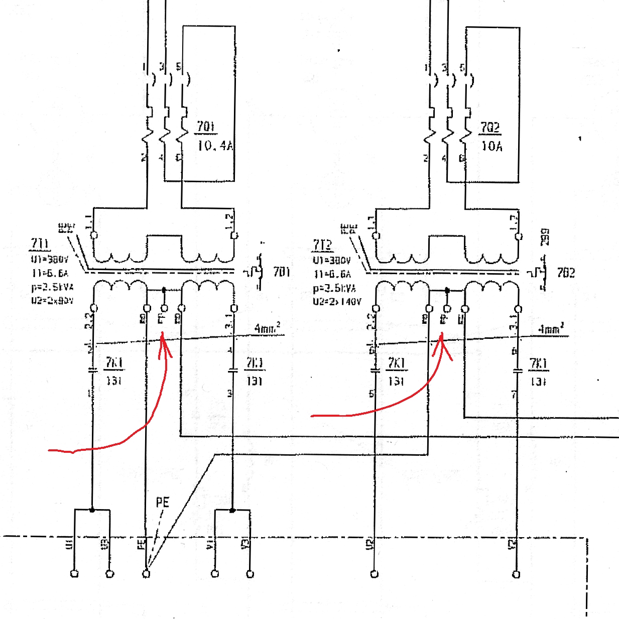

29 Nov 2018 09:40 #121583
by drimaropoylos
Can you take a close photo to transformers connections?

29 Nov 2018 09:56 #121586
by RotarySMP
Hi John,
Lucky my new bellows have not yet arrived, so I still have the guards off and can easily remove the cover and photograph the transformers. Will probably have to wait for the weekend though.
