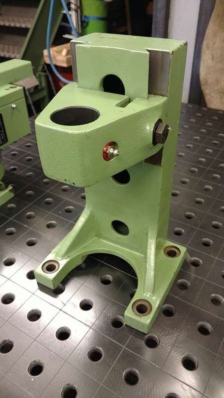

That is a nice set up with the Elta hi speed spindle on the adaptor plate. Good solution. You are pobably right that it is better to run a separate VFD and high speed spindle rather than having the the gearbox and a speeder running for long periods.

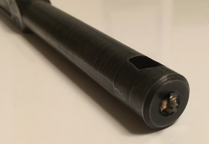

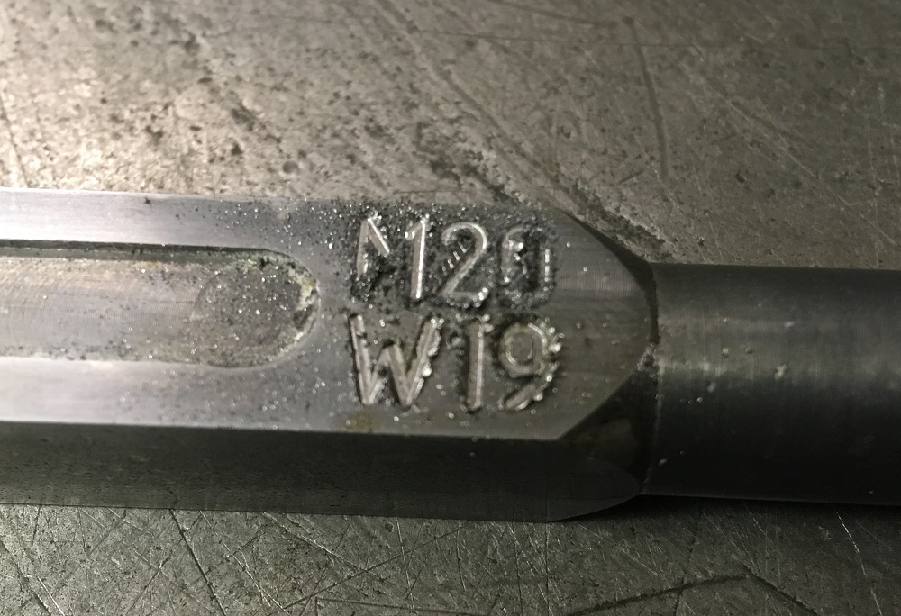

I finished machining that shaping tool holder by engraving six letters. This online widget is really easy to use:
www.microtechstelladata.com/TextToNCcode.aspx
At 4000rpm it took nearly a half hour, and left a lot of burrs. Still pretty cool that this can also be done at a pinch. Tomorrow if it stops sleeting/raining/snowing I'd like to crank up the furnace and case harden it.

As an other option, I made a high-speed vertical to mount on the horizontal arm. I think the Maho has a "high Y" axis so the solution shown is great, but with a "Low Y" my idea might be worth considering.

I case hardened the shaping tool holder for an hour. I also dug out the bottle of blueing fluid to make it look finished.
Afterwards, the screw was binding in the thread, so I thought i'd run a tap down it to clean it out.
Duh!!!!
So I had to chop off the end with the angle grinder and weld on an new tip. Turned it back and cut the new thread so now I just need to test it out. But it is not as pretty anymore.
Mark

Mark, it's possible to remove broken taps with a carbide ball end mill. I know because I've done it
But it will ruin your thread and in your case you'd have to mill it again in hardened steel with a special tool, so that idea wouldn't really help you there. One hard lesson I had to learn about tapping on the CNC mill is that there are two cycles you can use, one in which you input the feed and another in which the controller calculates the feed based on other parameters. The difference is that feed overrride won't work with the second cycle (at least on the Philips)! So I broke a tap because the feed override didn't work and the spindle didn't have the time to reach it's programmed speed before the machine jammed the tool in the hole. It was also a lesson that just because I can pause a program to check if the thread I made is fine, I really shouldn't.
Andy, your attachment is fantastic, I've seen it before and was very impressed with the work you did. The only inconvenience it has is that it must be very heavy, so switching between the two spindles probably requires that hoist hanging over your machine. Even though my spindle is small and the plates are aluminum, it's still a heavy assembly that I have to be careful about each time I take it on or off.

Good point about using a carbide ball end mill (not like I have one), but in this case the square was made by milling a slot and then welding on the end, so I just repeated that.
Andy, I really like how you make your machine parts and adaptors out of cast iron. As you say in your video, it's traditional. Since the MAHO overarm bolts to the same interface as the vertical spindle, and you have to take it off when it is not used, there would be nothing to gain mounting a high speed spindle to it, other than the prtential to increase the reach in Y direction, allowing engraving on larger panels.

I think that you could probably have got that broken tap out. Normally after breaking off the remains of the tap will break down smaller quite easily if you hit it with a punch from various angles. You have the advantage here that you can get to it from both sides.

Good point Andy. I think I have only ever broken one other tap over the years. Given how hard I have been on tooling since I got the MAHO running, I am sure I'll have another tap to extract in the future.
