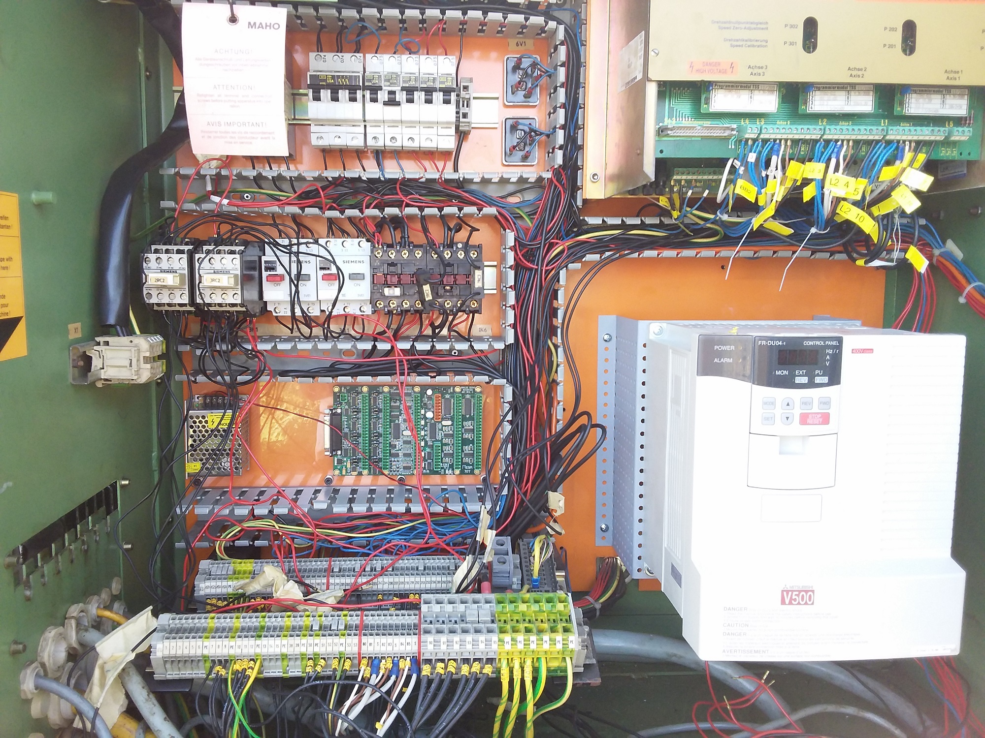

Hi, what do you guy’s thing, is it a good idea to put the vfd below the indramat. Or should I have to redo all the cabinet arrangement, rip off everything and wire everything from scratch with the idramat and vfd side by side.
The cooling unit is in the door in front of indramat and vfd
Last edit: 06 Dec 2018 09:55 by drimaropoylos.
06 Dec 2018 10:51 #121942 by andypugh
Replied by andypugh on topic Retrofitting a 1986 Maho MH400E
The VFD manual will have specifications for the minimum spacing above and below (The Indramat probably also has, but that might be harder to find)
I think that as long as you stick to the required spacing it should be OK.
Though side-by-side would look more conventional.
