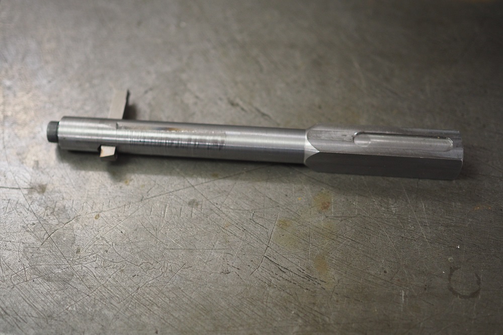

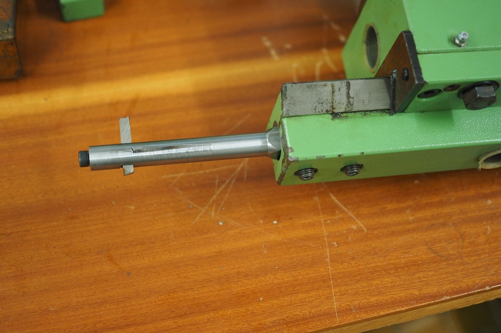

Yesterday, the result of procrastinating on the important stuff was to make the shaping tool holder. I haven't ground the tool bit yet.

Is there really a MAHO spindle speeder or are you just pulling my leg I ground up an engraver bit out of 3mm carbide and tried it yesterday, worked pretty well, but the 4000rpm limits you to a feed of 3mm/min.
Mark

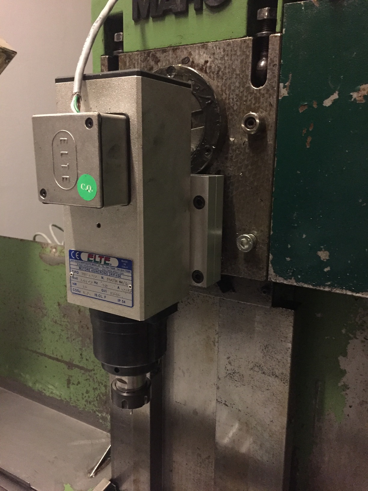

Mark, I don't know if they actually made it or if they simply resold someone else's products but the speeder is right there in my manual as an option. It was limited to 8000 rpm. I had a new one quoted from a company in Poland for ca. 1500€ (without VAT) that did 12000 rpms.
But since I'm cutting acrylic atm I went with a small 18000 spindle (1kW) with a matching inverter that I just bolt on to the horizontal sipndle face via two aluminum plates. That option cost me ca. 900€ and it was money well spent for what I do. It allows me to cut with the Maho's full speed of 1500 mm/min, which is still pathetic in acrylic but I didn't know I'd be doing this when I bought the machine. The plan was always to make molds.
Anyway, for longer programs or batch production, the smaller spindle is a better option because it doesn't cause problems if you run it all the time. A mechanical spindle speeder will overheat after a couple of hours from what I gather. For continuous work and no extra hassles, the premium options are air-powered or electric spindles that are already mounted in an SK40 tool holder, such as Jaeger or Air Turbine. But those cost almost as much as my machine did.
