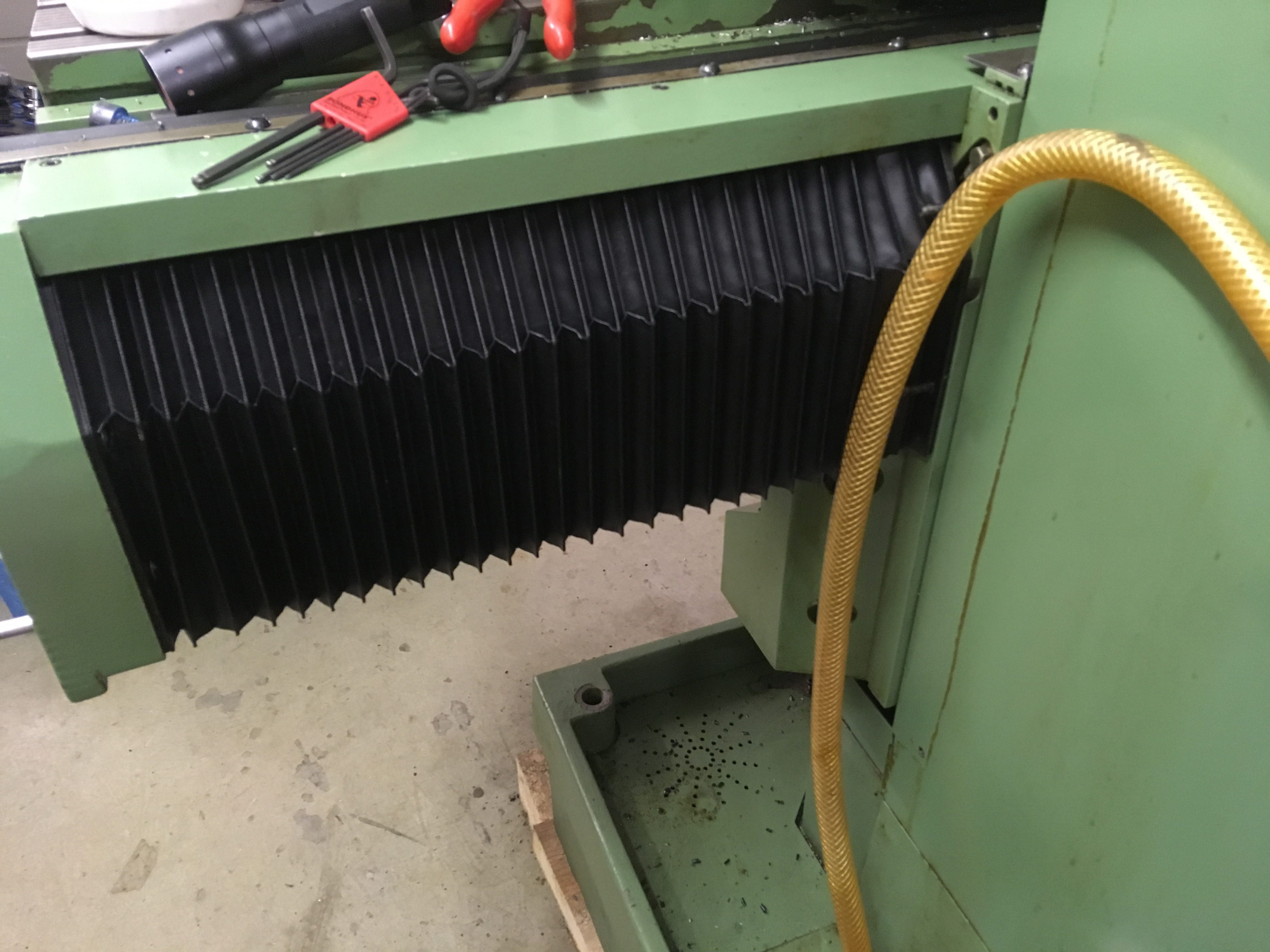

Merry Christmas to all. Hope you all had a nice family time yesterday or today, depending on tradition. I received a pair of AMF "Bulle" toes clamps, which are going to come in handy, along with a couple if other bits and pieces for the mill.
Thanks Bernd. I wanted to edit that into my HAL, but my chinese bellows arrived. I installed them (which is a real PITA) on the LH side, as the rear guard has to be installed at the same time, so you are working down in the gap between the transformers, and the guarding. This photo is from the RH side, and I had to take this back off a couple of times till I worked out the order of assembly of all the guards - the rear wall also gets sandwiched by the bellows mounts screws here.
But now all the guards are back on. Swarf tray and doors installed. The coolant which is in the machine is probably 20 years old and pretty gross, but I is working. I'll have to drain it and clean out the sludge and get some fresh coolant.
The replacement LH door which I bought from Ebay turned out to have the latch fittings 25mm away from mine (did MAHO ever make 2x the same thing?). Easy job to drill new holes for the lathe blocks and install them.
