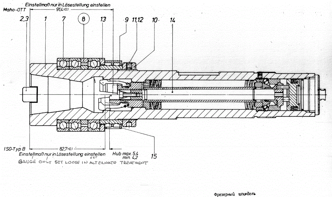

With the pruchase of my Maho I received the user manual and some Phillips 432 programming guide. When that slotting head came up for sale, I contacted DMG to ask if it fit my machine (it was advertised as a 400P accessory), and they sent me their part machining drawing of the adaptor flange so I could compare dimensions. I was suprised they would hand out such a drawing. It doesn't have the casting pattern information, but contains all the dimensional and tolerancing information.

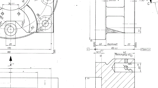

At some point I also got a near complete set of assembly drawings for the 400E from someone on the internet. As they have some Cryllic annotation on them, I am assuming that import requirements for some eastern states required a set of assembly drawings with delivery. Those drawings have no dimensions, and I do not have the associated parts lists to cross reference parts on drawings to actual MAHO part numbers.
I have not seen a parts catalog with exploded views from MAHO like in that Rockwell video.
The wiring diagram set from MAHO is really the only thing you need for a linuxCNC conversion. The first couple of pages lists the electrical components.

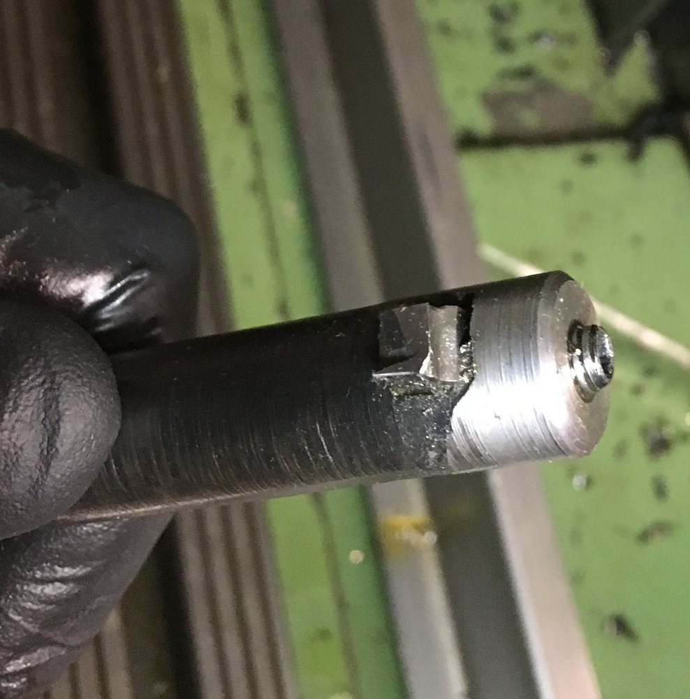

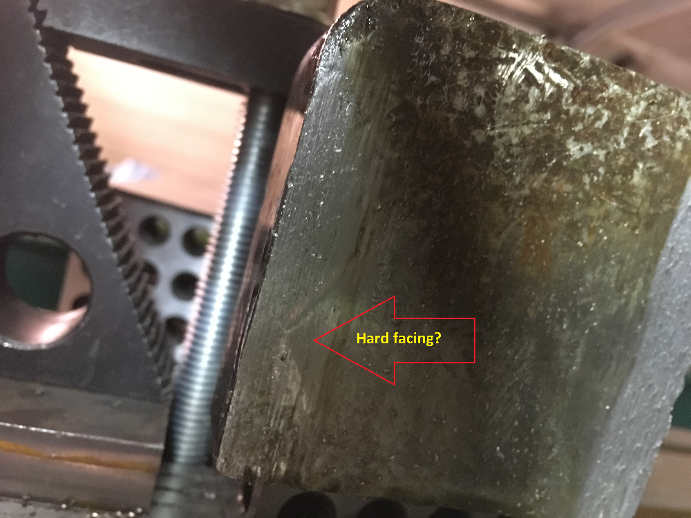

I had to give up on shaping that anvil with the slotting head. There is a hard area which just ground the edge straight off the HSS tool bit.
Next attempt will be the 100mm carbide insert face mill in the horizontal spindle.
