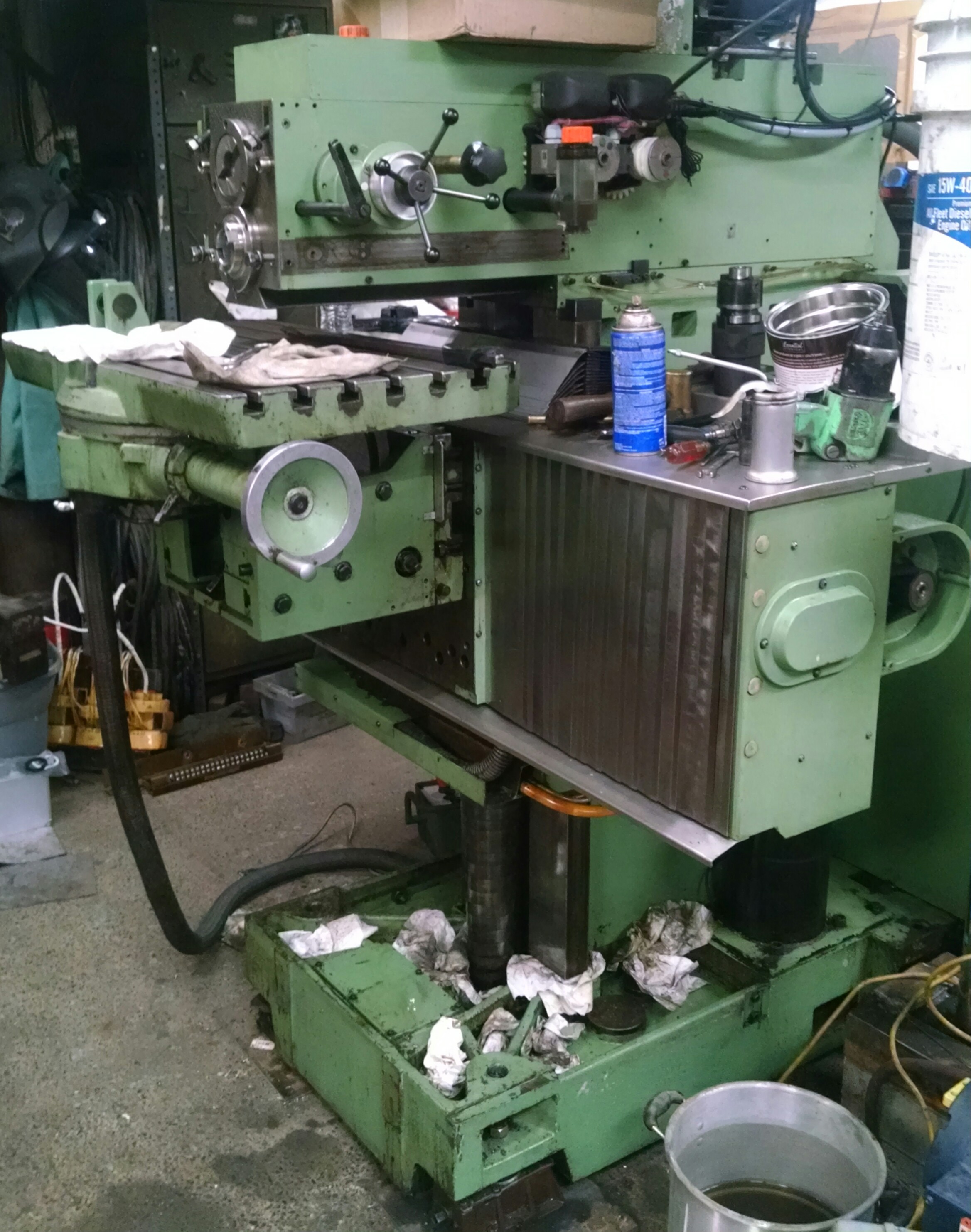

Hello! There is
photos of MH400T
. It's a full history of retrofitting
But it is not ended. I have a new trouble. Today i was adapted Hanmon's HAL to my hardware and try to test it without machine, only electronics. But, when LinuxCNC starts, estop button holds and i can't "power on" hardware anyway. I was created test configuration using Pncconf utility, and software normally starts on test config, and electronics answers to commands from software (i looking signals by oscilloscope). In my test config estop configured like this:
net estop-out => iocontrol.0.emc-enable-in
I was copied this strings to Hanmon's HAL, and commented his estop config strings. But it take no effect - estop holds and i can't doing anymore. How i can override estop and normally start software for debug purposes?
- hanmon
- Posts: 73
- Thank you received: 23
15 Feb 2019 17:14 #126572
by hanmon
Replied by hanmon on topic Retrofitting a 1986 Maho MH400E
your pictures are interesting.
The only difference I can see is the Heidenhain control.
The rest of the machine is 100% identical to my 400E.
Did you try to hold "Hydraulik" (Button) and in LinuxCNC "E-Stop "and then "Machine enable" ?
