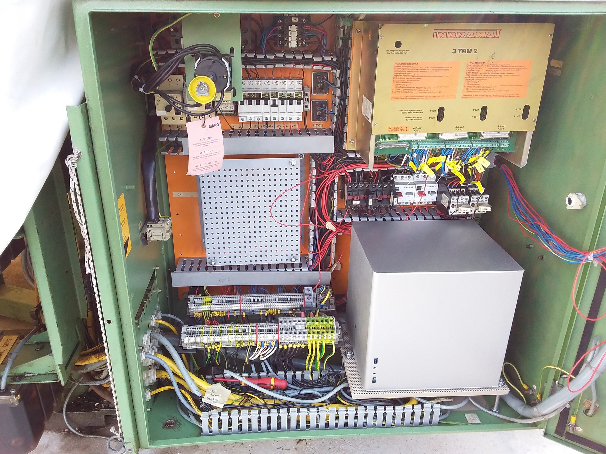

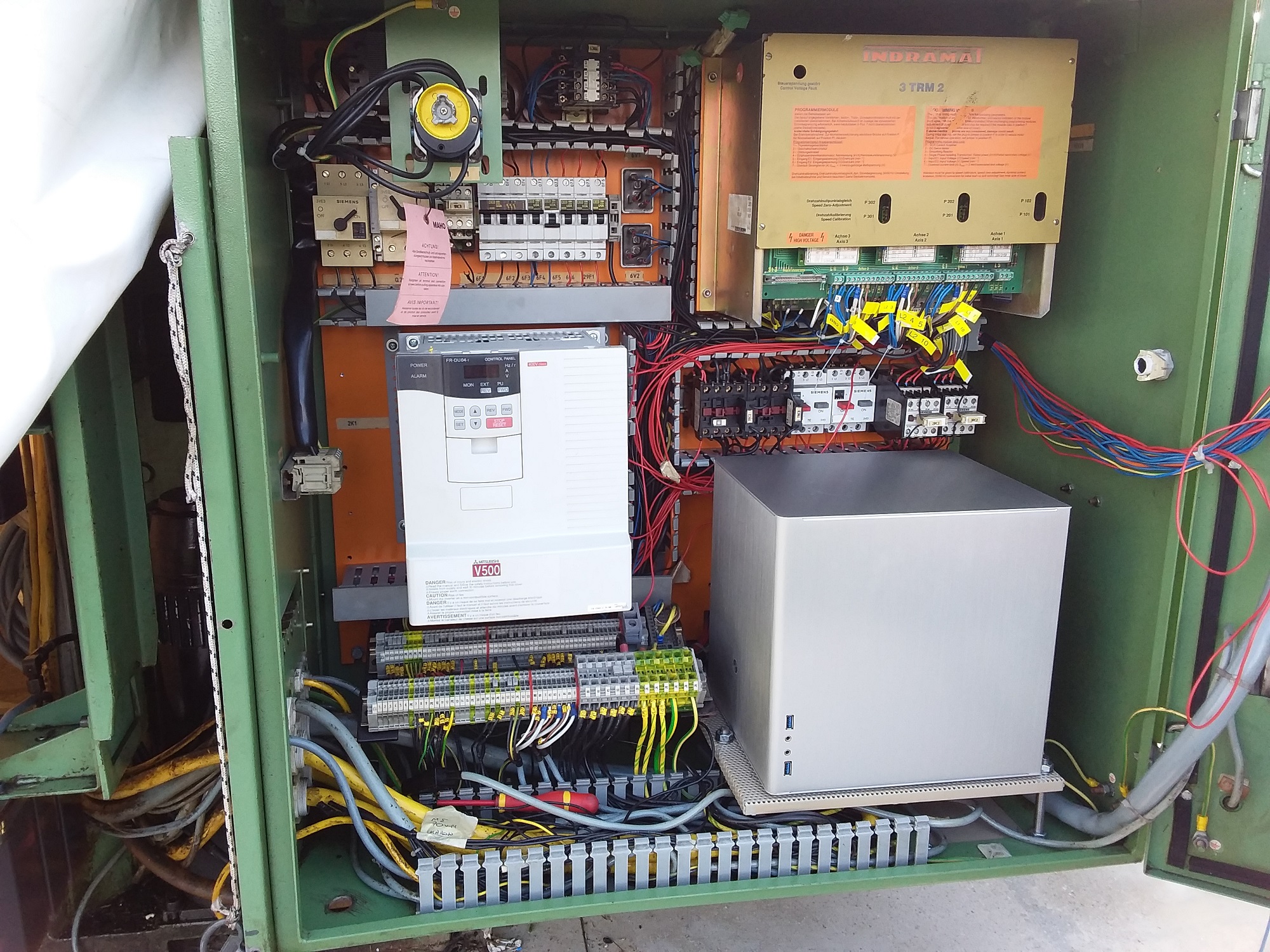

Hi to all, this is one way to fit a pc case and a VFD in the Maho cabinet.
www.google.com/search?q=Coolcube+Maxi&cl...igB&biw=1366&bih=654

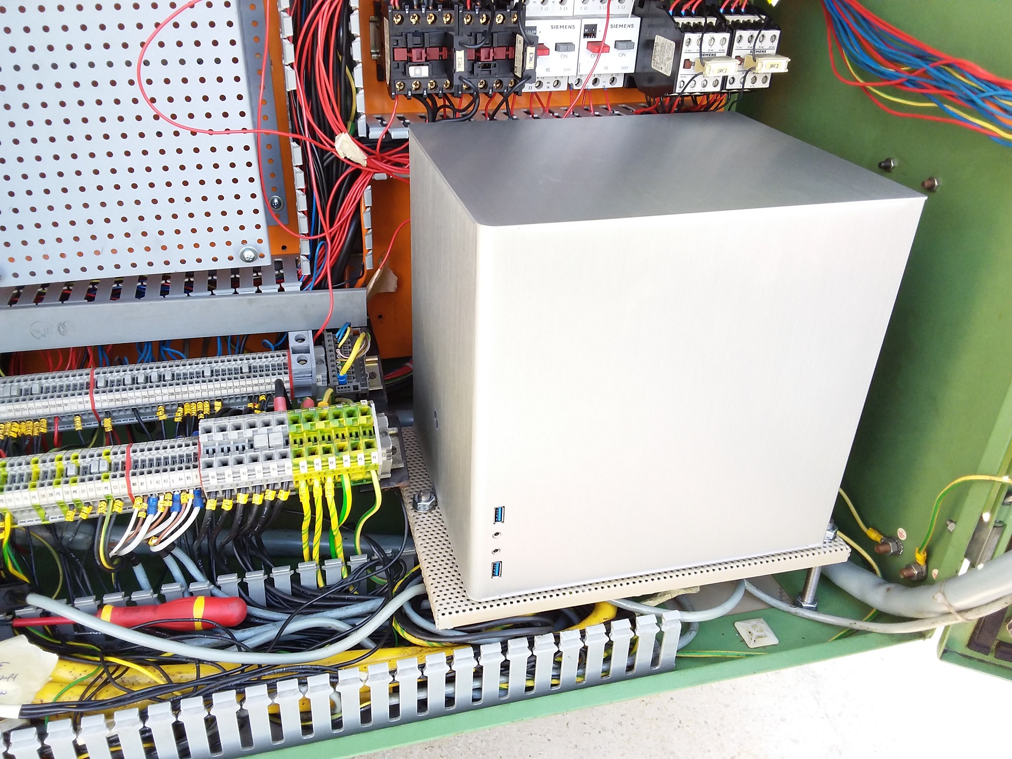

03 Mar 2019 19:34 #127626
by Glemigobles
Replied by Glemigobles on topic Retrofitting a 1986 Maho MH400E
Good job on rearranging all those components! That's a nice case as well, what type of motherboard does it take?

03 Mar 2019 20:01 #127627
by drimaropoylos
Micro atx

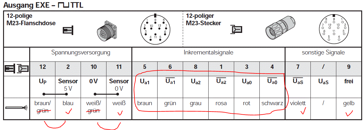

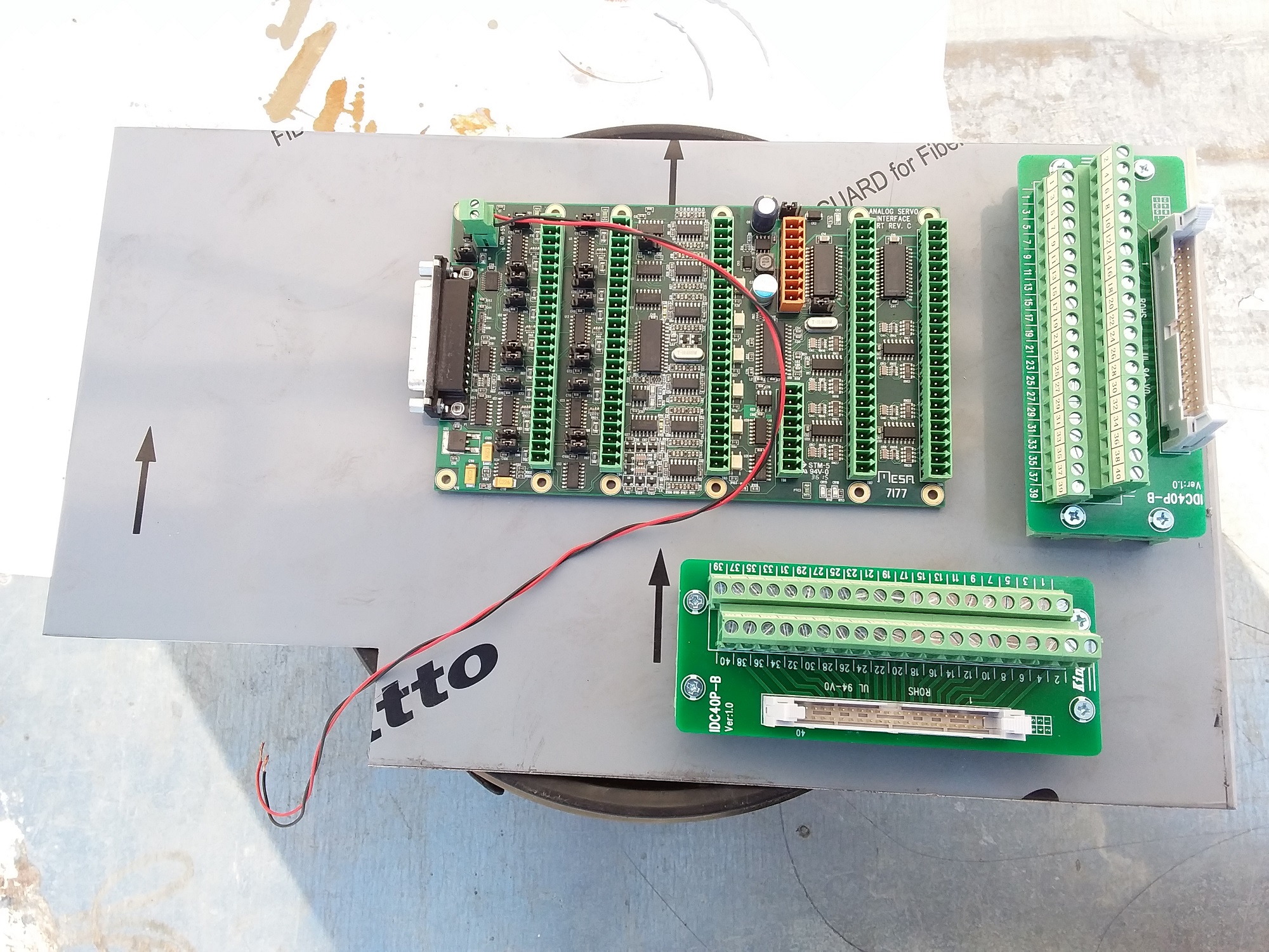

Yesterday I wired up the 602/1-F EXE I got off ebay into the Y axis. Turns out Heidenhains EXE's models seem to have the same wiring color codes on the six output signals. It was only the power supply wiring which was different on this one.
This one has been wired into the Mesa 7i77 with the differential signals like the 602D.
I could'nt find any info on this 602/1-F model on the internet, and it turns out the difference to the 602D model is the lack of 5x interpolation, so this drops the axis resolution from µm, to 5µm. I got it super cheap, so maybe I'll look for another 602D and replace it. Actually, since I am now only using one channel of the original MAHO EXE board, I might get two more 602D EXEs and and remove the large MAHO board completely.
So did it fix the axis drift problem? Yes it seems to. I ran my clover leaf test for an hour and it looked fine (not an accurate test). Then spent two hours thread milling our my lathe spindle nose protector. Since this involved picking up a nearly finished 40x3.5mm thread, I had to keep running the code, sneaking up on the size in 0.1mm steps. Any drift would have been apparent.
I'll never know whether the y axis drfit was an EMI interference issue solved by the use of differential signals, or a heat sensitive component on the old EXE board, but am pretty happy to have the Maho now moving reliably.

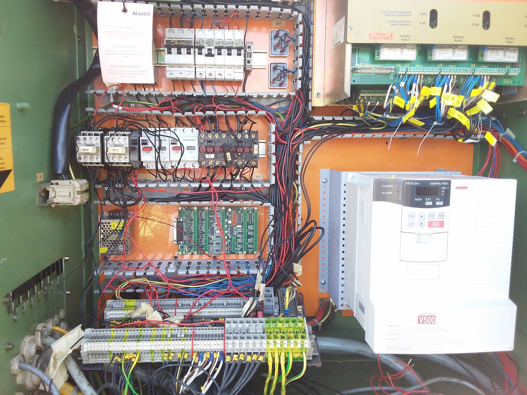

04 Mar 2019 14:07 #127696
by RotarySMP
Hi John,
Did you have to relocate that row of contactors which is now above the PC, or was it already there? It is looking very neat and tidy.

04 Mar 2019 21:57 #127735
by hanmon
Replied by hanmon on topic Retrofitting a 1986 Maho MH400E
Hi Mark,
the EXE-story seems to be neverending
John,
as you have the cooling unit in the cabinet door the location of the components (VFD, PC) should not make a big difference as it constantly circulates the air. Your second attempt looks really nice and well organized.

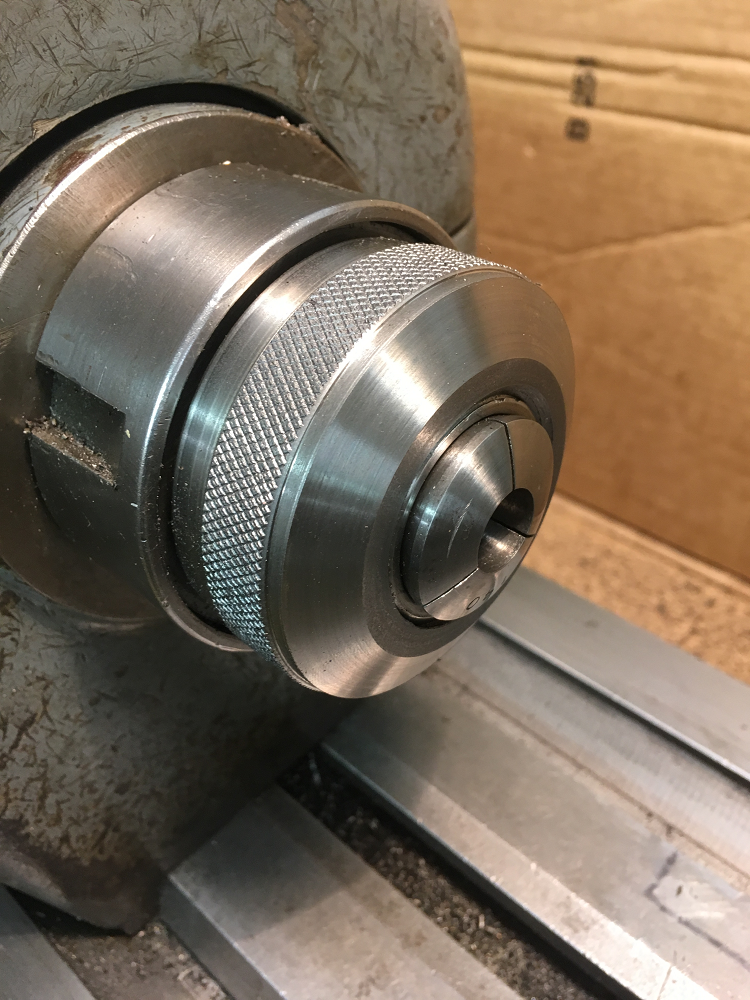

Hi Hanno, how is your retrofit progressing?

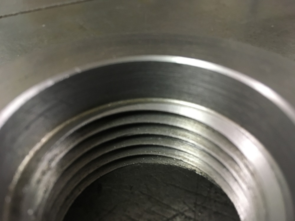

It doesn't really bother me that the current Y Axis EXE has only 5µm resolution. I am such a beginner at milling that this is not limiting. I am mostly pleased to have the motion stable and predictable.
This is the nose protector for the Boley 4LV, for use with collets. I made a few back plates for the Boley, and this was the test peice for the 40x3.5x55° nose thread. It rotated in the chuck before reaching full depth, so threadmilling on the MAHO was used to finish it.
Mark
