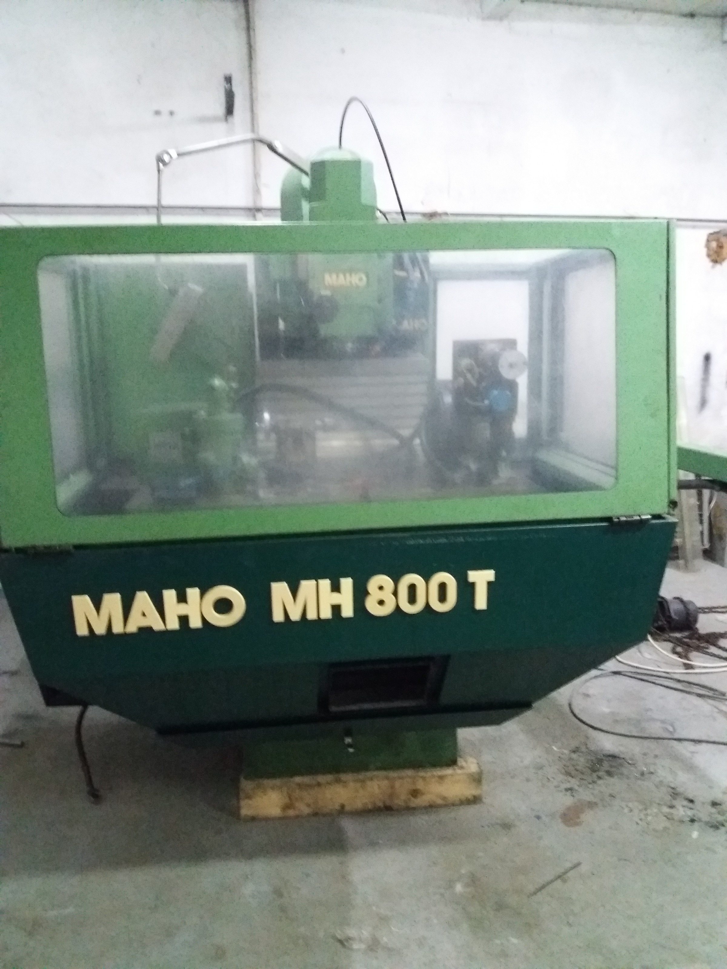

27 Feb 2019 21:00 #127293
by aluplastvz
Replied by aluplastvz on topic Retrofitting a 1986 Maho MH400E
Hi all for this forum
I bought this machine for starting with Linukcnc and Mesa cards, I hope that I will succeed because I have seen many good comments here.

01 Mar 2019 08:06 #127390
by RotarySMP
Hi, That looks like a real beast. Please post some pictures of the layout inside the control cabinet. What control does it currently have? Which linear encoders are fitted? Does it have a tool changer, pallet changer etc?
Does the current control work? Do you have the wiring schematics for it. You really need them to do a retrofit.
Mark
Mark
